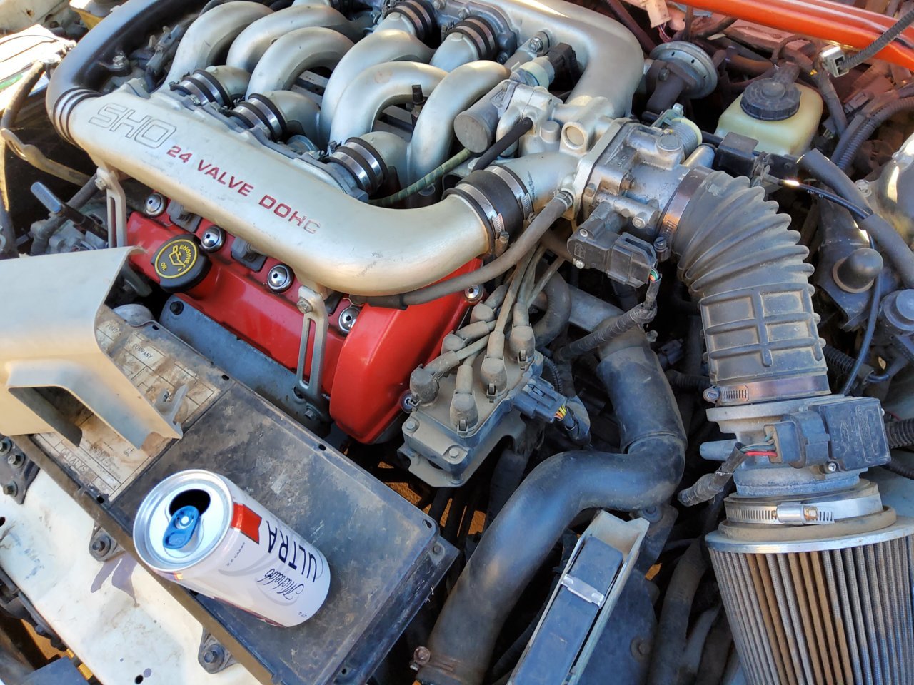

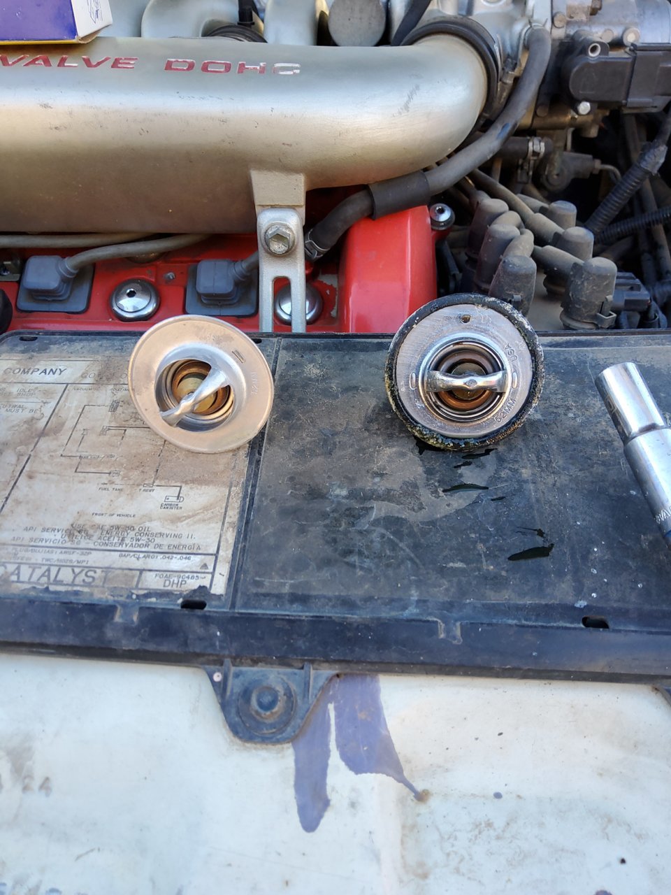

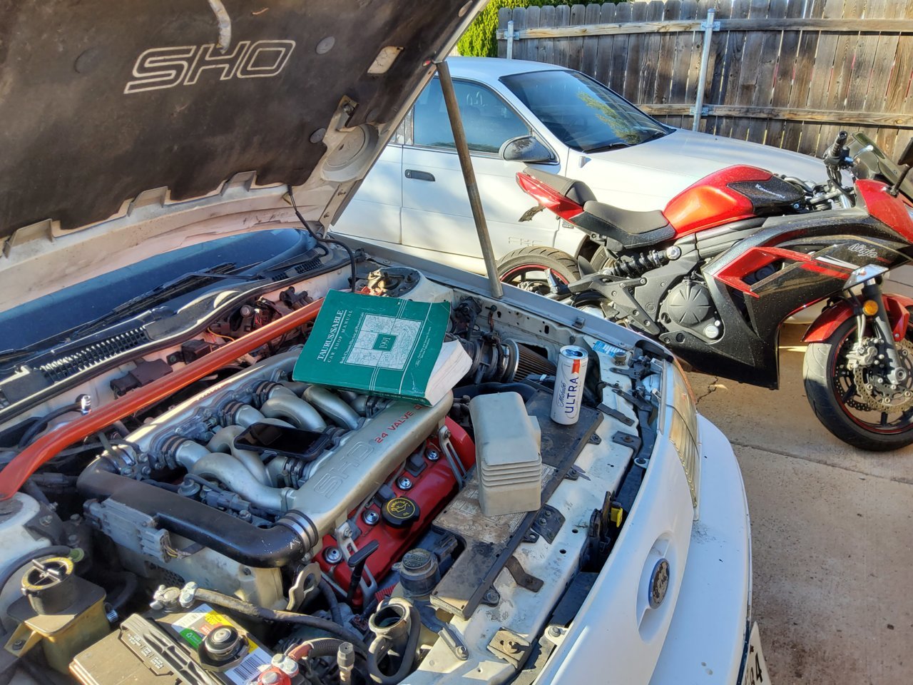

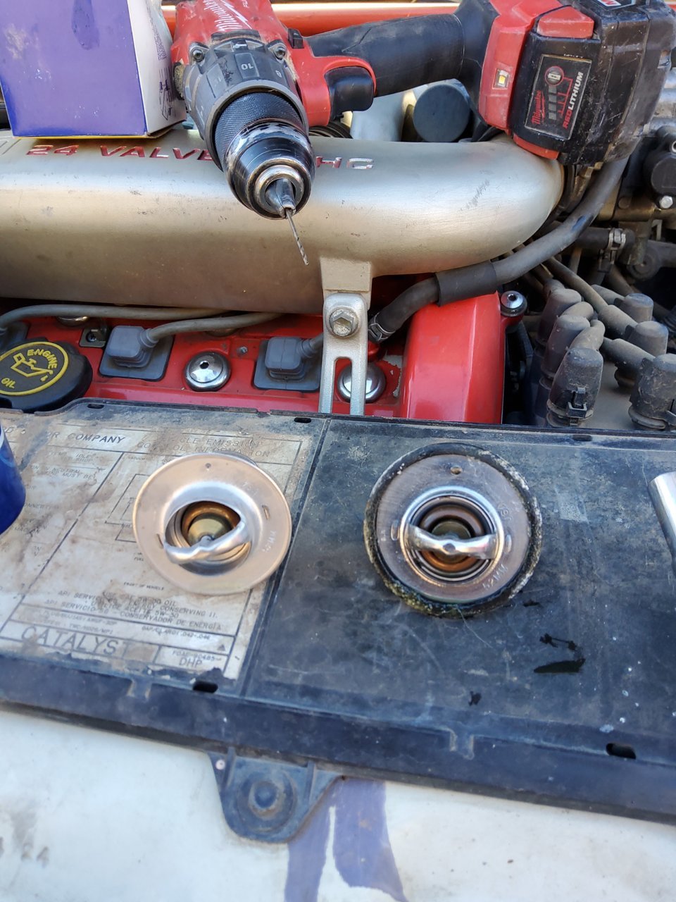

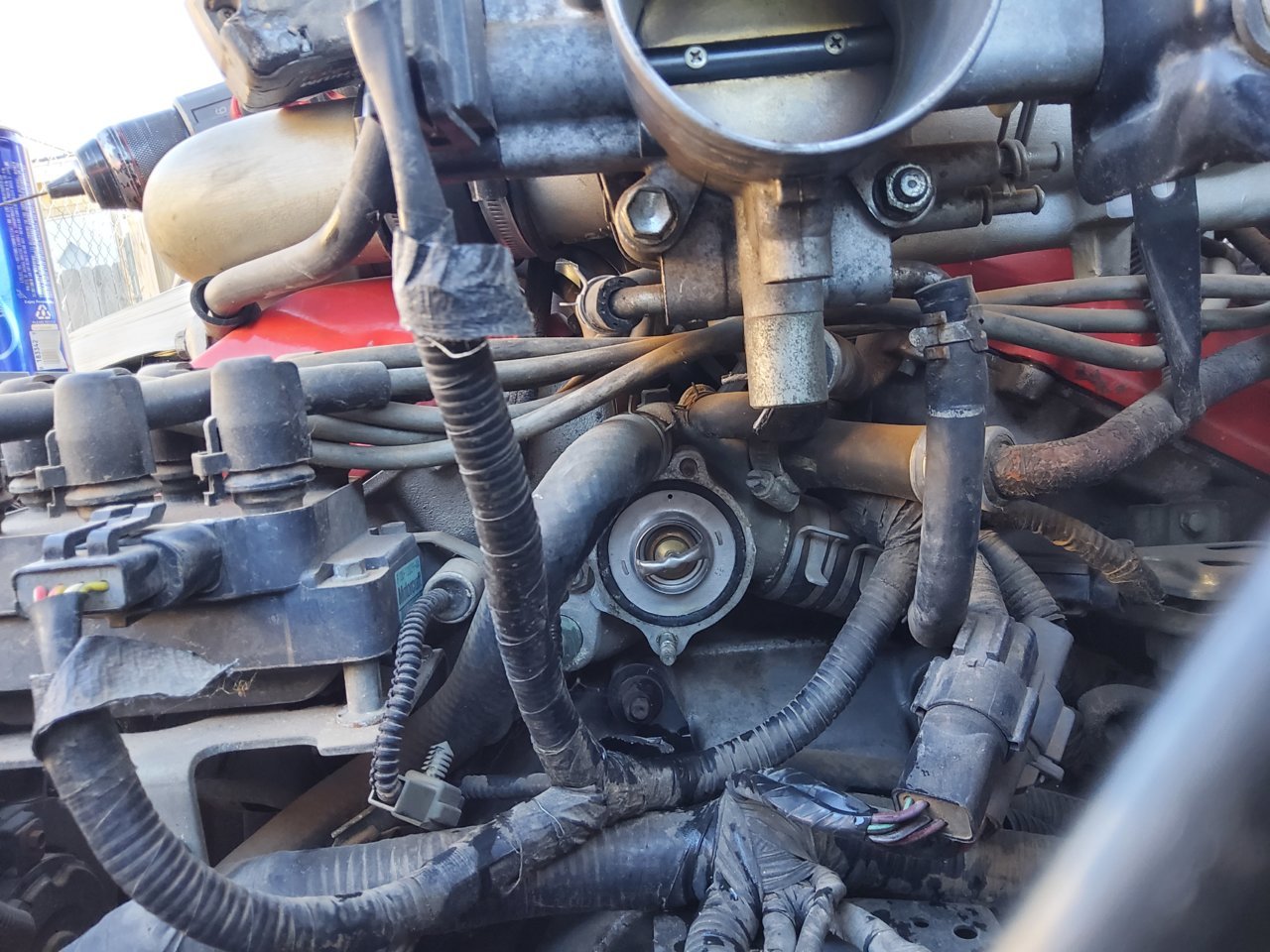

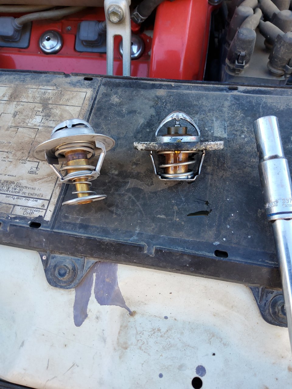

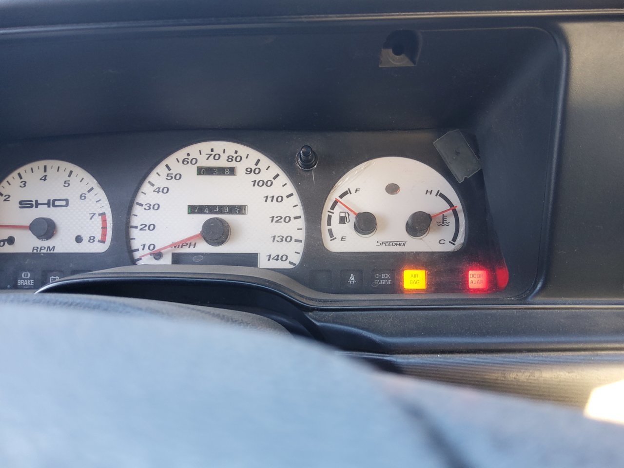

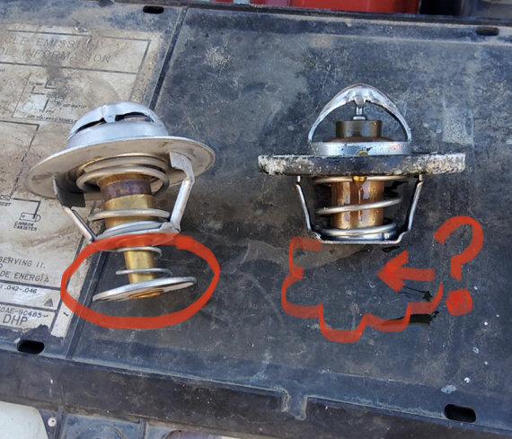

    I replaced the tstat in my SHO today, to kind of ease myself back into working on shit after the beating I took last year. It really wasn't as bad as I though; only a 1 beer job. Then I took another beer to "bleed" the system and got another 1/2 gallon in. My heater is working again, but the temp seems a tad high. It probably needs a new coolant temp sensor.
    Anyways, I took it around the highway a few times and it never over heated. Let it idle about 1/2 an hour and it did fine. Here's some pics for y'all:
    You see it back there?
    How bout now?
    Yeah, I'd say it's bad.
    New doesn't have a jiggle thingy,
    But it does now.
    New tstat in place
    Happy SHO is happy.
    All seems well, huh? In typical bmf fashion, I fucked up, bad. My keys (truck ignition, door, and fuel, house, gf house, and shed lock) were digging into me so I set them on the rad support by the battery. I even told myself not to do that, but I did. Now I can't find them. I walked my route out to the highway and drove it twice. Can't find em. I'll take the bike out and ride the shoulder tomorrow to look again. But you know me, I can't work on the simplest thing w/o fucking something up. Yay me!

    Hey buddy….. where’s the rest of your old thermostat? Cuz I don’t see it. You didn’t………. Nah. No way. I don’t even think thats possible, but idk. Might wanna locate that. Keys first. Then that.

    You and me, were on the same page. But what do I do?

    to be continued...
    No seriously, do you know what happened to the rest of the old tstat?

    Looks like just a different vrand so a different make. New one didn't have the jiggle valve.

    Pretty sure that missing part is what opens and closes the passage of water into the motor or not. The jiggle valve is not what’s missing. Look again at that pic.

    I agree that the piece that opens, and closes is missing. I'm saying that they are not identical t-stats. They are made by two different brands. So they are assembled differently. The new one didn't have a jiggle so he drilled a small hole for jiggle activities

    No clue. But when I pulled the old one out it dumped coolant out so I'm guessing it didn't break off.
