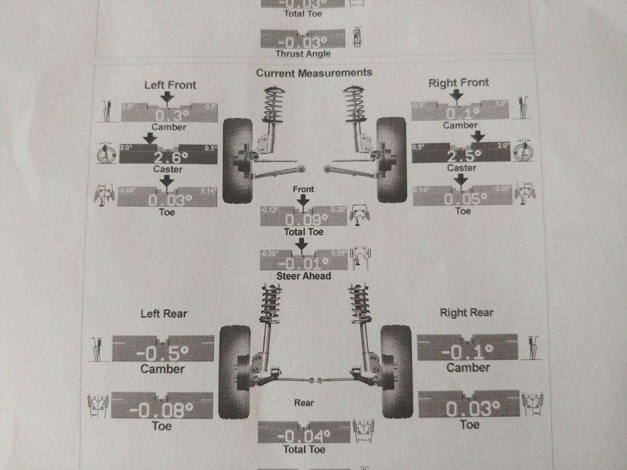

    Yes. But it takes less than 5 minutes to make an adjustment and then do a 'caster swing' to see if the changes made were effective. Once you've done it a couple times you should have an idea of how much movement is needed to get it close. I dunno, it's not really a big deal to me.
    But I've dealt with a lot of suspension. My old car had 3 points of camber adjustment and 2 points of caster adjustment. Lots of variables to play with.
    Our trucks cam style adjusters are pretty easy to work with. At least compared to the older shim style upper a-arm setups.

    Here are my #'s. They actually IMPROVED my rubbing. I couldn't hear any rubbing today after alignment. Still not sure why I had to fight them over it but I'm happy about that.

    Thats because higher caster on our suspension moves the tire forwards towards the bumper amd away from the footwell/pinch welds.

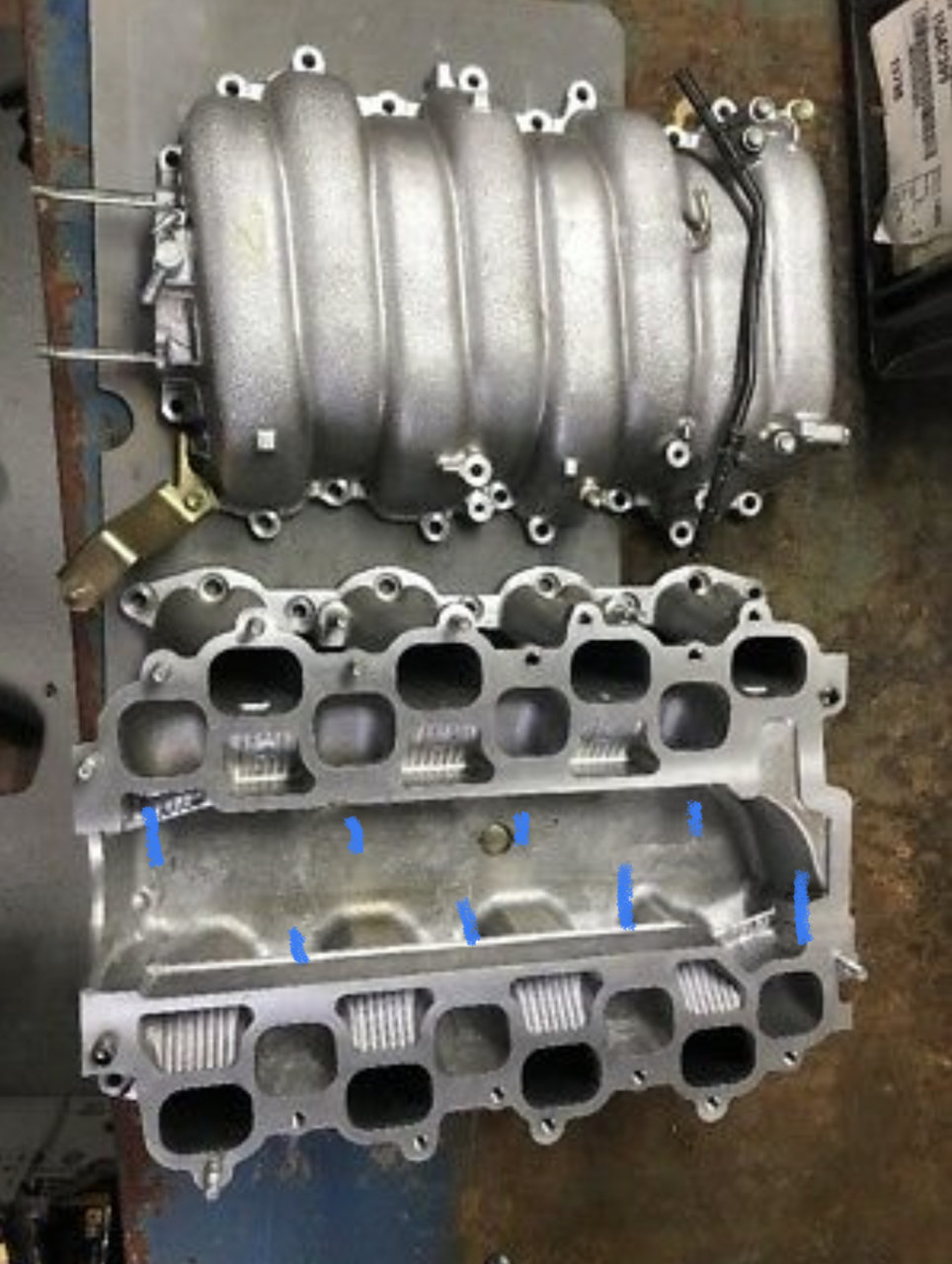

    I wanna make a half inch spacer between the 2 halves of the intake manifold. Maybe hog it out of a couple sheets of 1/4” aluminum, to spray water/meth into the center of the intake runner.
    Start heading up the continental divide, and fog to cool the intake flow and the manifold.
    Or a 30 shot of nitrous. Anyone think im barking up the wrong thought tree, and direct port injection closer to the valves would be better?
    i dont have expieriance with watermeth or n2o, but i can see benefits to both when sprayed above peak tq rpm.

    Better to do it before the throttle body IMO. Gives a little more chance for atomization in the case of the water meth injection.
    Unless you're going with 8 nozzles for NOS having a plate for it will lead to the center cylinders seeing more of it than the outer ones.

    Yea, 8 nozzles, closer to the beginning of the individual ports instead of the ends where the valves are. Id bet the manifold could be cooled several degrees.
    can ya’ll see the blue lines in the pic? Guess they should be arrows into the ports.

    I agree but my caster was higher last time and rubbed. They put it at 2.8 the first time. I'm guessing the suspension must have settled which is why it started rubbing.

    Perhaps you were rubbing on the bumper then? It would make sense to me.

    Anyone ever put the plastic manifold on a non-vvti motor? That would also 'help' if it would work.

    Yea, and supposedly the runner valve is vacuum operated instead of computer controlled.

    Thought of that too. Nitrous to add oxidizer and cool the tract, then fuel at the valve side.
    let the engine do its thing, but have a swich to just ‘make things better’ as long as the tanks have something in em. Some days water, some days whiskey.

    Negative. I rubbed the back fender liner.

    Maybe it has a bit more negative camber than before, do you have the old sheet/specs? This would push the wheel out further and give more clearance possibly.

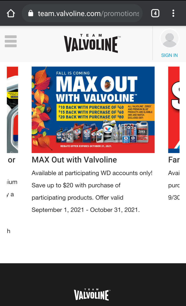

    Just saw Valvoline has a rebate going on.
    Might need to snag me some more Maxlife ATF.
