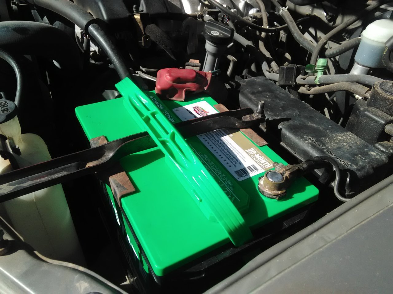

    I mean, OK but the battery I bought is 75 lbs. The sheet metal is not thick, I fully agree. However with a metal (not plastic) plate on the bottom to re-inforce and distribute load, is there a significant vulnerability over a 27 at 55-70 lbs? You honestly, seriously, legitimately think that < 20 extra pounds just pushes this whole thing over the edge?

    Depending on how hard you push the truck, yes actually. I’m not saying it’ll happen overnight, BUT it will eventually happen. Even with a 27f of these trucks are ridden hard enough cracking will happen (it’s an issue on all Toyota trucks, the battery supports are all very similar). Ultimately how hard do you plan on pushing the truck offroad? A metal tray doesn’t do much for supporting the apron.
    The damage you’ll likely find will be around the radiator support.

    Radiator won’t hurt because of how it’s supported. The battery just lends to be an issue because it’s supported on one side. Then hanging over the other. If off-roading isnt a big goal (especially driving lots of washboard like terrains) then go for it.

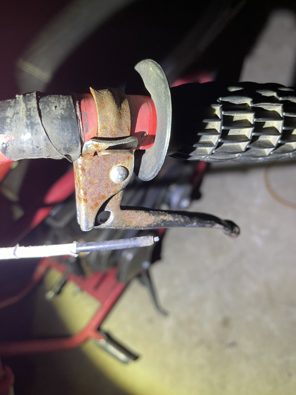

    He might be allowed in truck gang. I like that headlight retrofit he did and the subtle steel your face on the hood. That better be the 5 speed 4wd like mine.

    But that brake lever is older than me and I’m pushing 50. I don’t call myself Bikeric for nothing. If you need an Old Stock replacement I got you!!
    https://i.imgur.com/ruTn6IE.jpg
