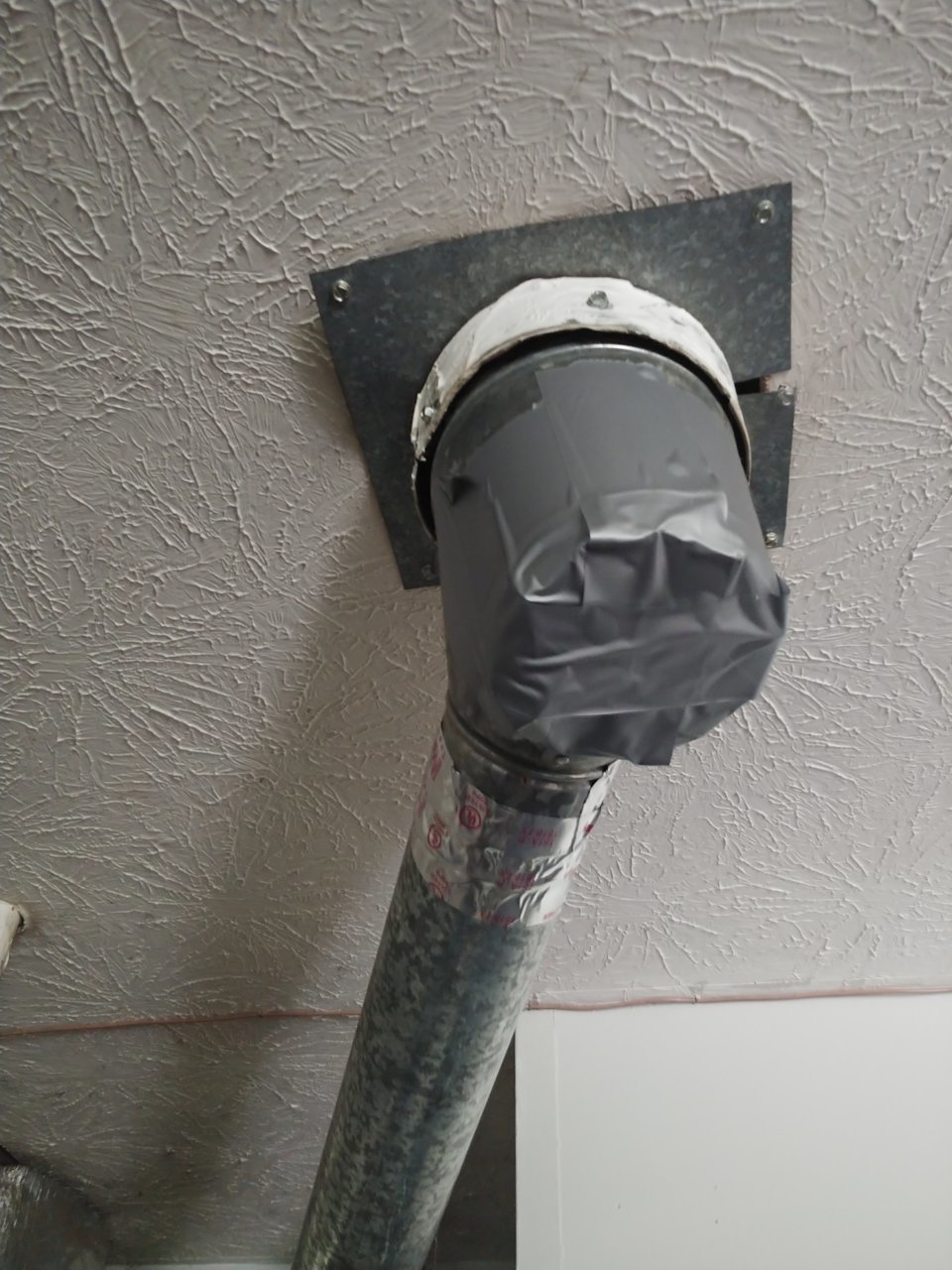

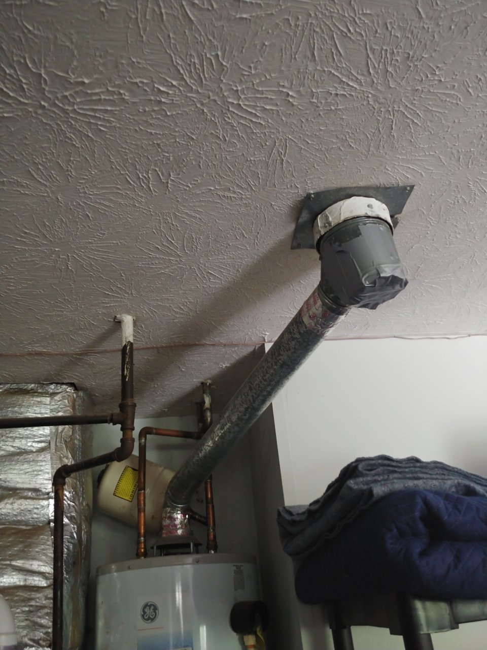

    @Darkness

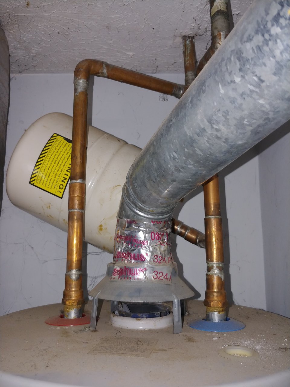

    In the first picture, that duct tape is covering a hole. It's open there because the venting for the previous HVAC used the same vent as the water heater. So that should be replaced IMO. Also, all 3 companies have said the angle for the vent is no longer at code. Supposed to vent straight up..?

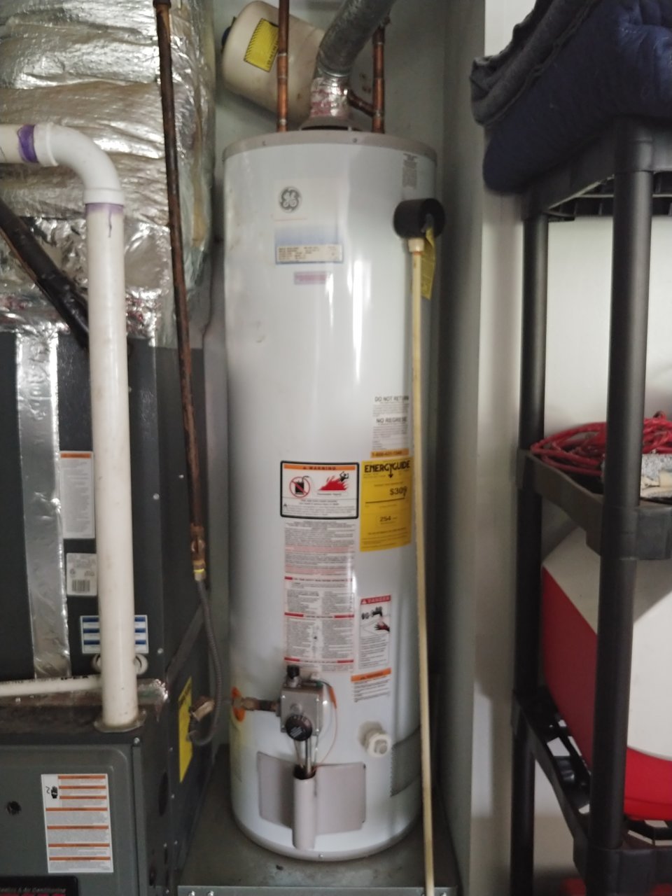

    Whats the crooked upside down tank? I dont thing ive ever seen that before. Pressure booster?

    Water expands when heated, and it’s good to have somewhere for it to expand to; it’s called a expansion tank.

    @FirstGenVol the vent doesn't have to run straight up for that heater but it definitely should have an elbow rather than a makeshift T fitting there. The only part that isn't DIY friendly is your copper pipes are hard lined to your heater, so it has to be cut out and sweat together again. In California we have supply lines (flexible hose like a giant ss brake line) that make it easier on DIY.
    Sweating copper isn't hard, but getting all the water out of the lines to sweat copper can be a pain. Seeing those things, it might not be a bad idea to hire this one.

    Oh now I see why you were saying I should install it. I've done many faucets over the years with those style hoses. If that were the case I'd feel comfortable hooking up the lines. I'm not about to try and sweat copper.

    @FirstGenVol you could add some supply lines. I know a lot of folks are leery about Sharkbite fittings but I've also never first hand heard of one failing. You would need to relocate the expansion tank though.
    https://www.homedepot.com/p/SharkBi...tegrated-Ball-Valve-u3088flex18bvlf/202685676
    Add in a new 90 and what looks like a reducer for the vent and you'd be set.

    Ok, ive got an expansion tank, but its under my sink, and has an air bladder in it. I never knew what it was called, but it helps push water through my RO filters.

    How does the end of that attach up top? There are no threads.
    Space is already really tight there. Where would you put it?

    That is basically a booster to support high usage, it stores extra water, when more water is being used than what it can produce
    I don’t have one in my house……

    Shark bite fittings just click into place. Really, you push it on and it clicks, thats it. I've always been weary of them but haven't heard of them failing either.
    The expansion tank you could probably move up if you got creative and loop the supply line.

    An expansion tank is only necessary if you have a closed loop plumbing system. When the water in the tank heats up, it expands. If there's a check valve on the supply line that keeps water from going back into the main supply from your house (sometimes separate, sometimes in the water meter) the extra pressure can damage the lines and fixtures in your house.

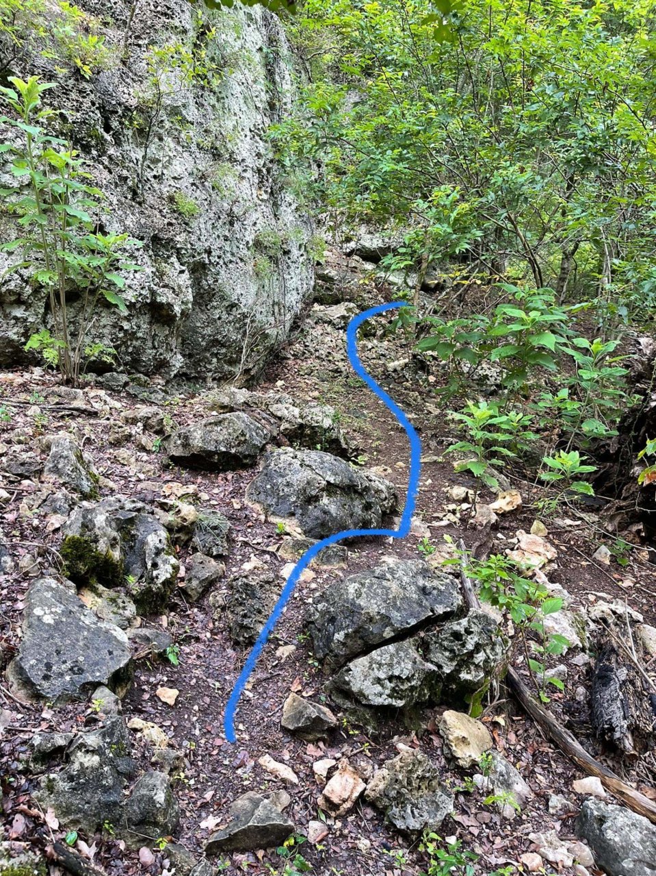

    Teaser for my walking trail. Ignore the blue lines. I had to submit a plan, but that plan isnt set in stone.
