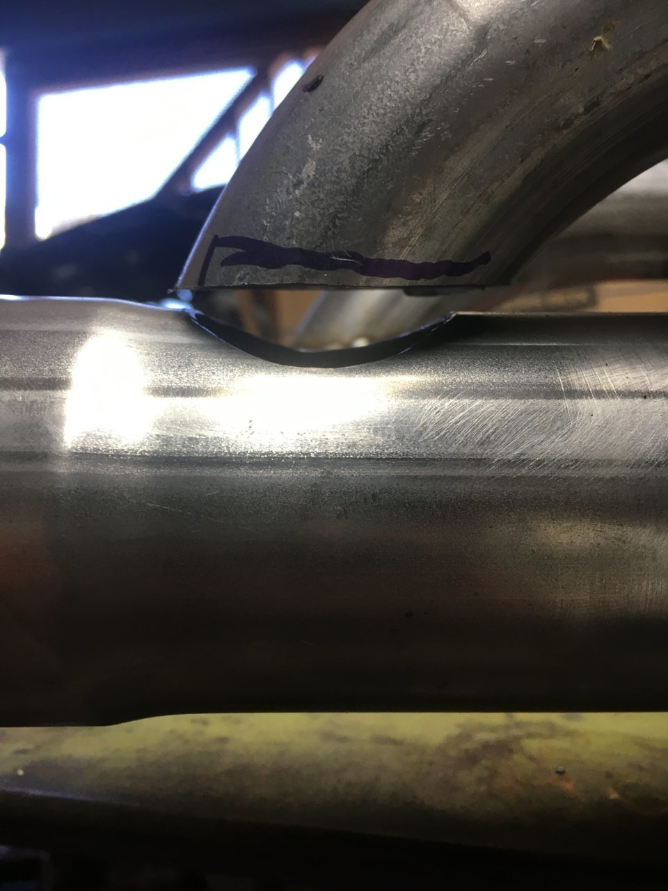

    It’s not a mandrel bender, I used this for the 4runner sliders, it puts a strange indentation in the corner of the bend, but yes it’s super nice having this around or access too! It’s all about those life connections, pops was there today; I had to shoe him away, ok I got it, ok yeah I understand, ok cool I think I can handle it!

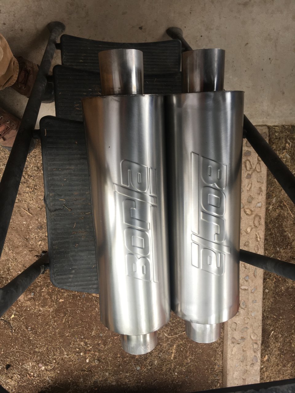

    Yeah muffs were on a weird national back order; no one had them, definitely drop shipped for sure. Only thing waiting to arrive is o2 extension harness(Monday arrival)
    Should start or look like starting on weds(I’m Irish, we will see how that goes)

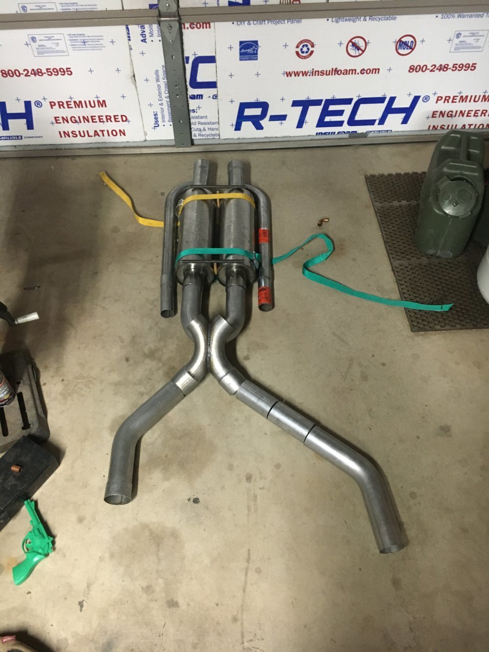

    No mandrel, but better than a poke in the eye with a sharp stick. Even with the wrong die for 2.5” I made it work. 1.75” for the heimenholtsenstien resonator thingy, worked great, maybe 2-3 times with a lil twist and it was good to slip and weld.
    I ordered all mandrel bent stuff online, no bells. Tomorrow I will get my 45s measured and cut for bells off of the X pipe(I wanted to get the spacing nice and tight, so I needed it all to be here to get the 45s cut short enough to bring it all closer)

    If I can I will weld the two mufflers together using fancy wooden dowel cut with a key hole saw to space them apart, then the extensions on the heimholzts resonators, then weld the exit pipes from the exhaust, then bore those to accept the resonators/weld, then get the x pipe and entrance muffler tubes set.
    Once I get the muffler tacked with the spacing to hold them it should go quicker and easier than stupid wooden dowels and straps!

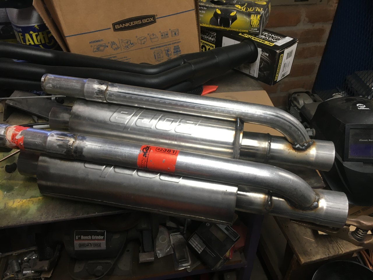

    Lunch update; beer count:zero(I know wtf!?)
    If everything welds as nice as the muffler to the straight pieces, the rest should be somewhat simple. Lots of popping on the 1.75” resonators. Forgot my metal stretcher at work:(
