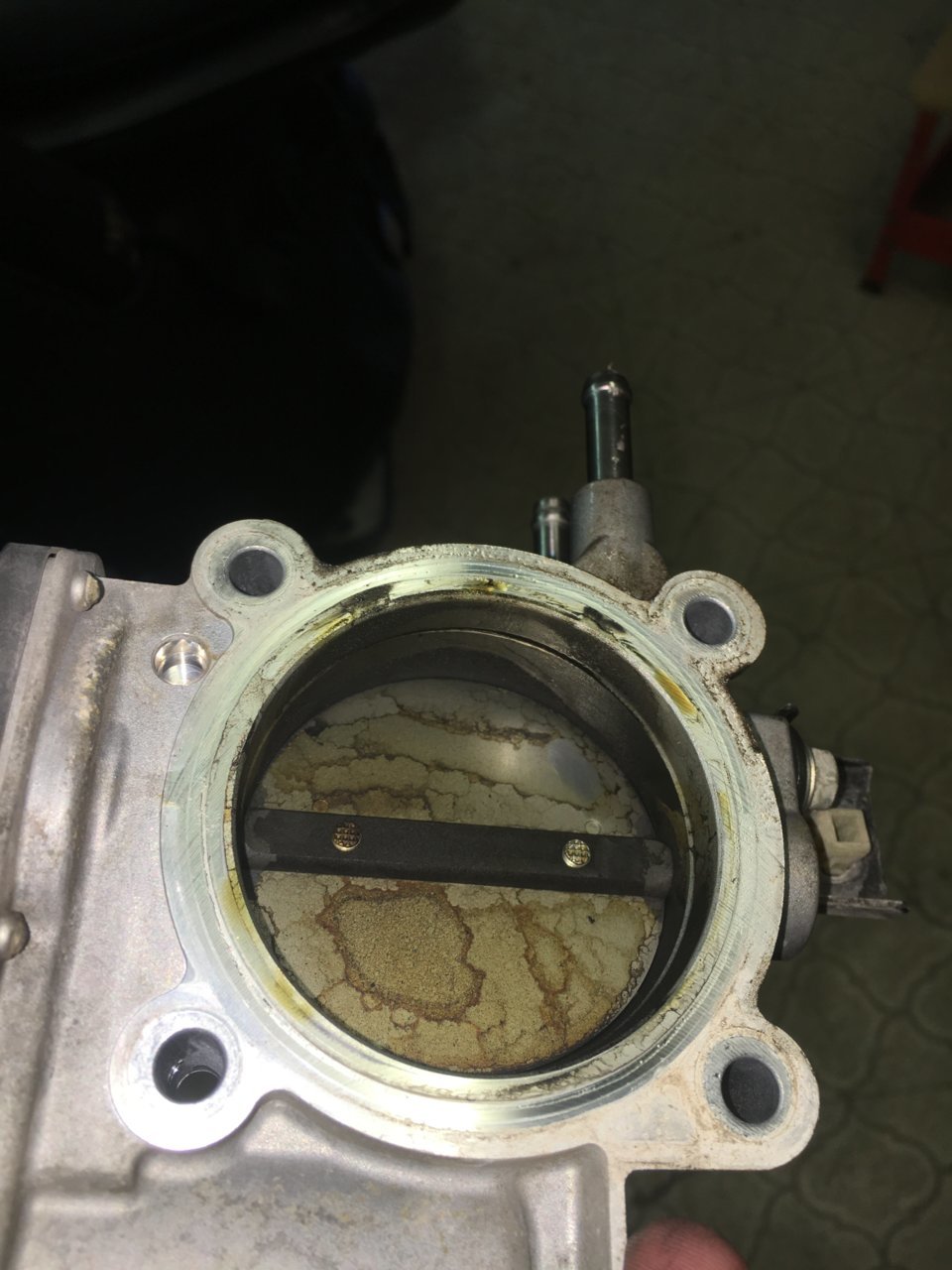

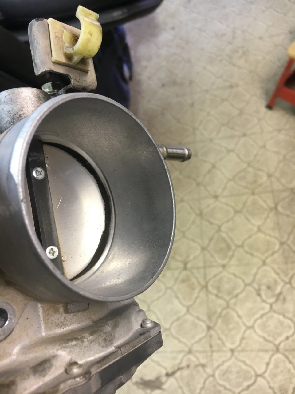

    Helped me ma today with her rav(2010 I think) she said it had a weird noise at idle, the air cleaner box clamps weren’t even clipped down, because they were splayed out to far, pulled them and bent them back tight. Cleaned the MAF, and pulled the TB for a cleaning, it was definitely dirty and needed it!

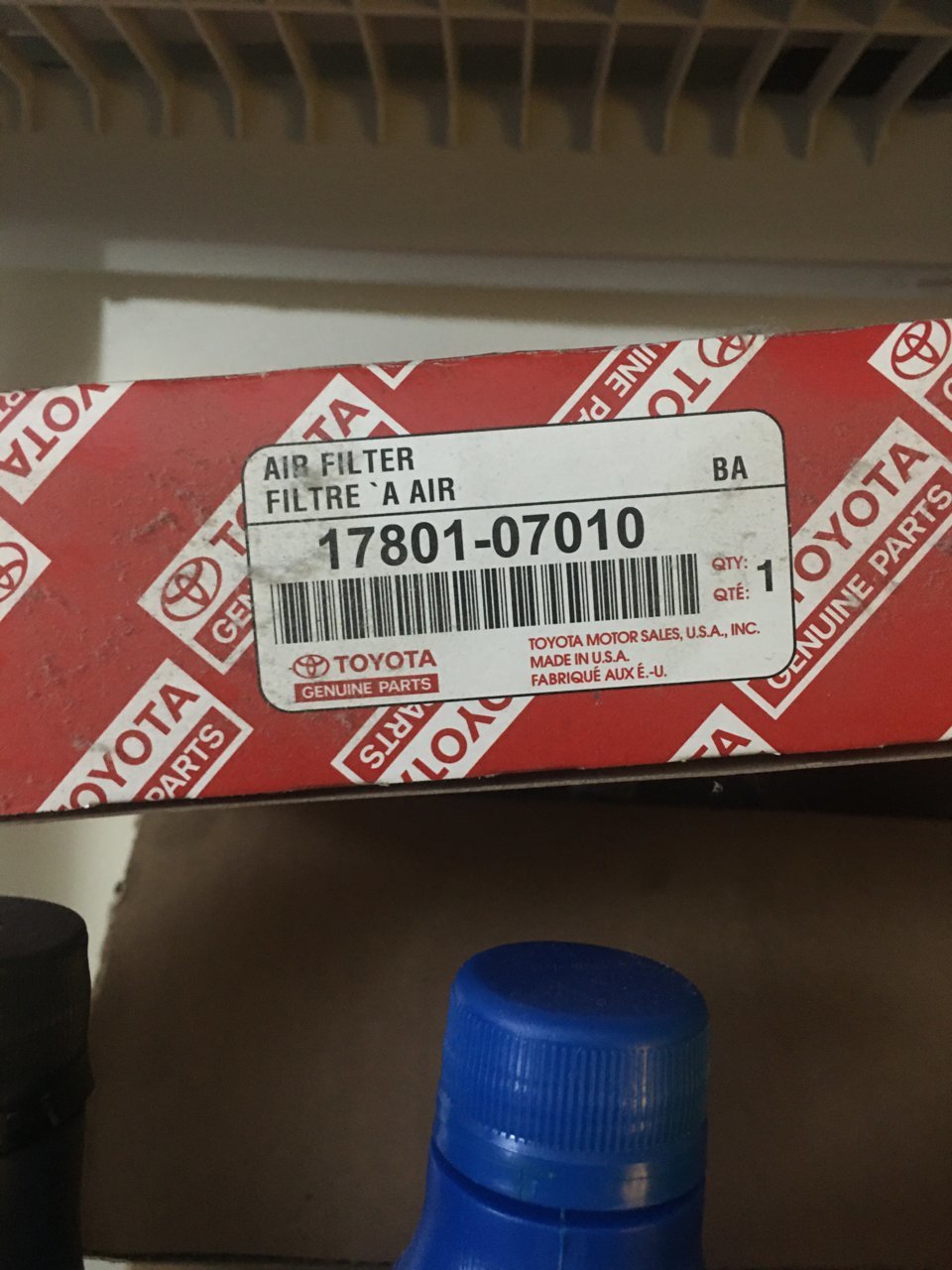

    Could someone shoot me a part number for a dealership engine air filter for my 01 tundra v8? I got a junk autostoned airfilter on there and its getting dirty so I might as well change it. Mucho appreciated

    I think you told me your mom had the V6 right? I need to do this to our Rav4. Trying to clean it while on the vehicle has been difficult because of how far back it is. Ours still doesn't idle right sometimes.

    I think it’s the v6, the air cleaner is on the driver side and the TB is back behind the engine? Yeah once I saw where it was I knew it needed to be pulled. The hardest part is getting the coolant hoses off of it.

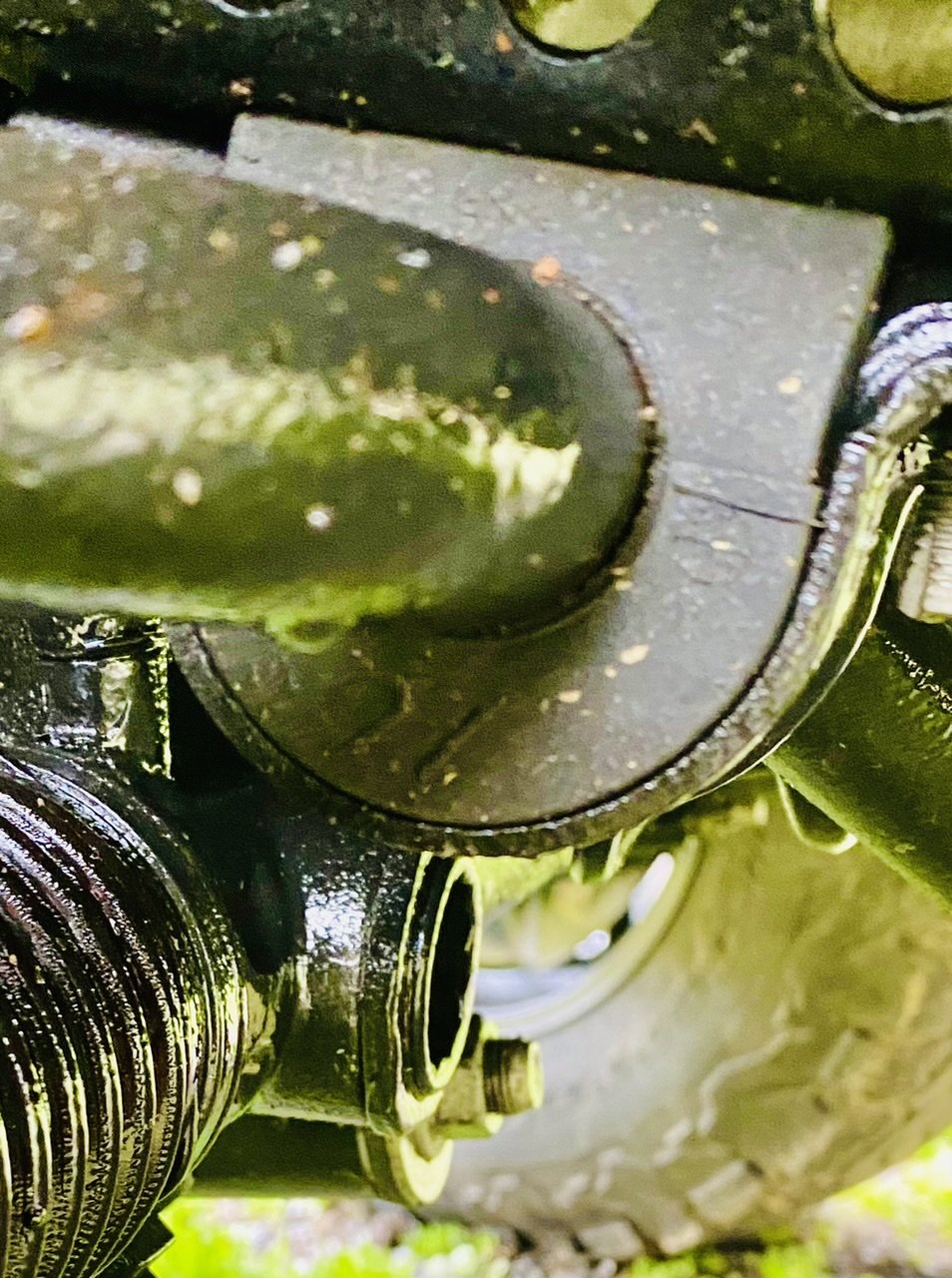

    I’m gonna guess my truck has one of the 27mm bars. That looks like a 27 on that bushing to me

    Measure the diameter of the bar

    Is the wrench truck legit for that? Or do I need a caliper?

    You have a 27mm wrench?

    Probably not but I’d come closer to coming up with a 27mm wrench than a caliper lol.

    That would be close enough.
    if the 27 fits with a big gap. You have the smaller bushing. If a 27 fits with no gap or doesn’t, you have a 27mm bar

    90% sure MOST are 27mm
