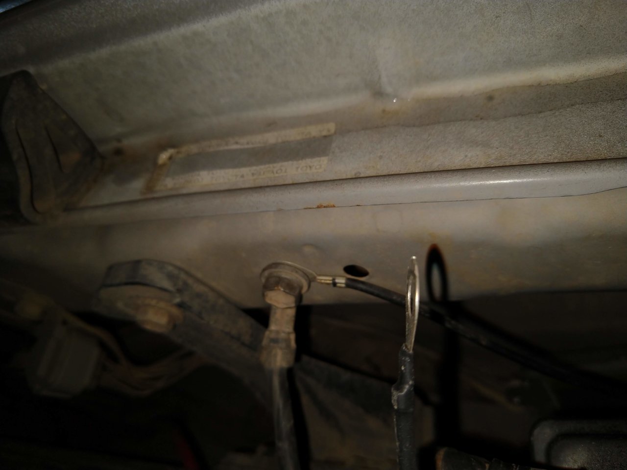

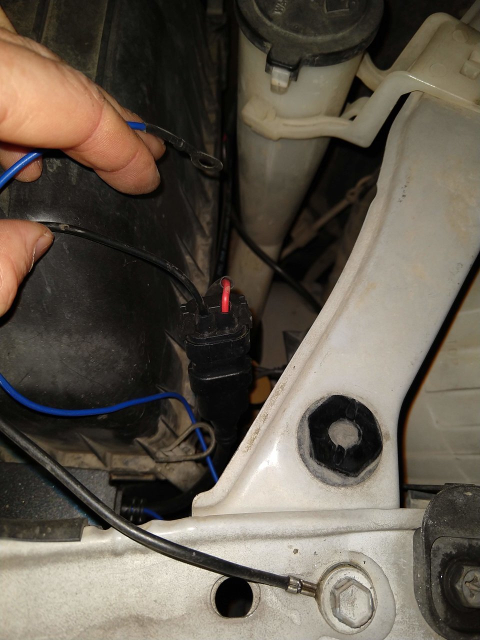

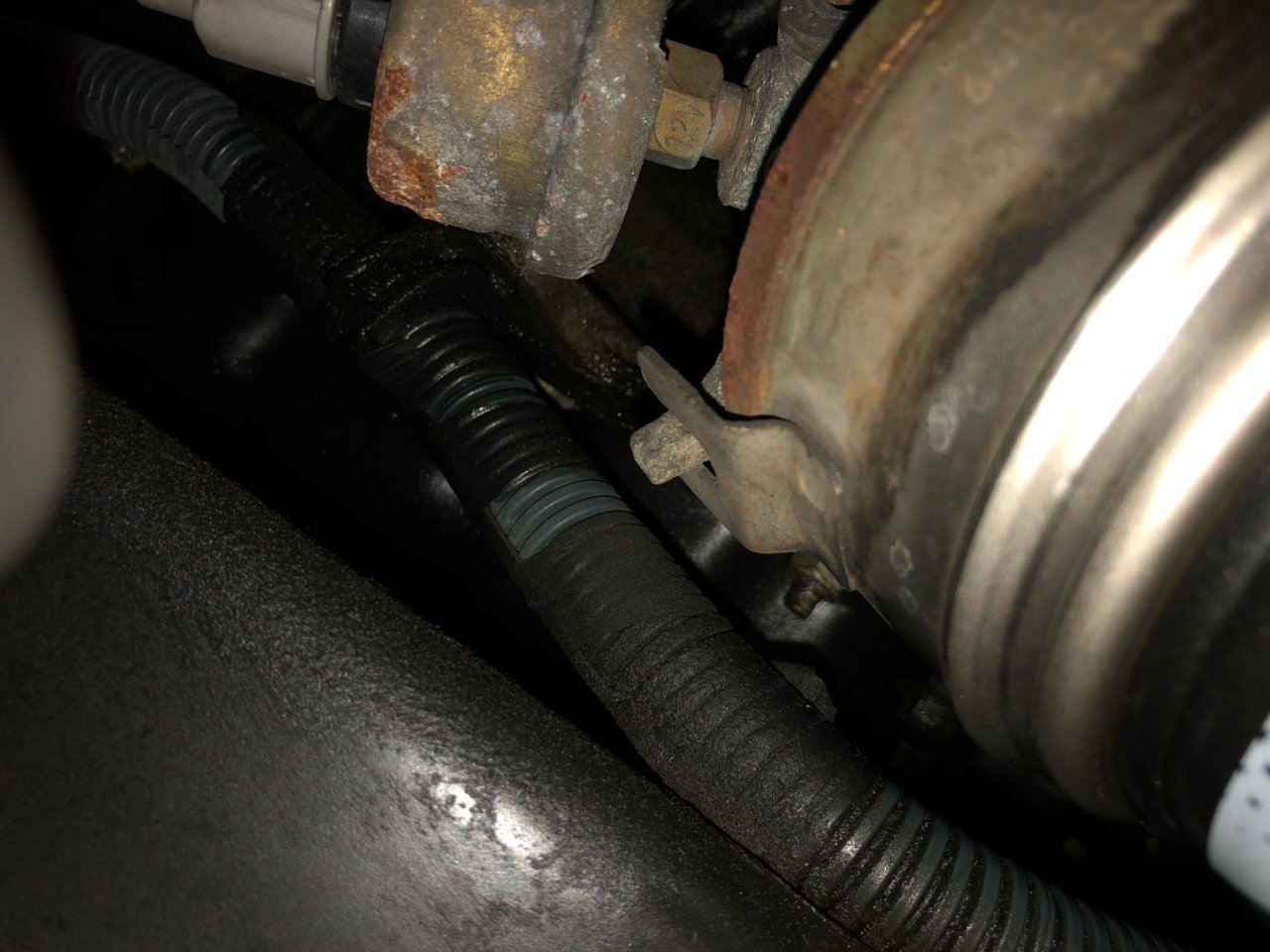

    Here are my grounds. The black wire actually connected is the xtreme depot ground, the blue wire hanging there is the hylux ballast ground

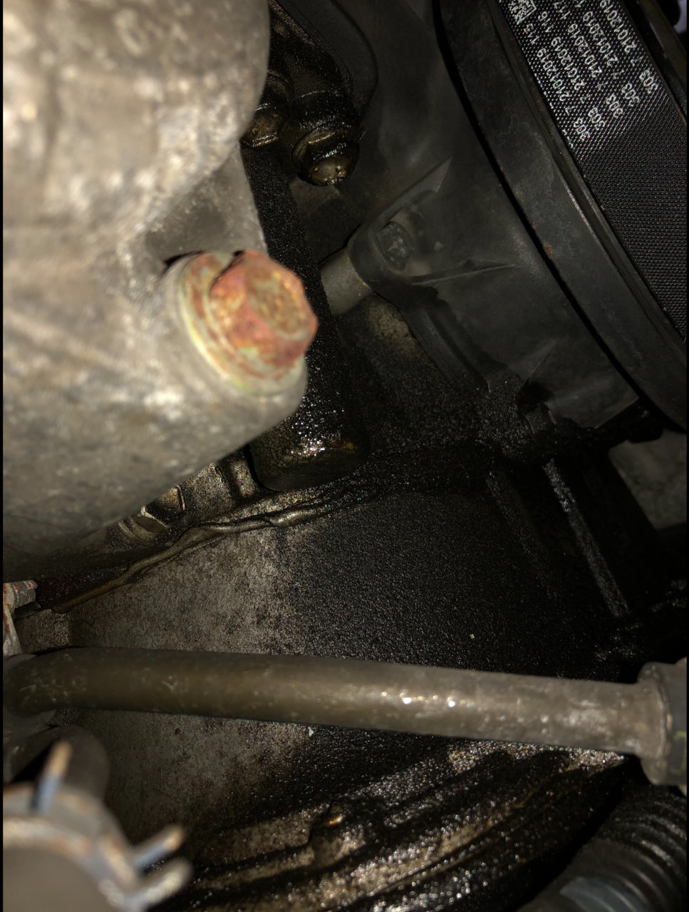

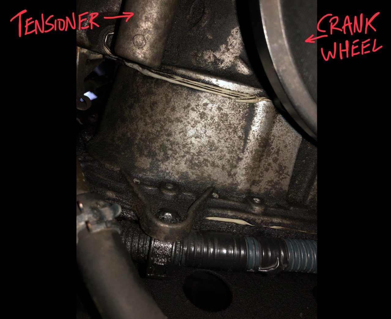

    I posted up some pics a long time ago of this region. It was an oil leak I thought to be from Cam Seals and leaking down into and along the Timing Belt Cover exiting out around some gaps. Ended up being a 50 cent o-ring inside the oil pump as revealed when the TB Replace occurred.
    Instead of removing the engine to replace the Oil Pump for a 50 cent o-ring, I just cleaned up the front of the oil pump of oil. I then snugged the Oil Pump Bolts a hair around the clock and applied Toyota FIPG along the top seam of the Oil Pump to stop any seepage coming up where the factory sealant was omitted due to the o-ring. Basically, I’ve blocked the oil from seeping up over the Oil Pump top seam (hopefully).
    This pic was taken 2 years ago with Gorilla Arm Technique. Top pic is wiped for oil tracking purposes. Middle/bottom pic is pre-wipe. A recent inspection of the same area looks oil free. Also, the oil filter/cooler area seems free of the seepage as well since the oil would migrate down along that route too.
    I’ll know more (with pics) when I do an oil change soon and have the Skid Plate removed that this ‘fix’ is truly working. Currently have about 1000 miles on the fix.

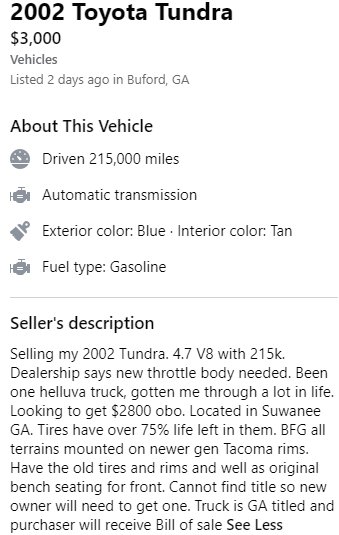

    Check out this bad boy for sale.

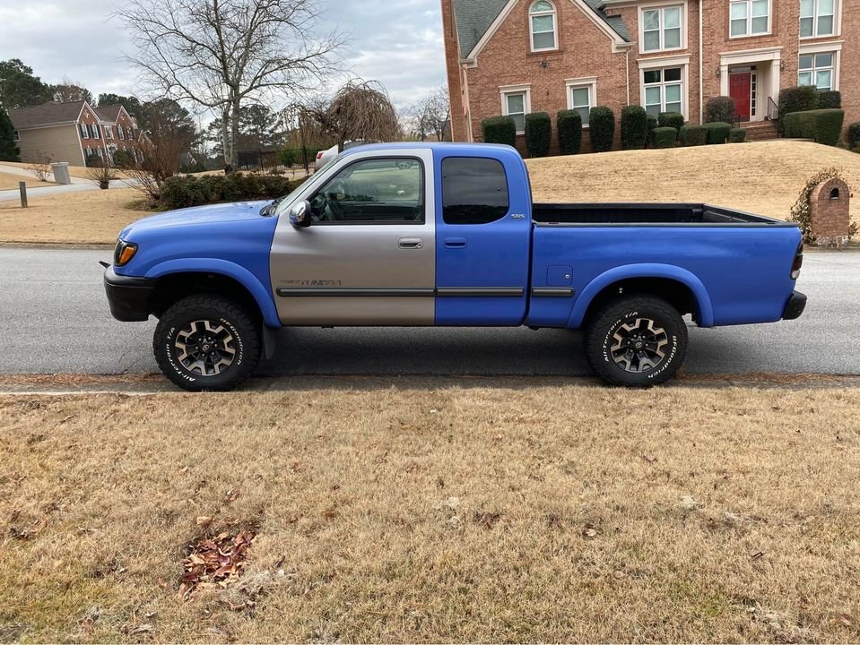

    I dig that blue. If only the door wasn't mismatched.
