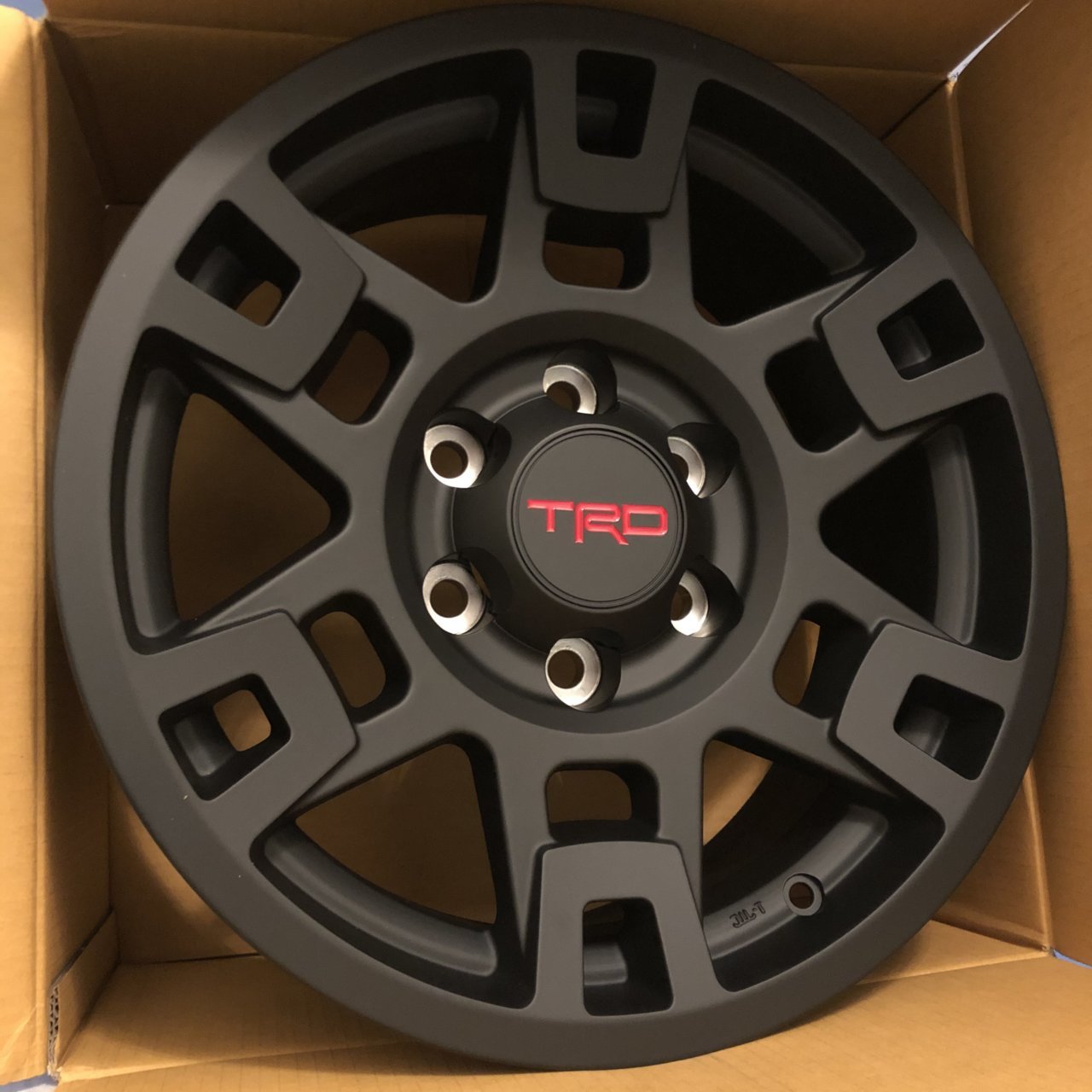

  15. Dec 8, 2020 at 3:47 PM
    Outbound
    Aug 2, 2016
    #4064
    12,345
    Aaron
    Northern Alberta
    Welcome to the club!! You'll love those wheels. :D
    Post pics when you get them mounted. I'm interested to see how they look on a black truck.

    @Outbound I debated on the black vs grey for a solid month. Will be reusing my lugs for now. Hopefully new tires in the next two weeks.

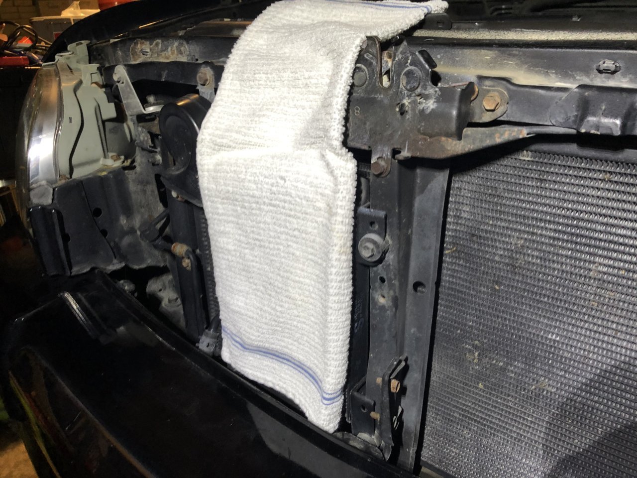

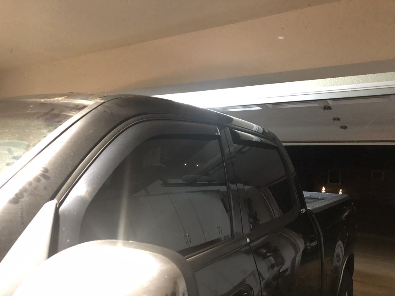

    Got it back from the tint job. It was the aftermarket blue tint that was peeling. Now it’s 35% ceramic on the front windows.
    Still struggling to get to that magic temp with the ATF. Need to put some tape over my window controls to prevent my brain from screwing this up. I already accidentally hit the button but caught it right away. Was told 3 days no window. Hope I didn’t fudge it up. Guess we’ll see! *stupid stupid brain*

  17. Dec 8, 2020 at 4:01 PM
    FrenchToasty
    Sep 15, 2019
    #36156
    18,700
    Mo
    The SoAz….. big surprise
    Bone stock
    Put a rag over the cooler, then let it idle to temp

  20. Dec 8, 2020 at 4:27 PM
    FrenchToasty
    Sep 15, 2019
    #36156
    18,700
    Mo
    Bone stock
    It will still take a while, but that and revving the engine will get you there

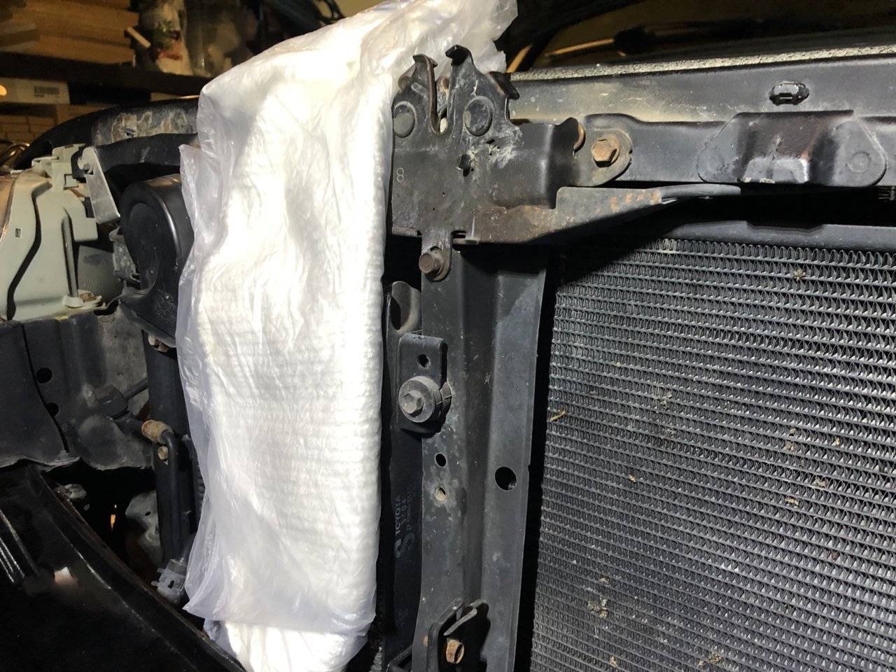

  22. Dec 8, 2020 at 4:40 PM
    Professional Hand Model
    #14878
    14,993
    Fred
    Hand Protectors
    I’d put a bag over the rag.
    Tundra2 and FrenchToasty like this.
  23. Dec 8, 2020 at 4:45 PM
    FrenchToasty
    Sep 15, 2019
    #36156
    18,700
    Mo
    Bone stock
    Notice the fold? That’s critical thinking right there! So he’s almost to thermal bag conditions
  24. Dec 8, 2020 at 4:46 PM
    jpink
    jpink Aspiring Shade Tree Mechanic
    Sep 25, 2020
    #52763
    373
    John
    Knoxville
    05 Black V8 DC SR5 (RWD)
    We’ve gone down from 98 and rising to 88 and I’ve now upgraded to a bag over it.
    I blame December in Iowa.
  25. Dec 8, 2020 at 4:46 PM
    #14878
    14,993
    Fred
    Hand Protectors
    Ya. He put the pic up before and as I was posting. Double layer technology critical thinking skills.
  26. Dec 8, 2020 at 4:48 PM
    #14878
    14,993
    Fred
    Hand Protectors
    Do a total bag wrap and then towel in front like you’ve already done.

  28. Dec 8, 2020 at 4:49 PM
    jpink
    Sep 25, 2020
    #52763
    373
    John
    Knoxville
    Bag is doubled over the rag but I could do a bag and then a bag wrapped towel
