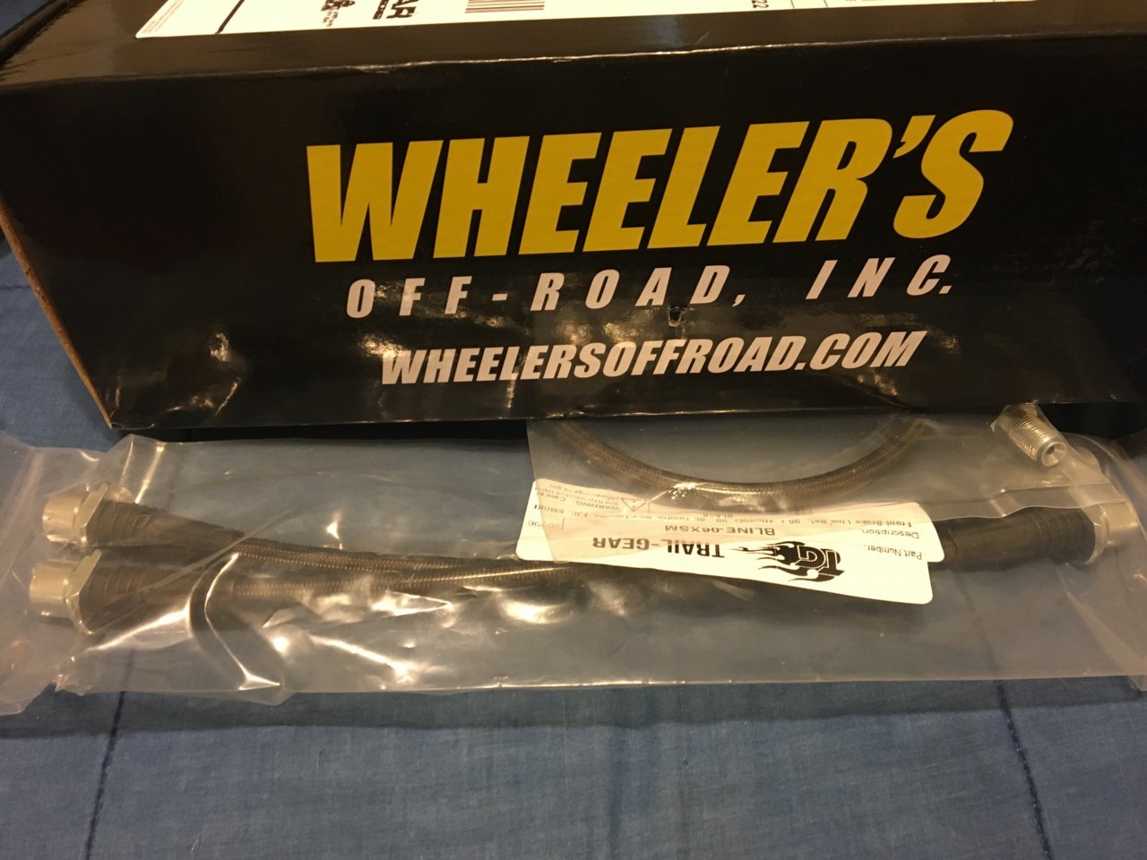

    They’re rubber on the inside. The braid does indeed serve a purpose and that is that it prevents the line from swelling under pressure. This is how it can actually make a difference in pedal feel.

    I think a lot of times stainless lines are just for looks. Technically the stainless braid around the line keeps the line from being able to swell (pressure going outward on the lines) as much and in turn keeps the pressure going towards the pads and onto the rotors. I really haven’t looked at our brake lines but I’d they are short than there is really no room for improvement. If our lines were 5ft long from hardlines to the calipers then you would see a better improvement with SS lines.

    Going to stainless lines on my Avalon, really firmed up the pedal. Putting good fluid in it also helped a lot. Pad choice also can make a difference. Chances are though, the 14wa calipers might very well be past the ability of the stock master.

    Wheelers are great. One thing people don’t realise about stainless braided lines is that the ones without a PVC coating on the outside? Shit gets in the braids and rubs through the rubber line, ending in brake line leaks

    Yeah I literally just opened that box, and noticed that clear coating on it, almost like a clear heat shrink.

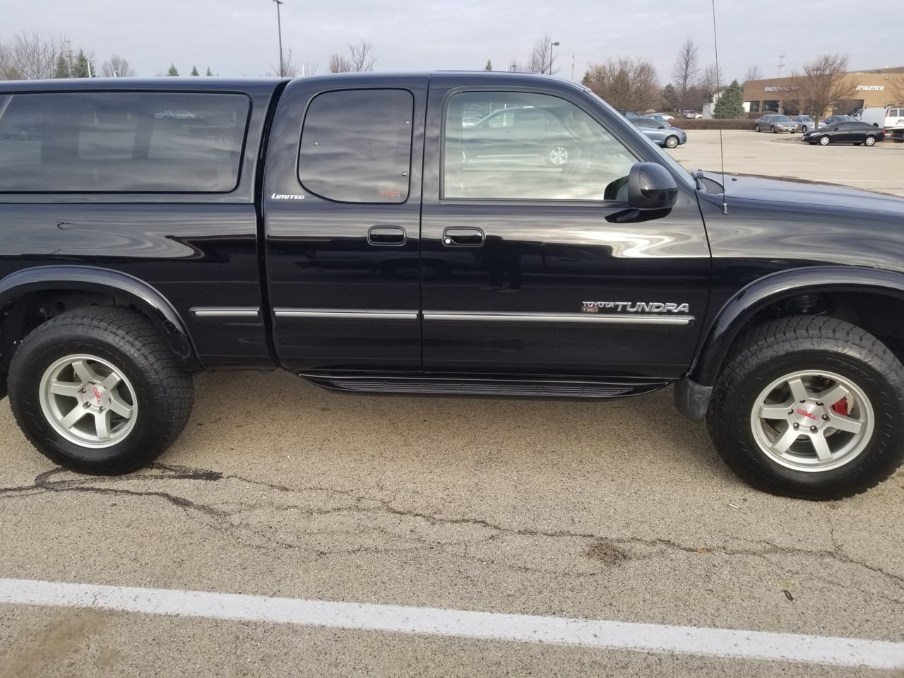

    That thing is clean too! I like those wheels but I don't recognize them. Either he got a new frame at some point or it's a non-northern truck.
    That sticker doesn't necessarily prove it's supercharged right?

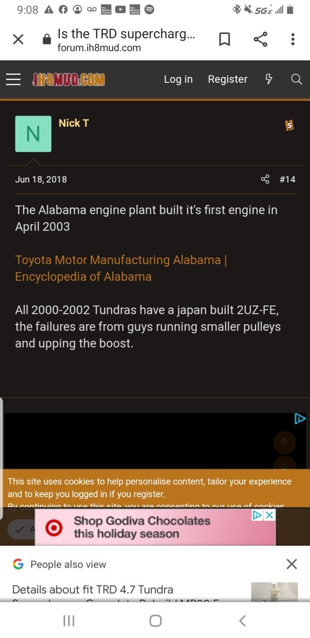

    Does anyone know if this is true? Pretty sure is, if so, the people who call 00-02 the runts of the litter and piss off! We have the japan built motors! Not like it really matters though
