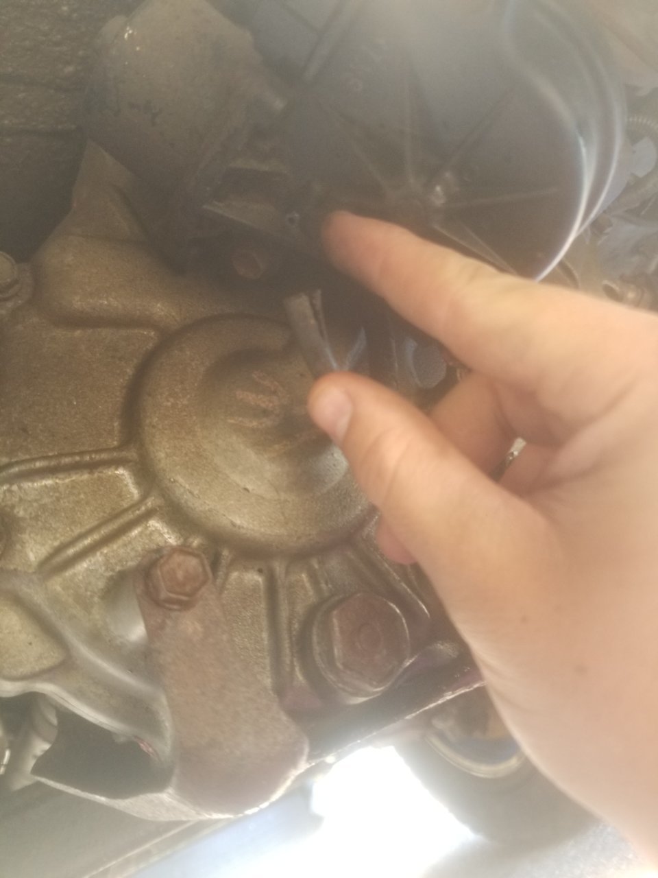

    Is that the transfer case?

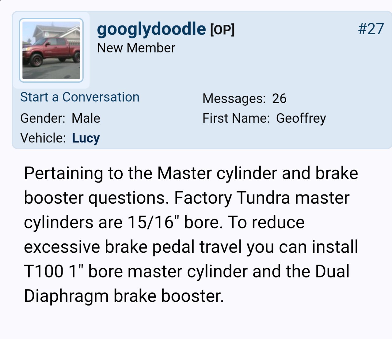

    I'm hoping I don't have to do this to fix this soft pedal. Anyone got a phone number for Gehoff? He hasn't logged on since March.

    I remember reading this back when someone posted early spring and added everything up. Total cost runs about $1500 for everything (brakes calipers, pads, lines, booster, cylinder). Everything I’ve heard is the guy is not responsive to any communication. Best bet is buy the stuff he wrote above and make it happen or live with pedal mush. Sorry bud.

    I’m not a facebutt member so I can not vouche to his comings and goings. I only read here from commenters posting Instasham messages and then the brake guy himself says he hasn’t answered a phone call for weeks. His words. Maybe and hopefully he can be reached quick.
    Pretty sure the secret remedy fix is what he posted already per larger cylinder and double d booster. $$$

    SOS performance makes an adapter for the Sequoia master. I have no idea how it will work with drums but it does work with four wheel disc
