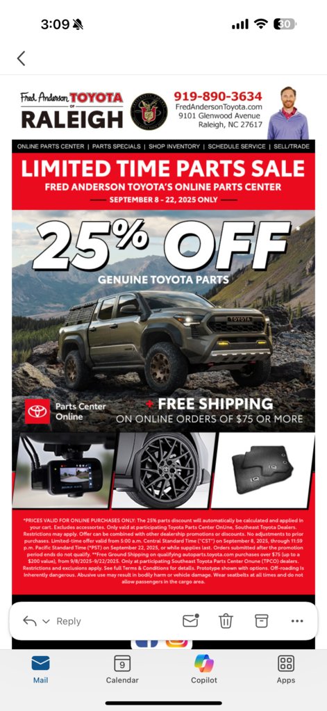

    Anytime you see a sale like this, it's not coming from the dealership. It's coming from Toyota. You can pick any participating dealer of your choice.
    Serra Toyota of Birmingham=good
    Serra Toyota of Decatur=bad
    @jpink got the same offer from Fred Anderson.

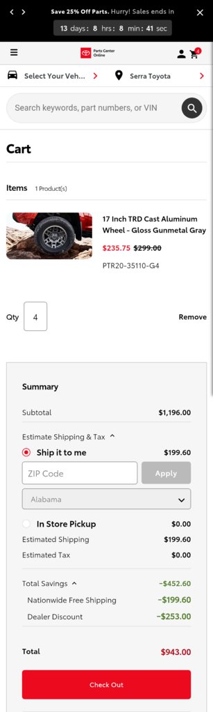

    dont want a matching spare?

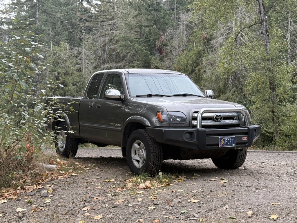

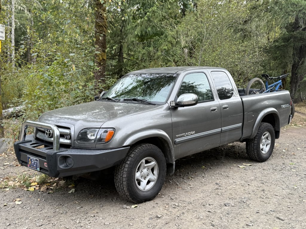

    I swear the photos make it look bigger than it really is. When the rest of the mounting bolts show up I need to pop it off and level it better. Was in a hurry when I installed it the first time.

    Deer tenderizer, nice.

    I’m going on record that that’s the best winch bumper a guy can get for $1000 in this day and age. Great find, you definitely lucked out. A pair of larger aux lights that are located centered on the top of the bumper (between the hoop) might visually break up the front end and make the bumper look a bit smaller? Even without, it still looks fine.
    If you’re on a budget, maybe look for a used warn M12000 winch on craig’s or faceplace marketbook? There tends to be quite a few that are always for sale here in the pacNW. The only thing i would do to a used warn is to get rid of the fail prone solenoids and upgrade it with a reliable Albright contactor switch. A contactor switch is a lot smaller and can be tucked/hidden inside the bumper.

    Could probably fit a full case of empties on that bumper.

    Yeah, I'm definitely happy with this purchase. I have already started looking at 6" and 9" driving lights for inside the hoop. If it's not raining tomorrow I need to measure some stuff on it and take some photos to send to ARB. I suspect this bumper is over 20 years old, the guy I bought it from had it sitting up on a ledge in his garage for a while. The fog light surrounds don't match anything that ARB currently sells, and ARB bumpers without the marker lights next to the fog lights seem to be pretty rare.
    Current plan is to get the fog lights sorted. Fix my leaky power steering cooler, the brace it mounts to had to be removed and moving it around opened up some cracks in the hoses. It's weeping now. Start figuring out a winch for it, I contacted Warn and asked them and they told me to ask ARB. Look at options for spot lights. The spots and the winch if I go new can wait until black Friday and hopefully there will be a decent sale on them. Just want it all buttoned up before we see any snow.

    When I pull mine off to add the rest of the mounting bolts, I'll take some photos of how it mounts. ARB has crumple zones between the bumper and the frame, but the mounts were pretty well designed to fit on the end of the frame rails. Definitely a lot beefier than all the sheet metal parts I removed.
