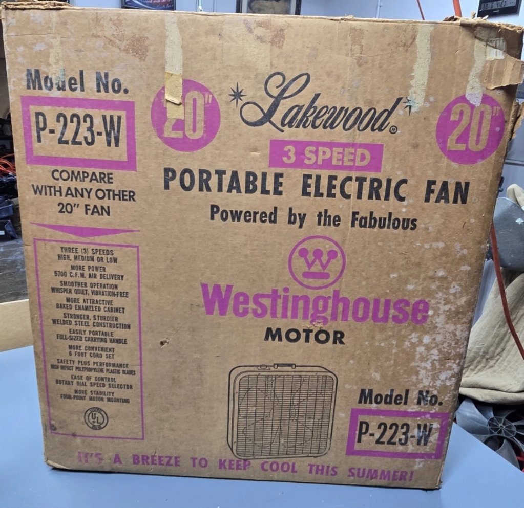

    Is oiling a box fan before using and kick starting it like a model T by spinning the fan blade by hand an indication I need to buy another or tear it apart and properly lube it?
    I bought it in 1985 and everything but the blades are metal. Won’t find that today at an inexpensive price.

    If it works don’t fix it.

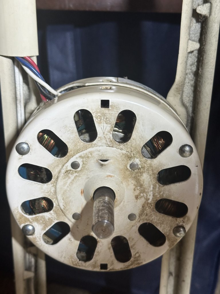

    It’s probably a shaded pole motor so it doesn’t have a ton of starting torque, if you can pull it apart and clean or change the bearings, maybe clean the rotor and stator if you can

    My only concern is if I pull the fan blade off the shaft it’ll split and I won’t be able to put it back on there. Been kind of reluctant to do so because of that. If it’s near dead, I may just give it a try though.

    Guess I shouldn’t have made THAT comment…it just died like a fuse went out and I don’t think it has any fuses so I’m guessing one of the windings broke.
    Bummer.

    And it lives! Must’ve been a thermal shut off. The specs on mine can’t be matched by a Lasko box fan of today I see. 5700 CFM, wow.

    Hahah why do you still have the box from 85?

    No, I wish. I just copied that from online when I read the tag on the manufacturer and model number.
