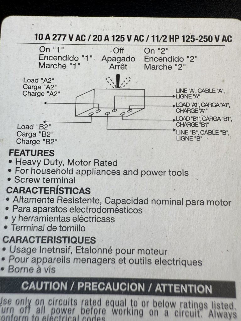

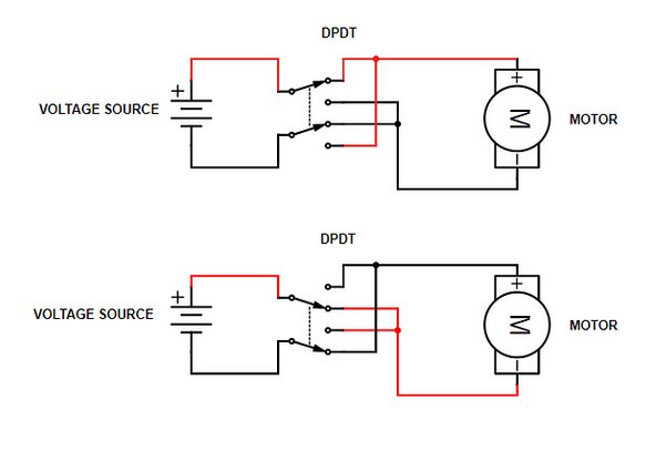

    Hey, someone explain this like i’m 5, and i want to wire a fan that spins both directions.

    If it's the type of fan that can switch directions by just switching polarity, you'll need a Double Pole Double Throw Switch. Three-way switch where it will be On (forward)-Off-On (reverse).

    sorry this is what ive got.
    Forgot to add the pic.
    I know its overkill, but its what i could find. I’ll get another to match for my white/amber aux reverse lights. Except it’ll have diodes and either light up for reverse or the switch in the bed. Might also want a switch in the cab. And it could run the fan in the bed cap ceiling, or a fan in the cab.

    This is how you would wire it but can't guarantee the switch is rated for 12v and will work off a car battery. If you want to use an On-Off-On for lights, that is a different diagram than changing direction of your fan.

    Thank you sir. I was good with pictures when i was 5. Pick a trophy, i’ll send it back with sid.
    do i need diodes? I dont wanna backfeed nothing. Everything runs ground through lug 5, or multiple grounds?

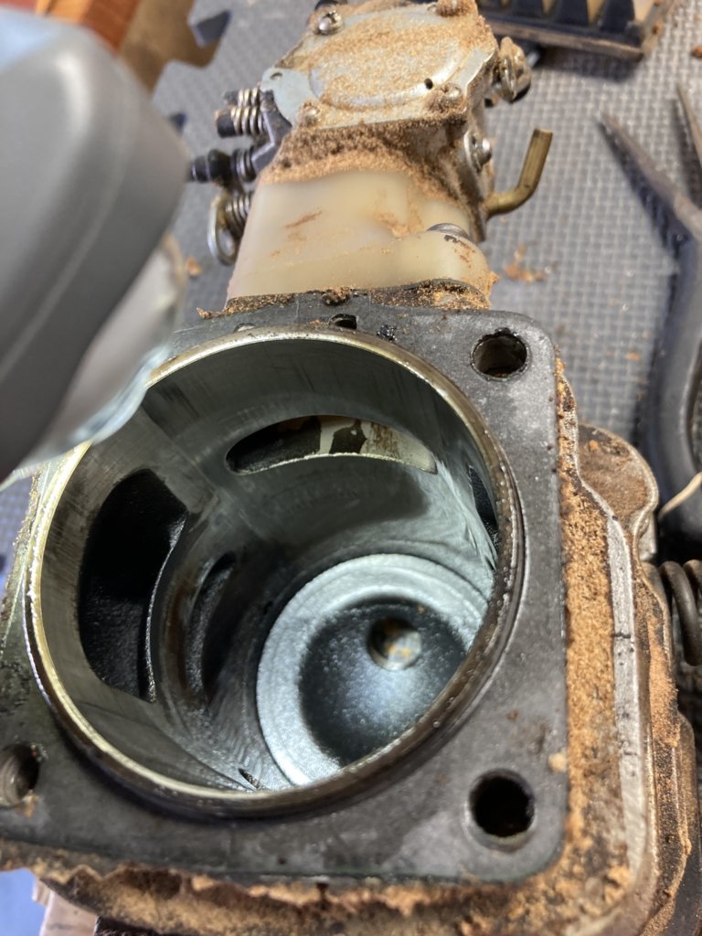

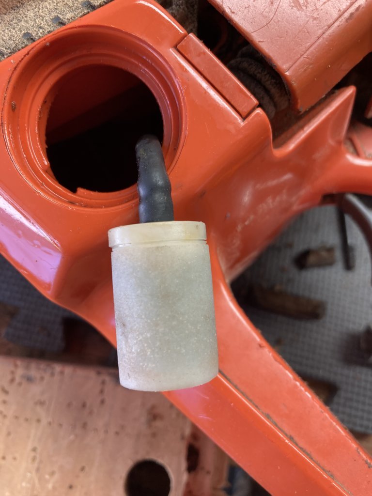

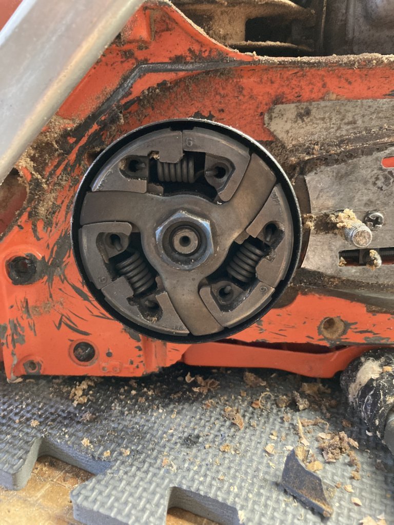

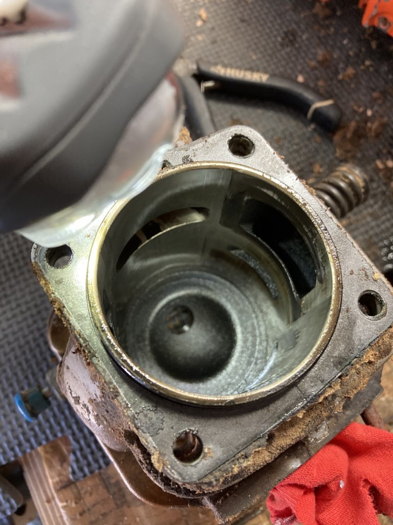

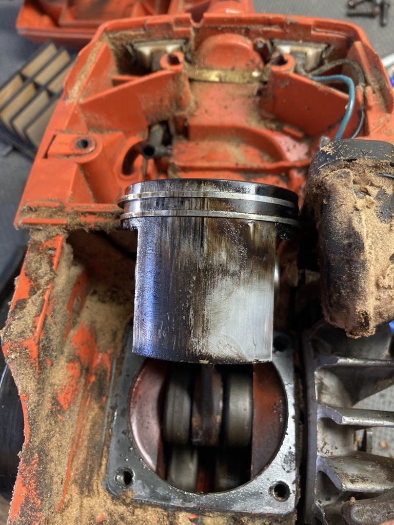

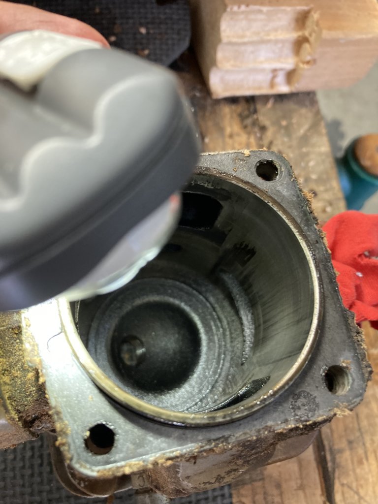

    Got it torn apart more today. Jeez it was oily inside that cylinder. That part that looked like a fuel line was the choke connector arm. It was fine. See photos below.
    • clutch looks good to me, spins freely
    • No clogs from chips anywhere.
    • Piston moved up and down smoothly inside cylinder
    • Pre clean shot of the piston - very oily
    • Cylinder walls were oily but totally smooth, exhaust port was crazy sooty
    • Post cleaning shot of the piston. Maybe some super minor scoring, but nothing that seems like an issue
    • Fuel filter looks good
    • Didn’t take a photo of the air filter, but it was dirty-ish. Nothing wild.
    Plan is to:
    • put fresh 93 octane in it with 50:1 2 cycle oil
    • New spark plug
    • Carb clean out as best I can (not sure I want to disassemble)
    • Clean up cylinder and piston, exhaust port
    • New seal collar that holds the transfer pipe (idk what it’s technically called) between the carb and the cylinder.
    All in all it just looks super dirty, but the mystery to me is why it was running so well and then just kind of started to have this problem almost instantly mid cut. To me if it was just dirty, this would be a long developing issue, right? I also will try some different carb settings once it’s reassembled. If that doesn’t work, new carb may be the next part to replace.
    IMG_2111.jpg IMG_2116.jpg IMG_2120.jpg IMG_2121.jpg IMG_2122.jpg IMG_2124.jpg

    No fine cracks in the clutch?
    Nothing is jumping out at me, but I'd have swapped out that plug and hit it with starter fluid before teardown just 'cause. I think a lot of that residual oil is probably from it dying, then you trying to crank, and it pumping in.
    I'm gonna wager the issue is the carb.

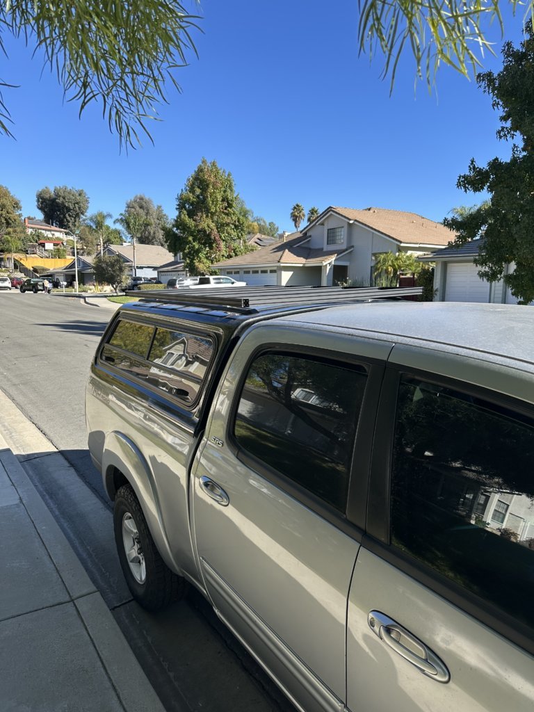

    I’m asking here before I post it to Facebook to see if it’s a good idea. I was thinking about offering a trade for camper shells I’m looking for a mid rise shell. Do you guys think it’s worth it to post it on facebook?

    You may find a trade because you are offering sliding windoors.

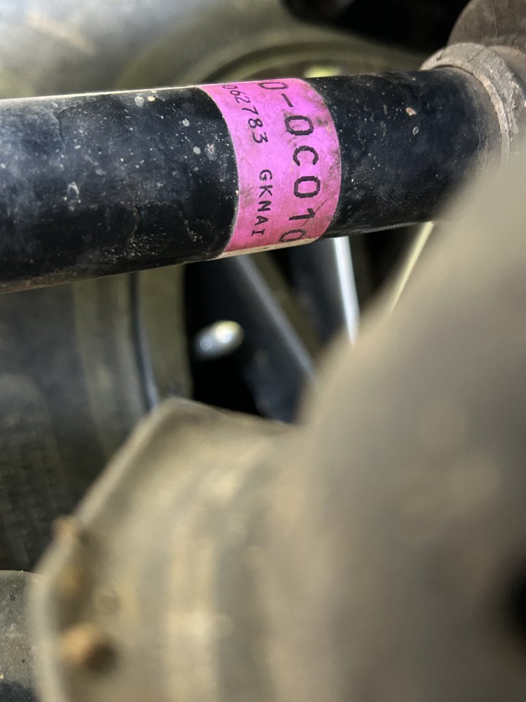

    How long do the Toyota part numbers stay on parts like drive shaft, and cv axles.
    I'm getting part numbers as I work on the truck and see stickers. Most are coming up as OEM numbers so just curious. CV boots look almost new, and it still has the part sticker on it.
    The front drive shaft has what looks like a fairly new Dana/spicer part number sticker.

    Less than 5 years where I am due to the road salt/rust.

    Your diode question is a little bit outside of my wheelhouse so I'll defer to the experts, but I think that will depend on whether the fan is brushed or brushless.

    My truck has the original CVs at ~83k original miles and ~20 years since manufacture and they're still pretty vibrantly pink. Although it's totally possible that's a non-remanufactured OEM replacement you've got there, if someone replaced recently.

    Same on my original, definitely-not-replaced 2001 CV axles. Stickers still there and legible. Note that the date codes are likely to be in Japanese dating format.

    You're in SoCal yeah? If you want to sell the shell instead of trading it, let me know.

    No, clutch looked great. I did end up taking the carb apart and cleaning it out as best I could. Honestly, it looked great other than the crap on the outside. I'll replace the sparkplug and see how it goes. I also never tried to fiddle with the carb adjustment screws, so I could do that too.
    Honestly it was kinda cool getting to take apart an engine like that in a little lower stakes scenario. That's the first time I've ever gotten to the actual cylinder and piston. Lord help me if I ever get that deep into the Tundra.

    With two strokes it really doesn't take much to foul a plug and it can happen pretty fast. Flooding it trying to start it again after the plug fouled should be the cause of all the extra oil you had on the piston. If this happens again when running it hard for a long time, start with replacing the plug and letting it cool off over a beer and see how it runs.
