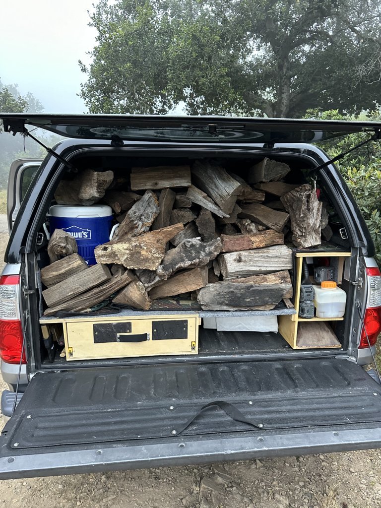

    The SoAz….. big surprise
    Bone stock

    Haha thanks, it was at maximum capacity.

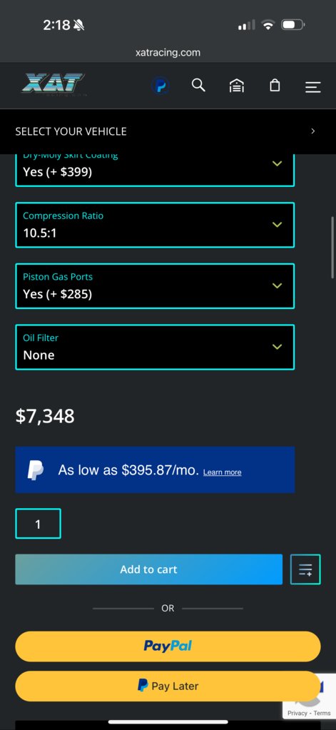

    PS - I'm really curious on the PF testing, I'd never heard of EZ-lok before, but those things actually look like a pretty exceptional solution, granted price point isn't great. My only concern with Helicoil or the China knockoff of helicoils is retrieval of the tang from the cylinder and any other fragments after setting.
