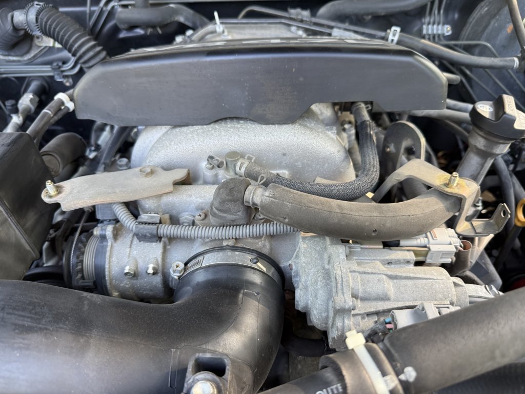

    Can anyone with a 2002 AC post a photo of their right (passenger side) mounting bracket under the "V8 4.7L" throttle cover? (An earlier year may work, but from 2003 onward, the bracket on that side is different.) Had a mechanic mess mine up and now I need to see what it looks like and how it's oriented. Huge thanks!

    this the pic you need?

    Yep, thanks!

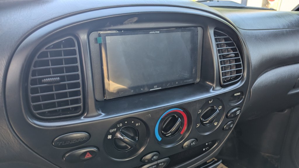

    Got my new head unit installed, Alpine ilx-770. So far I'm really liking it. Still have to take it back out to install my camera, so I left the screen protector on until I'm done messing with it.

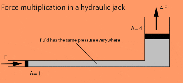

    I know brake fluid type is generally a difference of temperature, but do the gx brakes need anything special? Are the seals the same rubber as our regular calipers?
    Anyone have any issues with larger caliper pistons on a stock master cylinder? Like does it feel different at the pedal?

    I've read the master cylinder should work fine if we bleed the system. I've read a few people complain, but based on their complaints about a "spongy" pedal or too much travel, I'm convinced they had air in the lines. I've also read about people upgrading the MC, but it's not necessary, according to the guys that machine the calipers for everyone on the FB group.

    I feel like larger caliper pistons would be better for pedal modulation, but the master cylinder piston might need to move further.
    if each piston is .2” larger, thats 1.6” bigger across all 8 pistons. Not nothing. I’m sure its fine, since i havent heard about anyone NEEDING a new MC. Just curious.

    I don't feel this is necessary at all. When I did the WE to WL swap, I didn't bleed first. Besides, what percentage of actual contaminants could become trapped inside the new caliper from the old fluid after bleeding? Practically none.

    Brakes are a system. If you're upgrading one part of the system (calipers) you need to make sure the rest of the system can keep up.
    The master cylinder will work "okay" but it is not appropriate sized.
