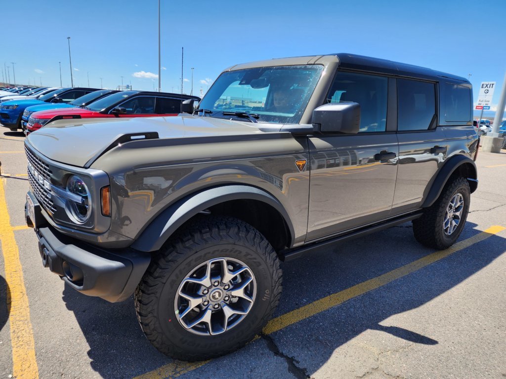

    Just spent a few days up in Colorado and had a 2025 Bronco rental car. I didn't much like it at first, but the more that I drove it the more that it grew on me. I'd never buy one unless I just had money to blow, but it was a good time.
