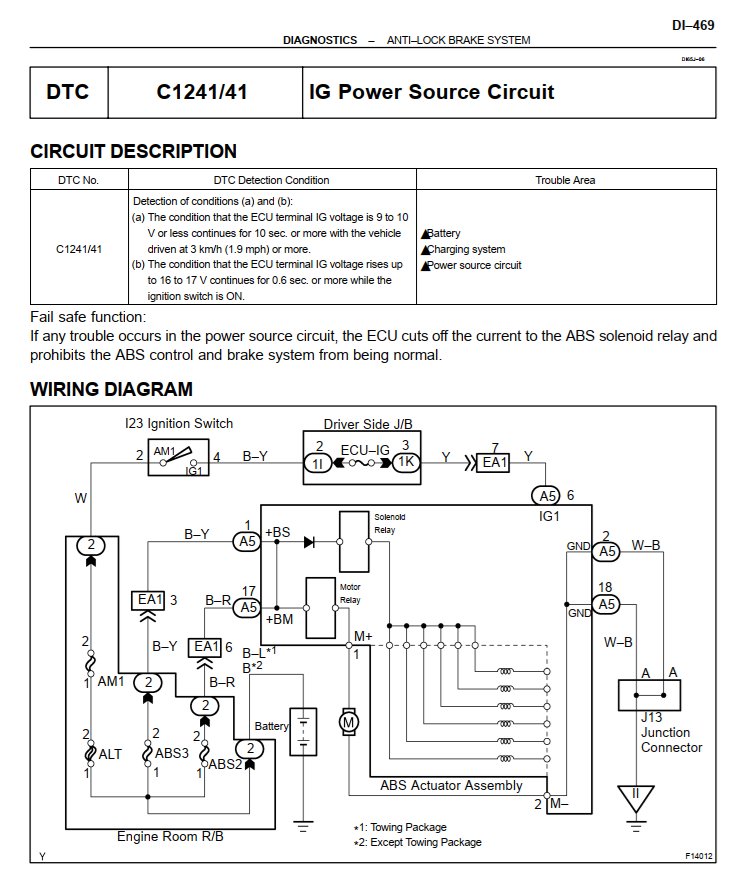

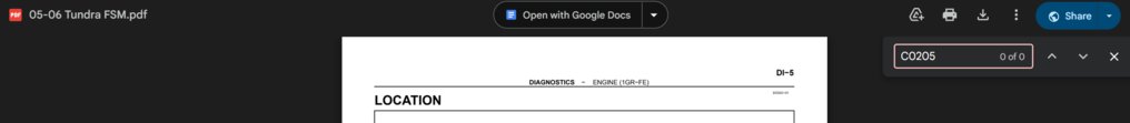

    I’ll have to give it another try I guess. Should I clear the codes after?

    Check for garbage buildup in the tone ring also, on the wheel it’s bitching about buildup in. Also, take sure the tone ring is visible near-centered or at least taking up a good portion of the sensor hole. Yes clear codes. I can’t remember if you need to clear them in the ABS ECU or if you can just clear normally. I’m more than a bit surprised to see you have multiple sensors bitching also. Almost like someone repressed bearings wrong, but probably not because it’s voltage/circuit codes?

    Oh and I just looked up c1241 b/c it wasn’t ringing a bell. Basically that code suggests your ABS module isn’t able to get enough voltage to function properly. Which may also suggest THAT is the problem, and the other codes are phantoms caused by the module-voltage-too-low issue, eh?
    I’ve not seen that code on here recently so if I were you I’d consult the FSM for that code string ASAP and start debugging.

    I was looking though the facebook groups and someone had the same thing and replaced the module, but my abs light has been on for almost a year now.

    It very well may be the module/ABS ECU, but if I don’t have handy cheap access to a spare to test, I would just go by the FSM’s testing to confirm it’s the module. The process is in there IIRC.

    Forgive me for my ignorance but what is the FSM and IIRC? its probably a stupid question lol

    Factory Service Manual. You know, the thing linked in the mega thread near the top you should have downloaded by now? :rofl:
    IIRC = if I recall correctly. And a lot of times I don’t. But in this case I think I am.

    Yeah it’s amazing. Open the FSM click on FIND in your PDF reader, and plug in your code. You may have to jump thru ‘next’ a few times, but eventually it takes you right to the diagnostic tree and all the info you need to diagnose the problem. Straight from Toyota. Exact same type of manual the shop tech is going to consult if they’re not familiar with the issue enough to directly solve it. Fucking magic. :rofl:

    codes aren't showing up in FSM weird maybe I'm doing it wrong?

    Don't start buying parts until you know for sure what the issue is. I've tried three different wheel speed sensors and still couldn't fix mine but I was having different symptoms than you. I was getting random ABS activation below 5mph but my light wasn't on.
    I eventually gave up and pulled both ABS fuses which triggered the light to come on. So now I live without ABS but my ABS light has been on for 6 years.
    You don't have that option in your 2005. They changed the fuses at some point and yours can't be pulled like mine.
    This thread may or may not help.
    https://www.tundras.com/threads/slow-speed-abs-activation-fixed.131442/

    Strange, I guess ABS codes aren't in the '05-06. They're in the '03 manual. Grab a copy of that year and run diagnostics from there. Section DI-469. They're saying that specific code is either battery/alternator or ??. Fastest thing you can do to rule out one of the three is to go to the local auto parts store and get your battery tested. If your alternator is more than 150k miles old, maybe a refresh is in order., but you can test it. And of course, check for cable corrosion and terminal corrosion, and terminal tightness.
    Anyway, yes, I think that code specifically is potentially triggering the other codes.

    The FSM for 2005-6 shows the wiring for a double cab starting on page 454 of the electrical section. Looking on page 457 the grounding points for this system are behind the kick panels. Been raining some around here. Might be a good spot to check. Page 92 shows locations for IN and IO these grounding points.
