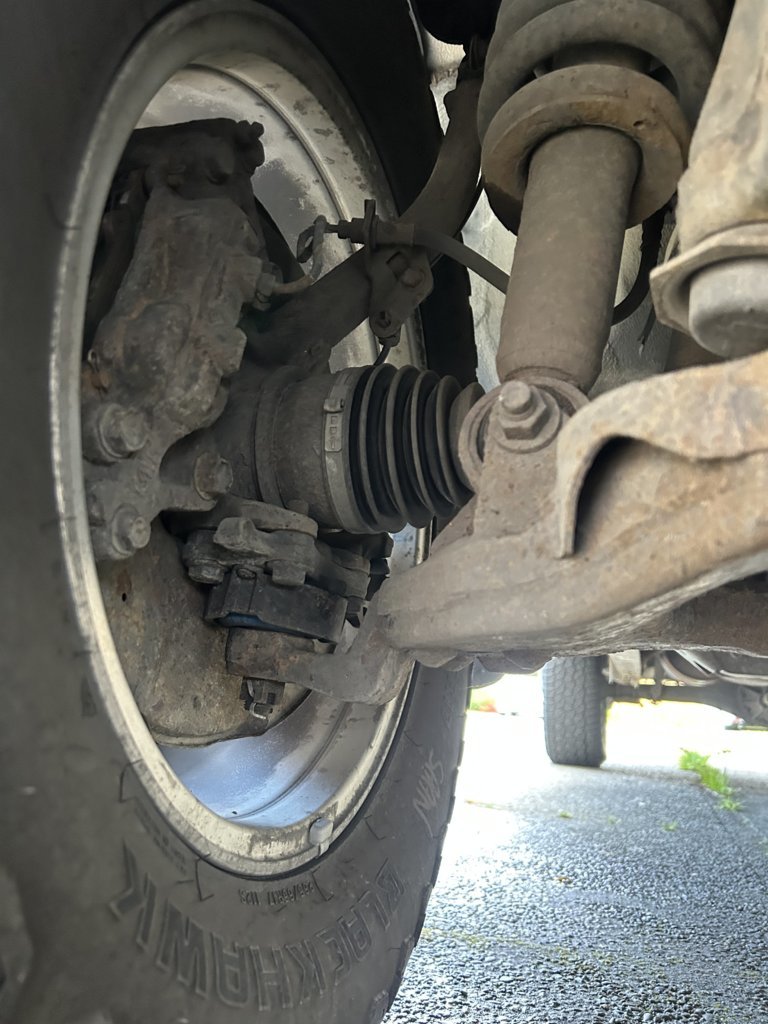

  10. May 10, 2025 at 6:49 PM
    Hutcheson
    Hutcheson New Member
    Jun 12, 2024
    #118342
    123
    Caleb
    2004 DC Limited
    Spot the issue :monocle:
    PO put them in about 4000kms ago, it’s on my list of things to do… OEM or bust.
    The Black Mamba likes this.

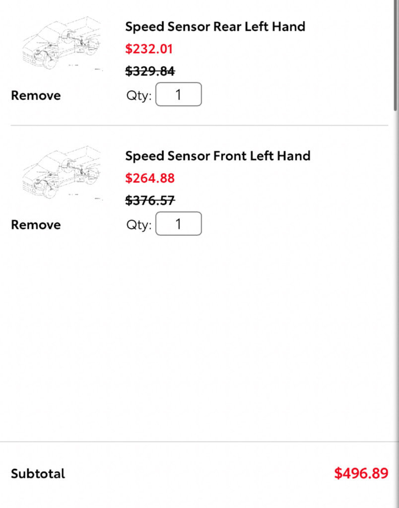

  11. May 10, 2025 at 6:51 PM
    Stock63
    Stock63 New Member
    Jan 8, 2024
    #109885
    201
    2005 Tundra DC 4WD
    We really paying 250 for a speed sensor?
  12. May 10, 2025 at 6:52 PM
    Sirfive
    Sirfive Socially feral
    Jan 24, 2021
    #58078
    5,550
    SATX
    ‘02 Limited AC TRD
    Bassani cat-back
    brake line in the wrong spot?
  13. May 10, 2025 at 6:53 PM
    Stock63
    Stock63 New Member
    Jan 8, 2024
    #109885
    201
    2005 Tundra DC 4WD
    Lower ball joints aren’t oem? I see a little blue cover there I think
  14. May 10, 2025 at 6:53 PM
    Sirfive
    Jan 24, 2021
    #58078
    5,550
    SATX
    ‘02 Limited AC TRD
    Bassani cat-back
    nope a speed chart rpm vs speed for 4th & 5th.
  15. May 10, 2025 at 6:54 PM
    Hutcheson
    Jun 12, 2024
    #118342
    123
    Caleb
    2004 DC Limited
    Righto! Mevotech I believe PO said
    Sirfive likes this.
  16. May 10, 2025 at 6:55 PM
    Hutcheson
    Jun 12, 2024
    #118342
    123
    Caleb
    2004 DC Limited
    That would be news to me, also I noticed the other one has a nice pipe clamp around it.
    LBJ isn’t OEM
    Sirfive[QUOTED] likes this.

    i see the blue now.
    Hutcheson likes this.
  19. May 10, 2025 at 6:58 PM
    Sirfive
    Jan 24, 2021
    #58078
    5,550
    SATX
    ‘02 Limited AC TRD
    Bassani cat-back
    for $250 i’d have a post-it on my dash listing speeds at 1.5, 2, 2.5, & 3krpm in my top 2 gears. I know 70mph is 2200rpm in OD.

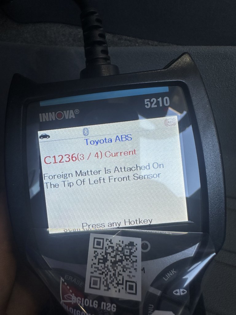

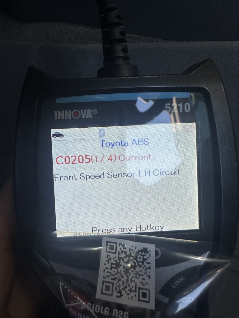

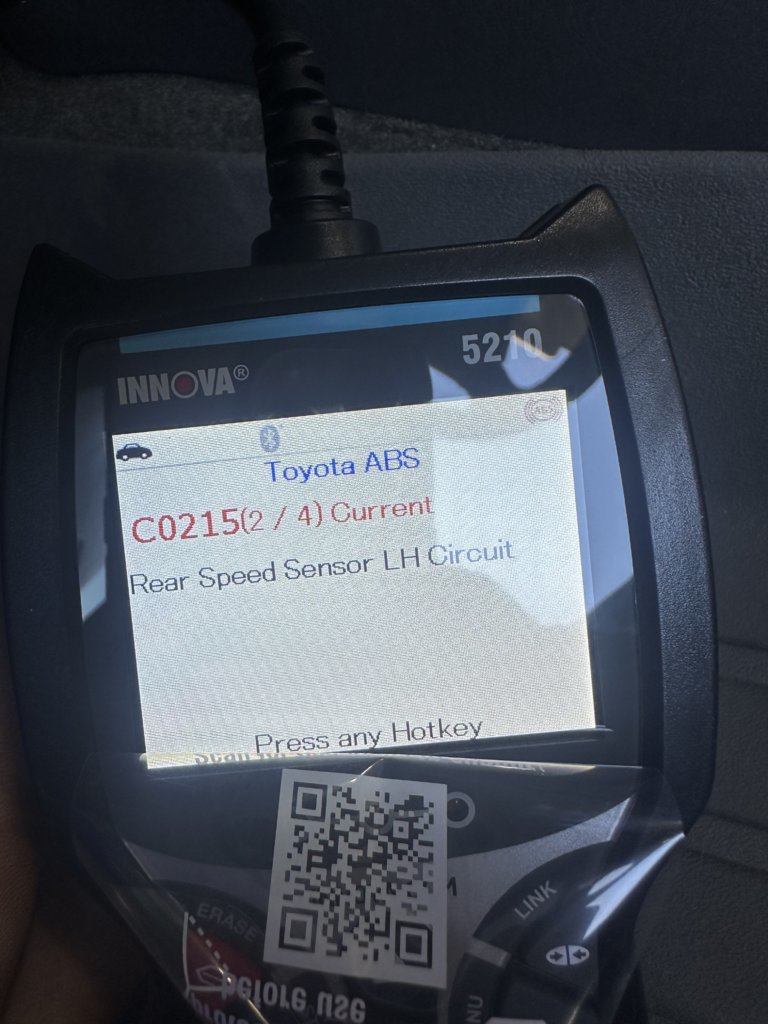

  20. May 10, 2025 at 7:00 PM
    Stock63
    Stock63 New Member
    Jan 8, 2024
    #109885
    201
    2005 Tundra DC 4WD
    My Speedo still works, I have a abs light on and it’s not Christmas anymore. It bugs me lol
  21. May 10, 2025 at 7:01 PM
    Sirfive
    Jan 24, 2021
    #58078
    5,550
    SATX
    ‘02 Limited AC TRD
    Bassani cat-back
    Wheel speed sensors?
  22. May 10, 2025 at 7:04 PM
    shifty`
    shifty` You can call 1 (800) PP5-1-DooDoo
    Jun 20, 2020
    #48239
    30,858
    ATL
    '06 AC Limited V8/4WD
    Yeah, they typically make solid stuff and have good QC.
  23. May 10, 2025 at 7:04 PM
    Stock63
    Stock63 New Member
    Jan 8, 2024
    #109885
    201
    2005 Tundra DC 4WD
    idk I haven’t done too much research on it and I’ve heard about people installing them wrong
  24. May 10, 2025 at 7:05 PM
    shifty`
    Jun 20, 2020
    #48239
    30,858
    ATL
    Yeah, blue, not OEM.
  25. May 10, 2025 at 7:05 PM
    shifty`
    Jun 20, 2020
    #48239
    30,858
    ATL
    How many times in your ownership will you ever replace one?
  26. May 10, 2025 at 7:07 PM
    shifty`
    Jun 20, 2020
    #48239
    30,858
    ATL
    Why not just pull the sensor and clean the metal bits off the magnet?
    FrenchToasty likes this.
  27. May 10, 2025 at 7:07 PM
    Stock63
    Stock63 New Member
    Jan 8, 2024
    #109885
    201
    2005 Tundra DC 4WD
    Hopefully once
  28. May 10, 2025 at 7:08 PM
    shifty`
    Jun 20, 2020
    #48239
    30,858
    ATL
    You can always go to a JY and buy used.
  29. May 10, 2025 at 7:08 PM
    Stock63
    Stock63 New Member
    Jan 8, 2024
    #109885
    201
    2005 Tundra DC 4WD
    I replaced the front wheel hubs and cleaned both sensors, light never turned off
  30. May 10, 2025 at 7:09 PM
    Sirfive
    Jan 24, 2021
    #58078
    5,550
    SATX
    ‘02 Limited AC TRD
    Bassani cat-back
    Looks like it needs to be cleaned. Might have a piece of metal or something blocking the magnets?
