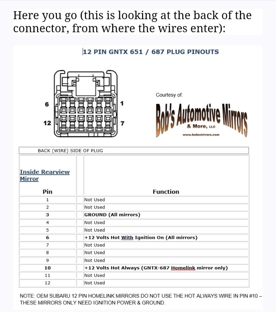

    I guess I just need wire which ever color pin 6 is to the ACC or ignition and ignore the wire for pin 10.

    I don't think mine even has it. Pretty sure it's just auto dim and compass. I just want the compass, really. The only time I dim the mirror is when some asshat behind me has their brights on, or is running HIDs in a halogen housing.

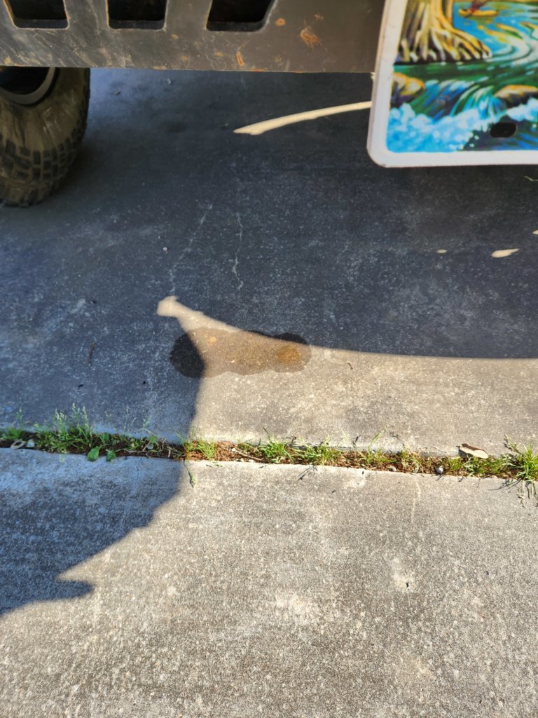

    I noticed a small puddle of coolant under Penelope after I got back from the gym this afternoon. Looks like it's coming from one of the plugs in the bottom passenger side of the radiator. I wonder if that's just an o-ring I can replace or what?

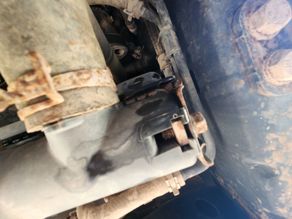

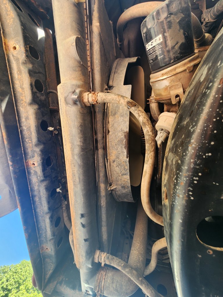

    Got some pics. Lots of places the coolant made its way onto, but I think that's from driving and the fan.
    I think the source of the leak is around here. That's about where the puddle is below.
    I'm guessing a new radiator is in my future,.but til then,. I'm open to suggestions on bandaids.

    Impossible to tell where it's leaking from those pictures. Your engine bay is the stuff of nightmares for me too. It would be easier to tell where it's leaking from if your shit didn't look like it did a few tours in Afghanistan.
    Actually, in the second picture it looks like it's leaking from higher up, then dripping down. I wouldn't want to drive it to T2S with it leaking that much.

    Is the cap to tank crimp wet here? That’s where they like to fail. Also those factory spring clamp things gave up the ghost on my truck long ago.

    I put a Gates hose in that position and replaced the stock spring clamp with a stainless screw type and had trouble getting it to not leak. Gonna put a Toyota hose on when it's delivered..

    Yeah I was kinda thinking the same thing. What's weird is I ran the engine for a few minutes and couldn't find the leak. Turned it off and went inside to eat dinner. When I came back out the puddle was fresh. The radiator and reservoir are full still.
