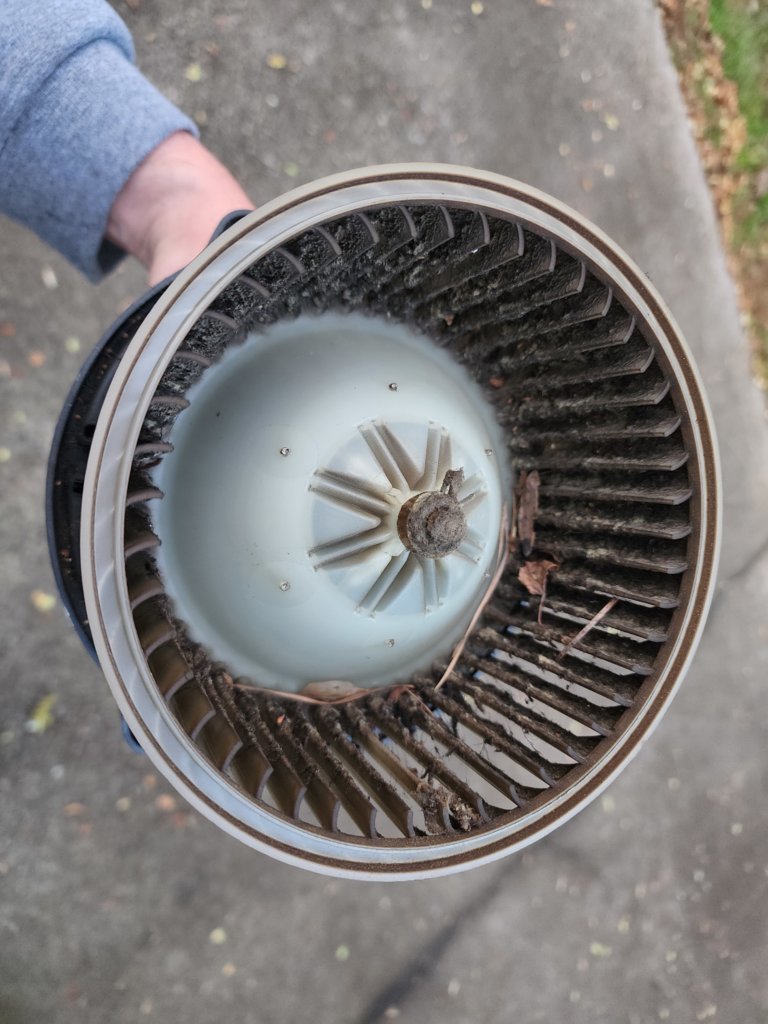

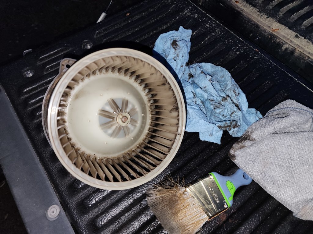

    Pulled out the blower motor to check it out. No particular reason, but I'm glad that I did. This shit is nasty. Previous owners years of cigarette smoke caked in.
    I'm cleaning it now, but I'm definitely buying a new one. Yuck

    I'm sure it would help. For the record I have chlorine bombed this truck once and used the meguiars air refresher fogger twice. The smoke smell is still fairly present.
    That blower motor smells like an ash tray, so it has to be a pretty major culprit in retaining that smell. I cleaned it with glass cleaner then gave it, and the foam pads above, a good spray with some air freshener.

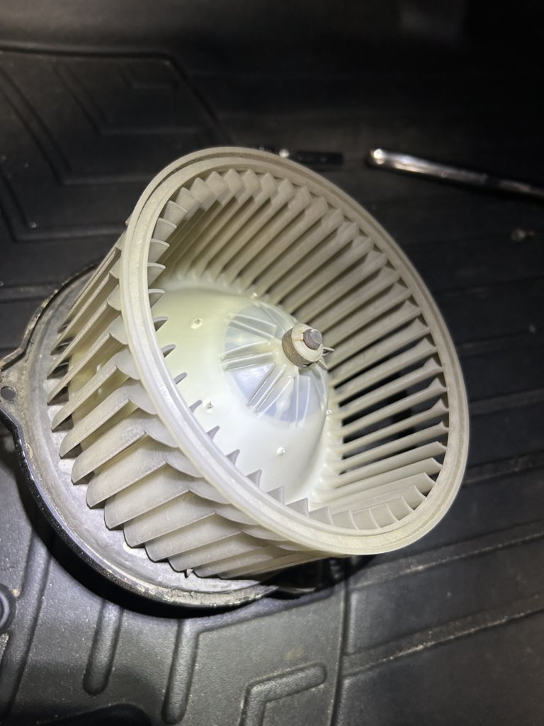

    I tried to find a way to pop the fan off of the motor, but it seems like its not removable. I wanted to soak it in some cleaner overnight.
    My money is tied up in more important preventative maintenance with the truck right now so a replacement will have to wait for just a bit on the blower motor.

    That’s how I ruined my OEM fan motor. Trying to pop the fan off, broke the motor magnets in the process. Limped it along for a few years. Replaced with an aftermarket one. It sucked. Made weird noises and didn’t have as much air output. Replaced with new OEM this year, back to good.

    It's weird, too. It has a clamp on there like it's holding it down, but it doesn't seem like the clamp does anything. The plastic of the fan sits under the metal pin lip. I don't think there is even a way to get it off without breaking it.
    I read up on some previous posts here about the A/M ones not being too good. I'll just wait and get an OEM one. I also read about the Land Cruiser blower motor upgrade, but didn't see any updates on if it works or not.

    I feel like there’s usually an e-clip or tension clip holding the fan on, but prior comments have me double guessing that one…
    I know for a fact they sell the squirrel cage separately. But the motor isn’t that bad to replace.
