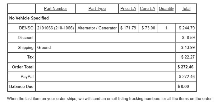

    WTF? I signed up for that notice too... No message. Hope that you gots one...

    I might've been a little earlier in the line. I dunno, I've been putting my name in the mix for probably going on 4-6 months now.

    Is that the heavy duty alternator?

    Sequoia 150A. Plug and play for our VVTi-era trucks.

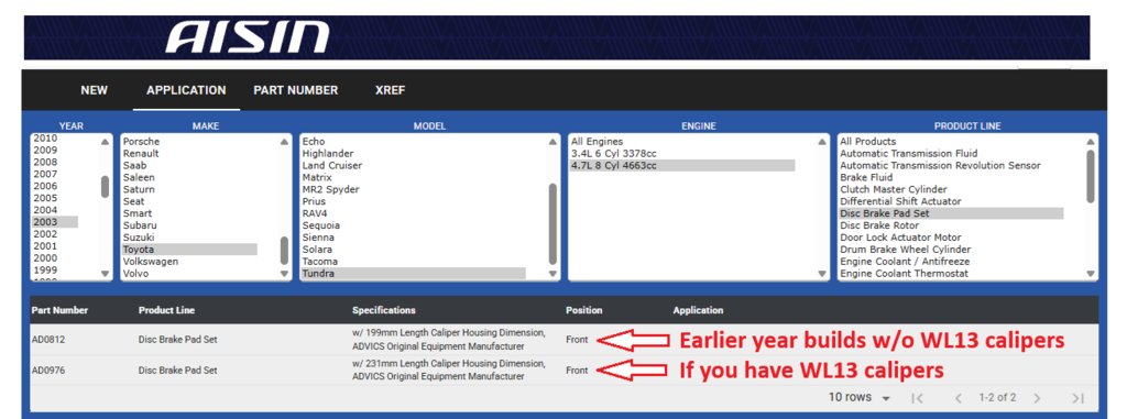

    When in doubt, consult the EPC --> https://toyota-usa.epc-data.com/tundra/
    Get the actual part number there, should be in Transmission & Chassis > FRONT DISC BRAKE CALIPER & DUST COVER.
    For my 2006, with WL13, it shows the 1st link is correct, part ending -35290 but you need to buy the shims (04945-0C030)
    What I can tell you is this: Regardless which you choose of the your three links, it appears based on pictures that neither one of them comes with the shims preinstalled. So you need to buy the shim kit, and some CRC Disc Brake Quiet, and install the shims prior to pad install.
    Me?
    For a 2003 with WL13, I'd buy the AD0976 kit below for $42+tax+ship, which includes 4 pads, pre-glued shims, new springs, and a packet of grease; everything you need to complete the job.
    Advics/Aisin made the factory pads, rotors, and wheel cylinders. Here are the two pad kits for our 1st gen trucks.

    04464-35290 are the OE pads for the larger calipers. Very good. Yes there is more cost, but these give a better brake pedal feel.
    04465-AZ200 are the TCMC Value pads for larger caliper. Likely same as Advics AD0976 but without the shims. These cost a little less and are typically what the dealer uses for non-warranty work.
    04465-0C012 are the OE pads for 2000-2002 with smaller calipers.
    I prefer installing the 35290 pads and new shims when possible. Nothing wrong with the Advics AD0976 pads, especially for the money. The Advics single layer shims are not as good as the two layer OE Toyota shims. Through multiple sets and installs, I haven’t found the Advics shims to be glued on, only clipped.

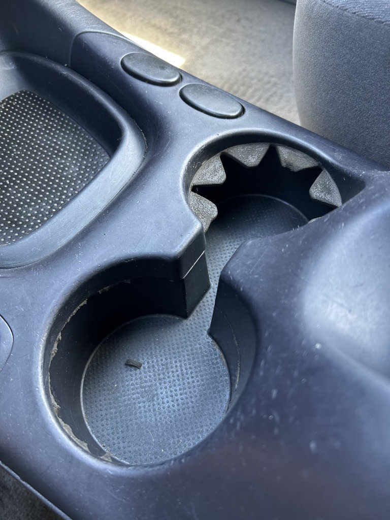

    Anyone know where I can get new cup holder foam spikes? They are falling apart and like a scab I couldn't resist picking at them.

    I think blackmamba did that, or tx tundra, one of the dallas guys.

    If you have a 3D printer, (maybe @FiatRunner ?) one of our members has a drawing to print them out.
    I got mine off fleaBay. There are two major vendors for it. One of the cheapies will fade to purple pretty quick. I can dig up my auction link from when I bought them. But I just ended up replacing my entire cupholder, since it was cheap enough and I was upgrading to woodgrain anyway.
