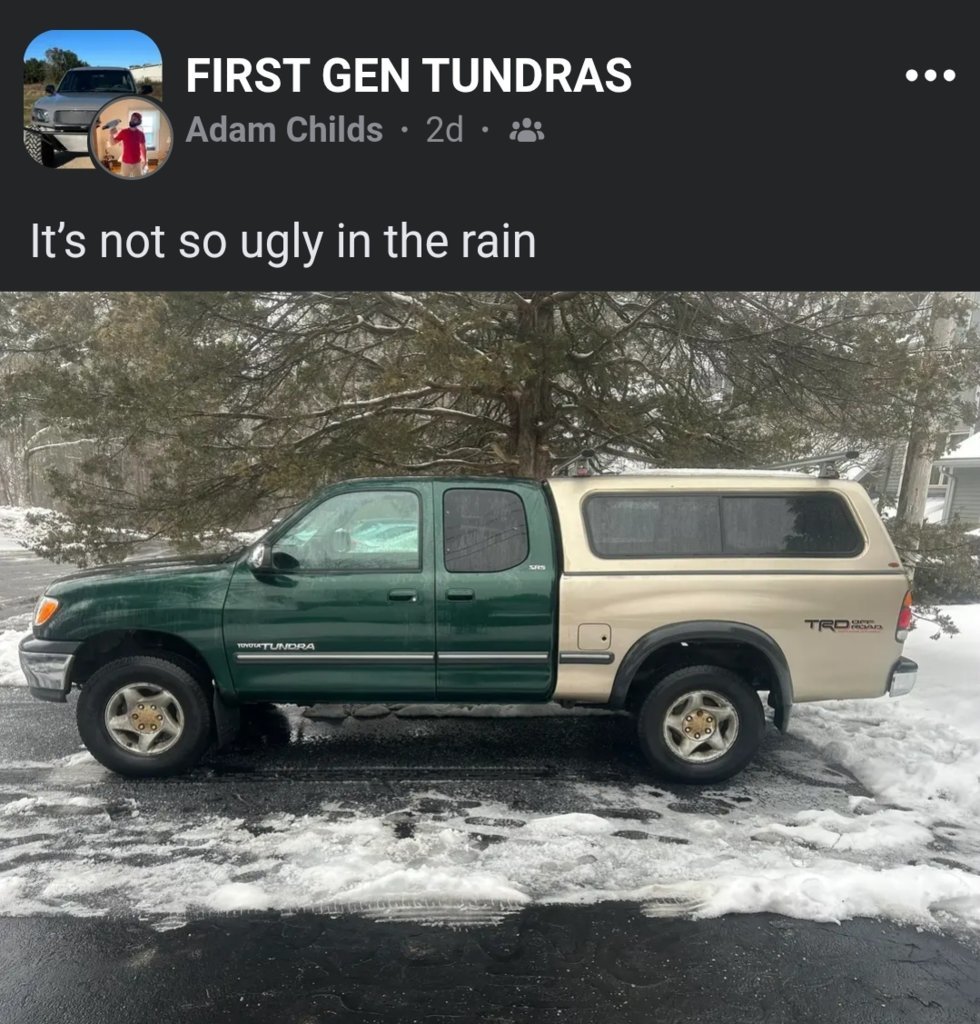

  3. Feb 14, 2025 at 8:12 PM
    BroHon

    Don't lie, we all saw your OCD door panel fiasco. I say flip a coin. Speaking of which, what happened to those door panels?

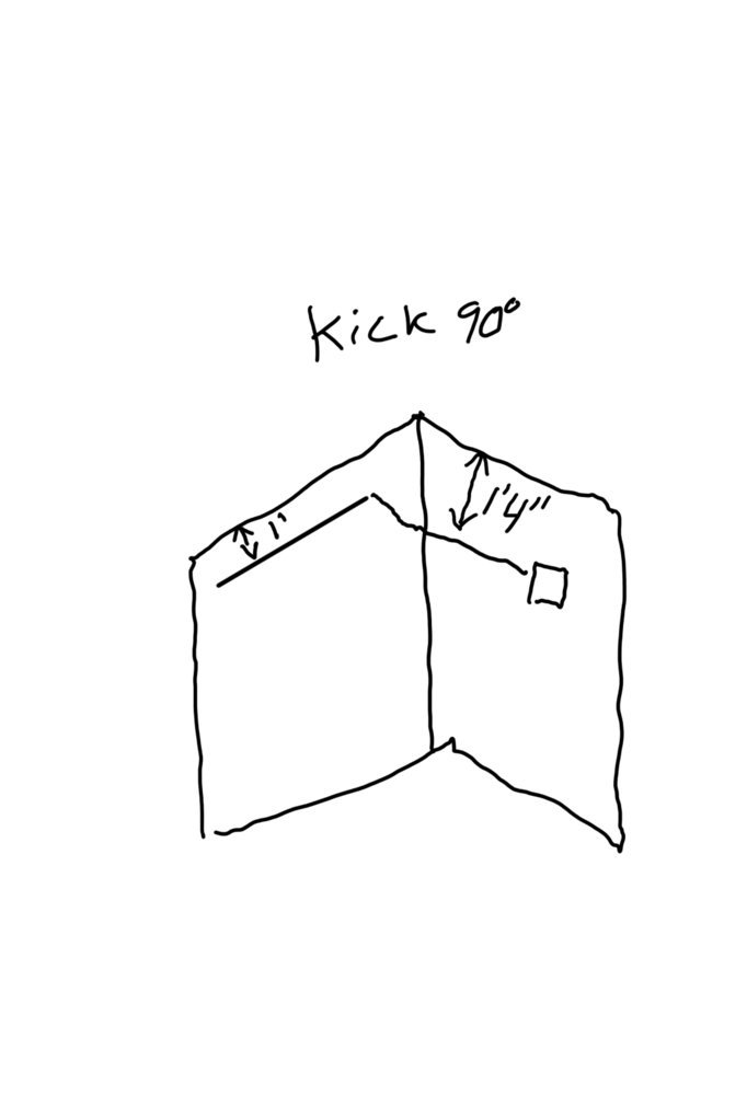

    I fully plan on teaching the math and trigonometry behind bending. Most people don't even know that. We have one particular bend called a kick 90. Let's say you need to to make a 90° bend, but drop 4" as well to hit a box. Most people will bend the 90, then hold a tape on the pipe and pull the 90 up to get 4". Well, if you do the math you can put a 30° kick in there by coming back 8" and bending on the 30° notch. I've never met anyone who does it that way. I've seen so much shit that people don't know. I'm hoping I can make a difference and teach these little shits something.

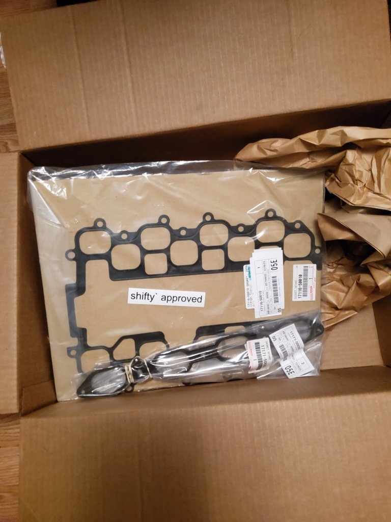

    Starter acted up yesterday. Looks like I'm goin into surgery soon. Getting my parts ordered today. DesertDog gave me a parts list and some of this stuff I'm not sure I need...
    Looks like stay away from felpro on the intakes and go OEM. Debating on the plenum... what's your opinion on that?

    Felpro is ok. I went oem because I wanted to make absolutely sure they were good this time.

    I drew a picture of a kick 90 for reference.

    The forbidden two tone :rofl:
    I don't hate it...

    Just needs to ditch those gay patricks :p

    The two tone line just need to have a little angle to it

    But still looks like a truck trying to drive out from inside another truck…

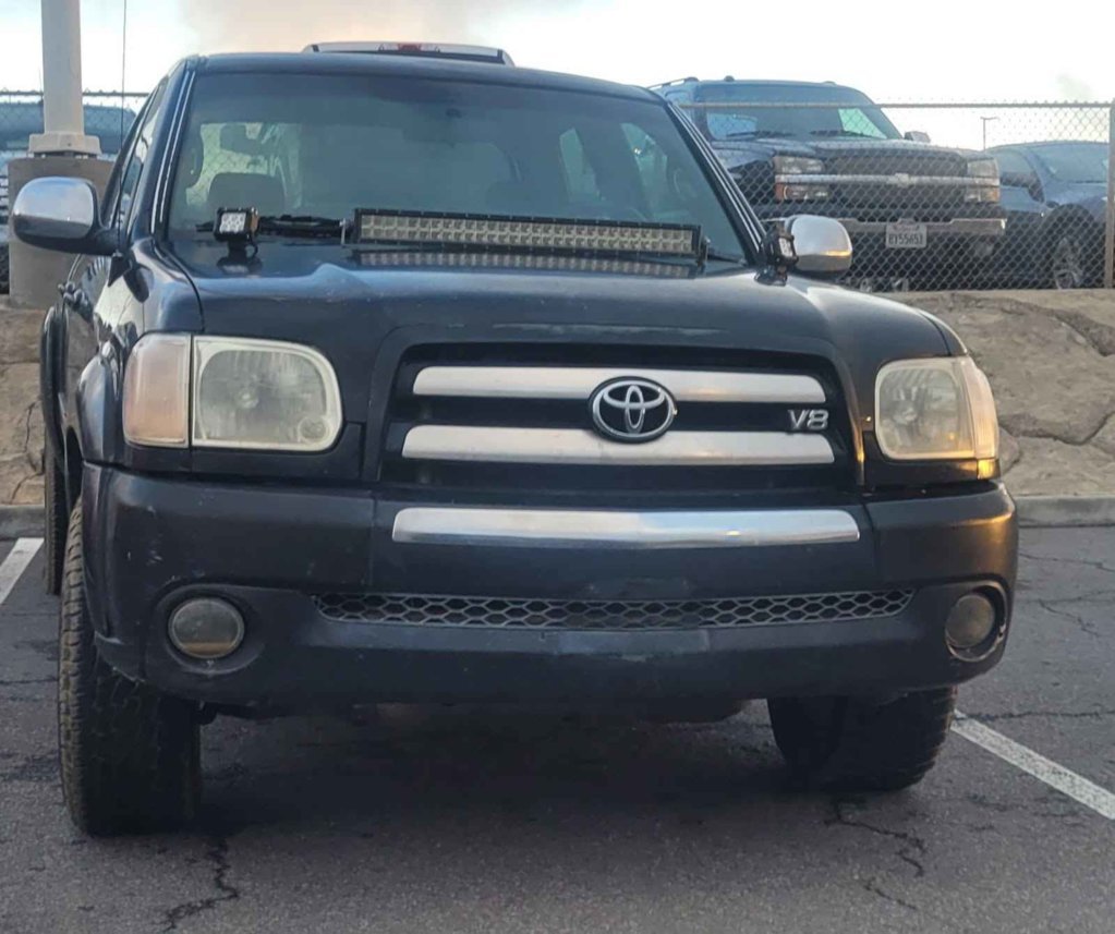

    What a special sight, the rarely spotted hood mounted light bar plus ditch lights pointed to the sky

    don't forget the swamp inside the passenger side fog light. Guess they're saving that to drink later.

    Don't hate. This shit looks gooooood.
