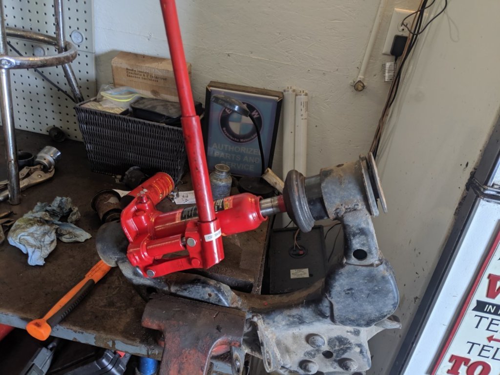

    I was thinking of using this method:
    If that doesn't work I'll probably just buy new assemblies.

    They may bend the arms doing it that way. I recall someone somewhere saying something about using that method. If I find the conversation, I’ll post it later.
    I would definitely invest in the 20-ton press and plates needed because it’s only a matter of time before wheel bearings are going to get replaced.

    Exactly this. Direct-pressing on the sleeve won't deform the sleeve. Wedging a jack in the arms will push the arms apart.

    Only looking at the picture, not the video, it appears he has a steel plate bolted to the core of the LCA, which would help with that part not stretching. I still wouldn't trust it. I've bent large cast iron C-clamps with less force than that jack would generate. I wouldn't do it.

    I’m still going to give it a try, just because new bushings are so much cheaper. If it doesn’t work- then I’ll get new arms.
    I’ll measure the distance between the bushings accurately beforehand, and keep measuring while trying to pop them out. I think if I do what that guy did, and keep consistent pressure on the bushings while applying heat, then it can work. Not going to go ham with the bottle jack.
    The cost difference between new bushings and new assemblies is big enough that it’s worth the risk to me. If I tweak the LCA, I’ll get a new one, but right now I’m making $100/week. Don’t want to spend a lot of money if I don’t have to. Plus I’ll document it thoroughly and be a guinea pig for the rest of us.
