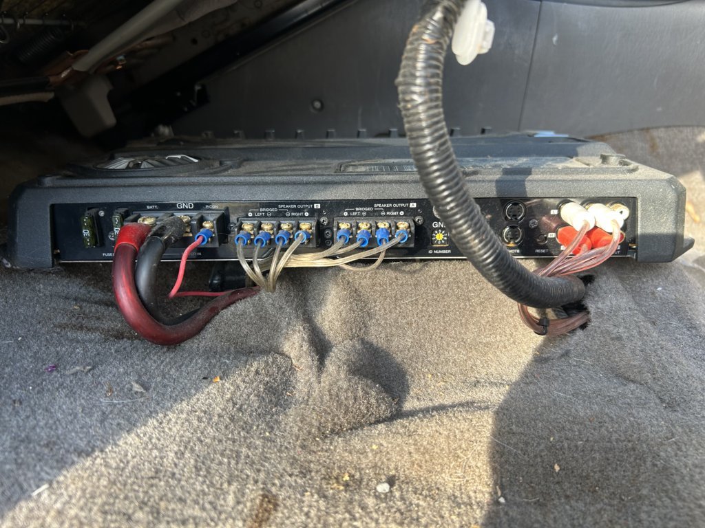

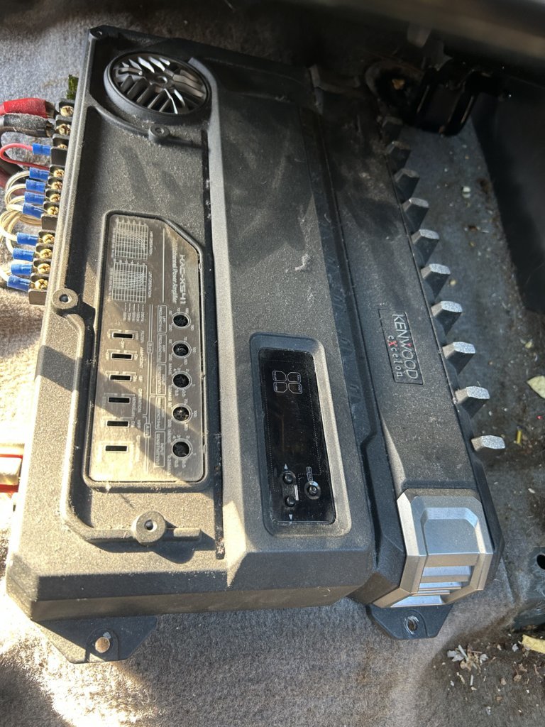

    That amp isn't working? What's the goal?

    The amp doesn’t work. The goal is to have a radio that works.

    Install a new amp there?

    Don’t really see the need to spend money on an amp. I’m cool with a radio and speakers. My radio has a decent built in amp

    Depending on how they went about adding that amp, replacing it with a working one may be your path of least resistance.

    That is true. This went to a weekend project now.

    That's a really nice amp, hopefully you can get it to work. Dumb question but have you checked if the amp has a fuse?

    Check the 30A fuses to make sure neither popped - this may be a simple solution.
    Likewise, check the power cable coming off the battery. It should have an inline fuse too. It might have popped ... it happens.
    Either may be a quick and easily solution to get working again with little to no work.
    If not, everything you need to make yourself whole is right there. Given the specs on your amp, 4 channels, 88w per channel, there are a shitload of great options, and you clearly have a beefy power and ground there, so 99% of the hard work is already done for you, and this is an awesome opportunity to upgrade to a 5-channel amp and add a small sub!
    I see the previous owner ran their own speaker wiring, so you'd want to look if you see similar speaker wire at the factory amp on the back wall, driver's side. If not, or there is no amp, I'd pop off my passenger side kick panel and look for those wires going into the door grommet, it'll be blatantly obvious.
    I personally love JL Audio but I can't possibly expect anyone to pay that pricepoint. If you want something in the ballpark of power that adds sub option with all the crossover flexibility (take a clear pic of current crossover settings, all the dials and switches before uninstall):
    I didn't run the numbers on those to check dimensions, just basic specs. I can't vouch for the Kenwood, but everything else up there will do you right and will be good quality.
    Here's the thing: They've already run the RCA cables. They're run power and ground. They've run speaker leads. That gives you two options:
    1. Do a hell of a lot of unwiring to reverse all that stuff, then install whatever you need to get whole again (minus the amp), including pulling out all that power/ground wherever it may go.
    2. Mark your wires and photo of the amp settings, pop off the negative battery cable, uninstall the amp, install existing wires to new amp, and you're in business.

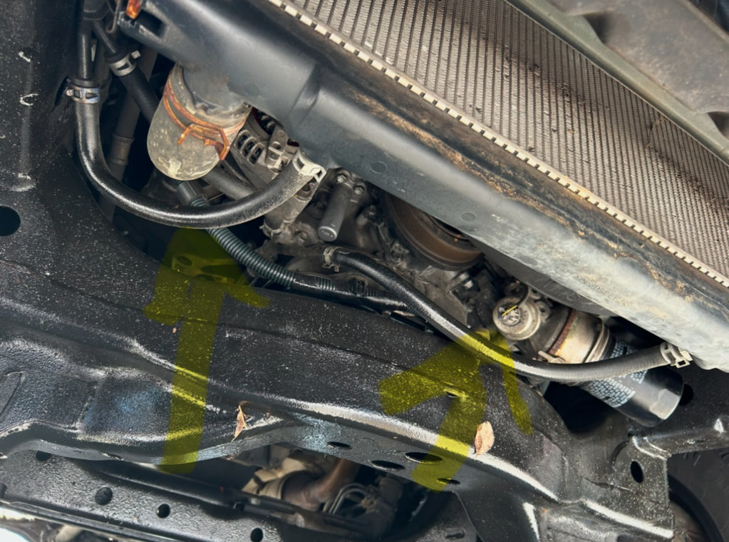

    Anyone know what the two transmission lines running to the bottom of the radiator are called? Or a pn?

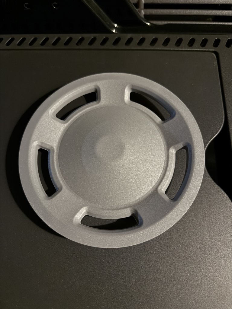

    gonna pick up some paint tomorrow, what color should i paint the ‘hubcaps’?
