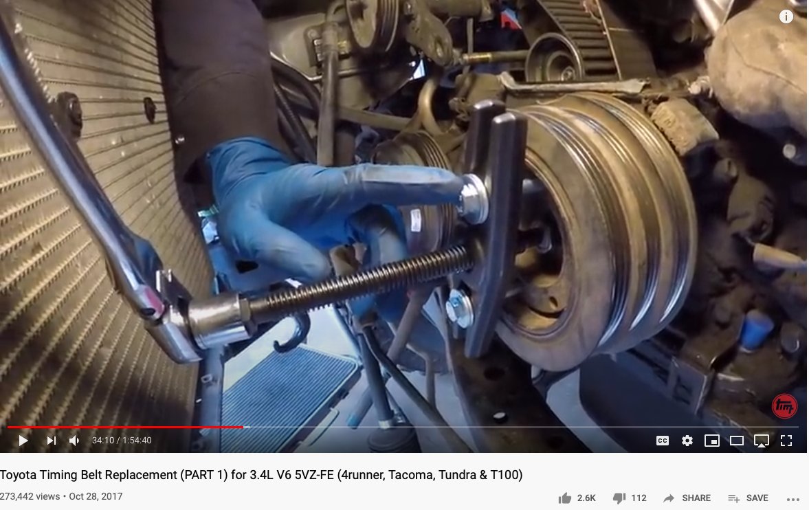

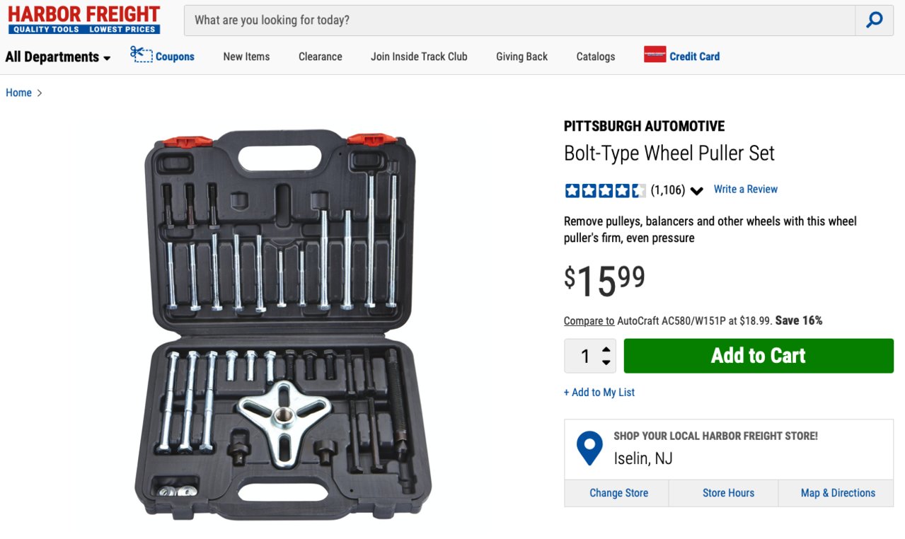

    Any reccos on the pulley puller?
    How about the fan clutch puller? I want to replace this and understand there is a special tool for this job, as well.

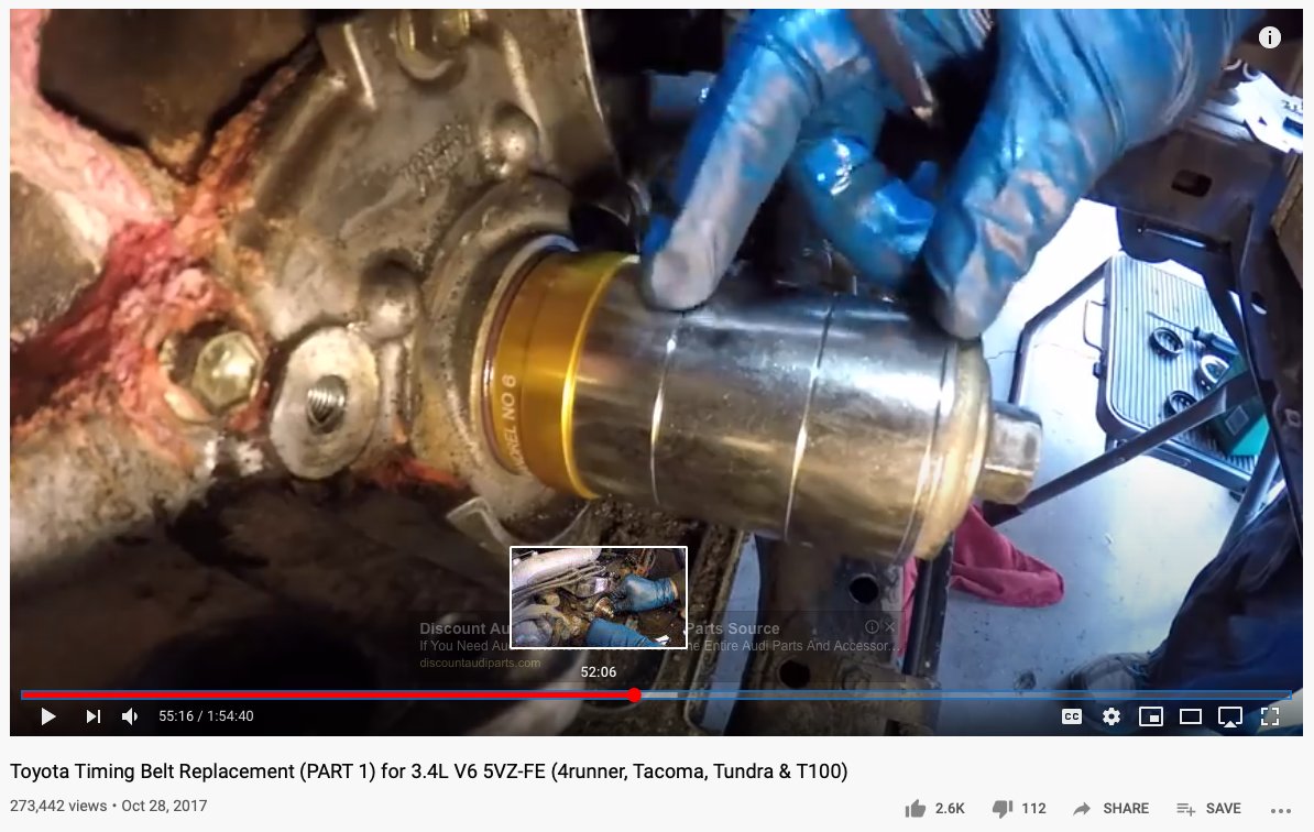

    Are you also looking to change the crankshaft and camshaft seals? I cringe having to shell out $100 for the install kit with the stacking rings:

    Yes. I’ll be replacing both Cam Seals and the one Crank Seal. From the one youtubes vid I watched on this topic, the mechanic didn’t use a special tool for the install. Think he used a PVC type fitting and made sure he tapped it flush.
    To remove the seals, he had a Lisle Seal Puller (brand new for vid) but chucked it in lieu of using a large nail and pried them out. He looked to be a pro mechanic with a shop. The 4.7L was pulled out and on an engine holder device.

    I was thinking of custom 3D printed sleeves that would be better than the PVC pipe, but I can't find any freely downloadable designs. I'd offer to print them up for free if anyone here can design them or grab free designs to download.
    Hmm, nail trick is interesting. I have that Lisle tool sitting in my Amazon cart.

    Yeah. Something custom would work. I’ll need to watch that video again. It was Part 1 of 3 in a Series. Didn’t watch the others yet. I’m wondering if using the old seal as a backer combo’d up with the PVC fitting would work with pounding it in. For some reason, I don’t remember it being that difficult to install.

    I don't think it's hard to install the new seal, but you want to avoid ruining it or creating gaps if doesn't go in squarely. Those tools seem excessive. Even Timmy ended up hammering in the crank seal.

    I used a pvc coupling on my rear axle seals. They work good. As for using the old seal, it might be hard trying to get it, the new seal, a coupling, and a hammer all lined up with only two (golden) hands in that tight space. Unless you're pulling the radiator too.....

    This must be the video you are referring to. He used a nail punch to puncture the large rubber flappy part of the camshaft seal and pull it out. I didn't realize our V8's seals don't resemble typical camshaft/crankshaft seals. I suppose you can use a spring hook to do that.
    To install the seals, he just used some special yota seal compound and used his hands to push them in, lol.
    I also saw that he used a special harmonic balancer / pulley tool to extract the crankshaft wheel. "usually a brass hammer with light tapping will get it out, but this one is stuck"

    Yep. Thats the vid. Looks straight forward on the Seals remove/install. The punch/pry worked really nice versus the Special Puller that he had flopping around.

    Looks like this will do the trick?
