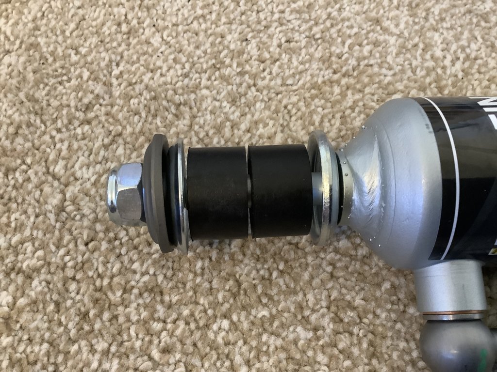

    6112s up front w/ 650 lb springs, 5160s in the rear, JBA UCAs, Suspension Maxx Links, ATS leafs w/ Wheeler's AAL and overload spring, Toyota Gloss Gunmetal TRD Wheels, Toyo Open Country AT3s 275/70/17
    Hey guys. I was gonna try to install my 5160s today, but I can’t get the bilstein install instructions to open. The only thing I’m really trying to figure out is the install sequence of the washers and rubber bushings. Below is a picture. From left to right I’ve got locknut, thick raw steel finish looking cupped washer, thin zinc cupped washer, 2x rubber bushings, thick zinc cupped washer. Anybody know the install order for these? Am I close?IMG_0392.jpg

    @shifty` has a stack up drawing he can post. There might be a reference to it in the mega thread. I think it may be the 5100s though but I would assume it’s similar.

    Yeah I just checked the 5100 install instructions and it’s just lawyer bs. Here’s the photo from the website. Seems like maybe the correct order. Looks like the frame mount would probably go above the thin zinc bushing and below the upper rubber bushing?? IMG_0393.jpg

    Being that I just installed 5100s like last week, I can tell you that the kit will come with three metal washers and two rubber spacers. The oddball washer is turned upside down to cup towards the strut then there is a washer that’s turned upwards then a rubber grommet. After that you put it through the housing. Next comes the other grommet followed by the washer turned upside down and then the nut. The torque spec at the top I believe is 15 and the bottom is 67 if I remember correctly
