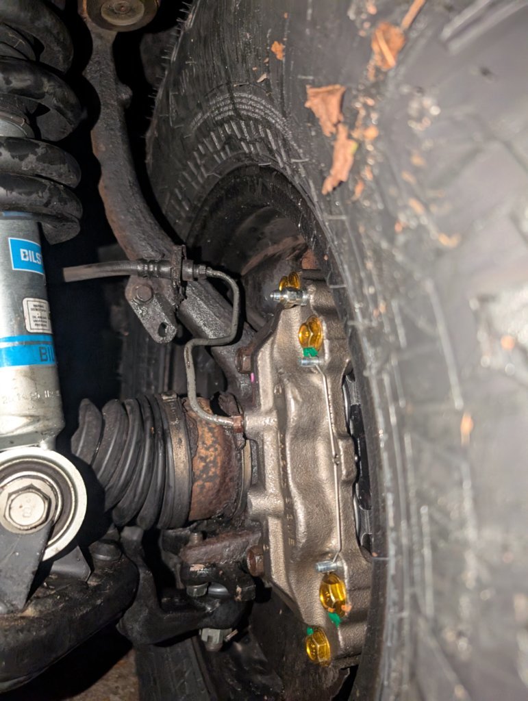

  1. Dec 13, 2024 at 3:06 PM
    BroHon

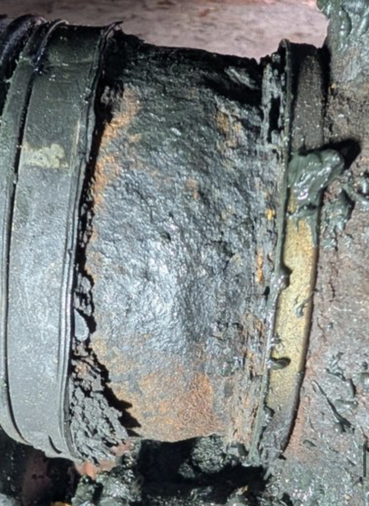

    Don't think I've ever seen a CVaxle rust clean through, but that's what it looks like, holy shite. There is no strap on there. Being held in place by hopes and dreams.
    Nice new frame.

    The metal strap on the outer boot is still there and tight down on well whatever it's tight down on.
    From what you're saying I'm assuming the strap should be further up the hub? If so wow is that bad news
    Edit:
    The flash helps highlight the strap location

    looked like rubber in the first pic. i didnt zoom, my bad.

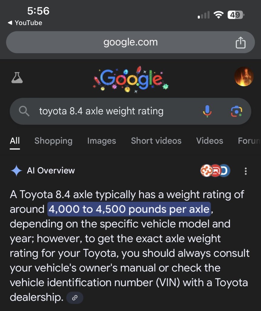

    according to the all-knowing, we have 2 ton axles.
    455h0le_dachshund and JakeJake like this.

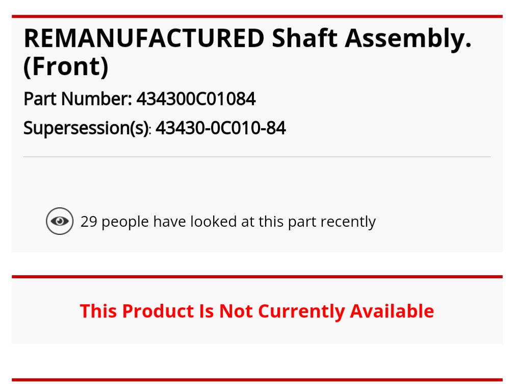

    Doing some research on CVs did Toyota stop doing the remans on 1st gens?
    Looking like part#434300C010 is what I need. I'm finding them for $370 per from Lakeland Toyota but I wasn't sure if anyone's had had any luck with finding those $85-$100 remand CVs lately
    I may have answered my own question.

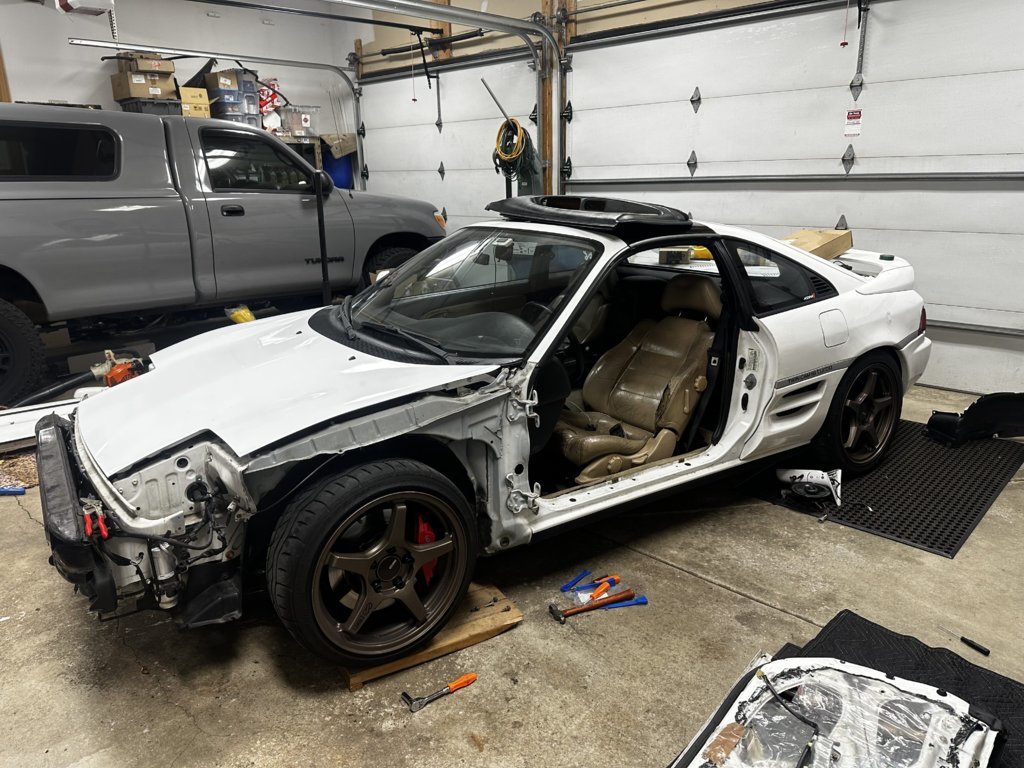

    Yea.. I spent my day stripping mine apart to fix the deer damage
    Just waiting for a friend to stop by and help get the doors off and swapped around and start setting gaps

    Remans are disco’d.

    Alright folks, hopefully the last question on the CV front.
    With reman OEM CVs unavailable I've come to the following COAs
    1. Bight the bullet and get new OEMs at a total cost of about $900. Have the truck out of commission for a few weeks while I wait for them to arrive from Lakeland Toyota.
    2. Go with an aftermarket CV (Carquest Premium [Which seems to be rebranded GSPs], or Import Direct which seem to be the same as the NAPA CVs) If there's any recommendations on readily available parts store CVs I'm all ears. This would let me get the truck back on the road tomorrow as its my daily driver.
    3. COA 2 plus a rebuild kit for the OEMs currently on the truck to allow me have them as spares for when the aftermarket ones inevitably fail.
    I'm leaning towards #3 as its significantly less cost and gets me back on the road before the weekend is up. However, if just going right away for new OEMs is significantly better I can just bare the cost and the wait times and drive my old TJ for a few weeks.
    Thank you for all the advice!

    I ended up going with a mixture of COA 1 and 2. I picked up the GSP rebranded axles this morning from advance with new seals for about $240 all in.
    I figured this gets me back on the road with peace of mind quicker while I look for the best deal on OEMs. It also lets me do the job once with cheap parts so I'll know what I'm getting into once I get the OEMs. I know I'm kicking the can down the road by maybe a year or two but I think that works out for me.

    Make sure you put the old axle side by side with the new, and verify there's nothing you need to swap over (seals, etc.)
    I saw some on here bitching about that with the NAPA axles.

    I went ahead and grabbed new dust seals for all four corners. Hopefully I got everything I need!

    So I'm about halfway through the job. On the passenger side the inside seal is a different size than the drivers. It's a NOK 5321E instead of the 5320E on the driver's side.
    Does anyone know of the National seals equivalent for that? My cross reference websites haven't found one. What do you all usually get for that seal?
    Edit: For anyone wondering in the future the National pn is: 710595
