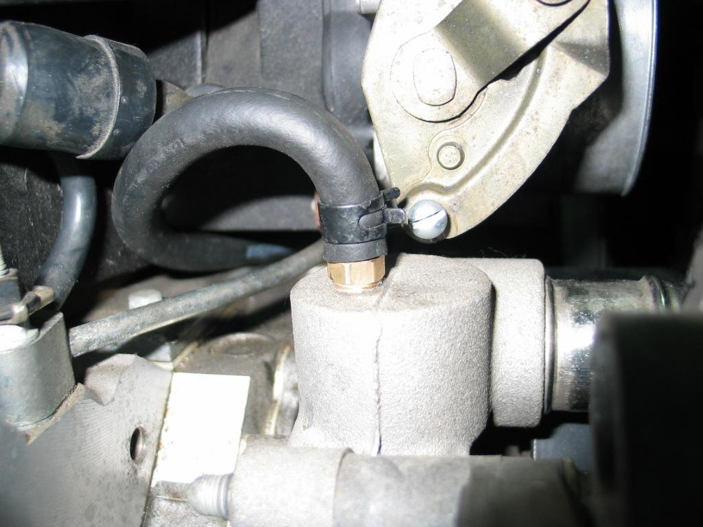

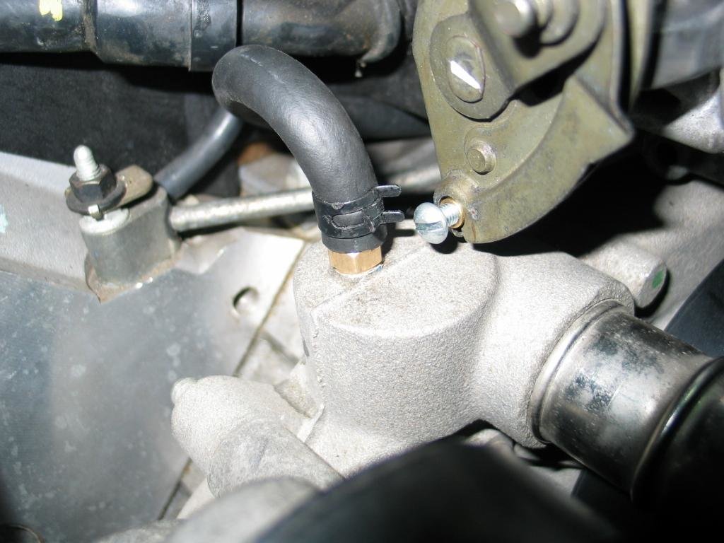

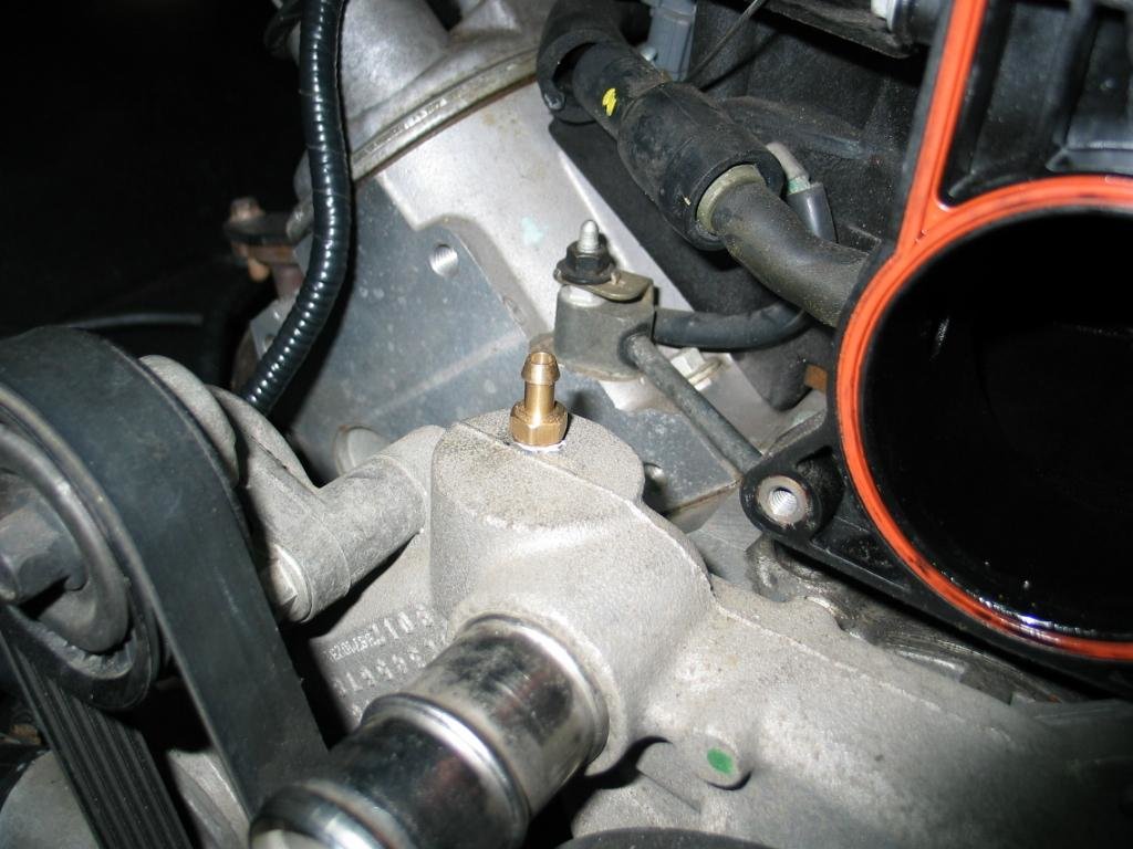

    Ok, got curious and went back to my LS swap thread on the C10 from almost 20 years ago to find TB bypass pics on the LS/GenIII. Pics are so damn small there (thanks, early 2000s internet!) so you can't really tell, but bigger pics below ... but basically drill, tap, then re-route. Also, super high-tech heater core bypass, we don't need no stinkin' heat! :rofl:
    More work on the LS though, unless you use the (less clean looking) shortcut off the radiator line with a Mishimoto fitting and aftermarket barb (I think Russell is what most folks run with). And yes, I vacuumed my shit excessively during/after, and deburred my holes.
    tl;dr - We're lucky the 2UZ is easier.

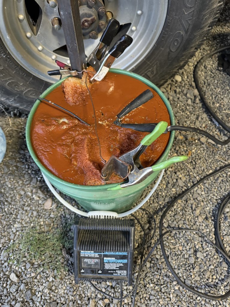

    just a little 2amp.

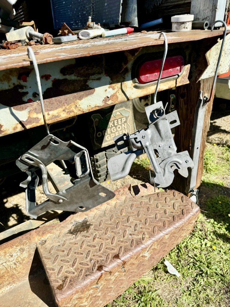

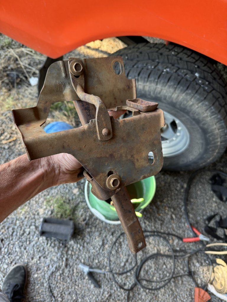

    no doubt acid will work excellent to remove rust. Also no doubt that this, and most all other how-to “informative” youtoob videos are skewed to generate “likes”. It almost as if the person who made the video went out of their way to have poor results.
