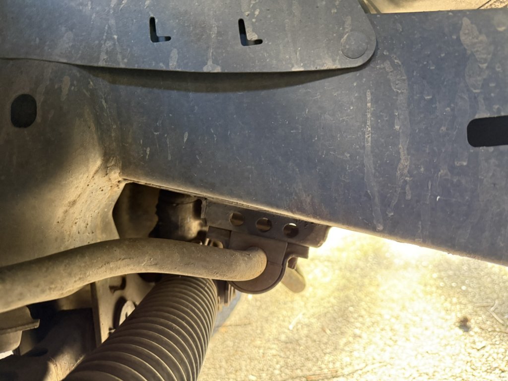

    I get it, I have 3 bikes. Lol! Just judging from the images and your description of the double-clunk, I would concentrate on upper and lower ball-joints. However, it is entirely possible it could be worn control arm bushings, as well.

    Do you have any other symptoms? Vibration at various speeds? Unsmooth turning? Anything else other than *clunk, clunk*?

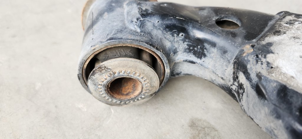

    20241211_155159.jpg Image of lower control arms replaced 9 months ago that were the cause of a lot of issues. Had ~ 200k on them. Note the near-total degradation of them that isn't visible while mounted. Not saying this is your issue, just an example.

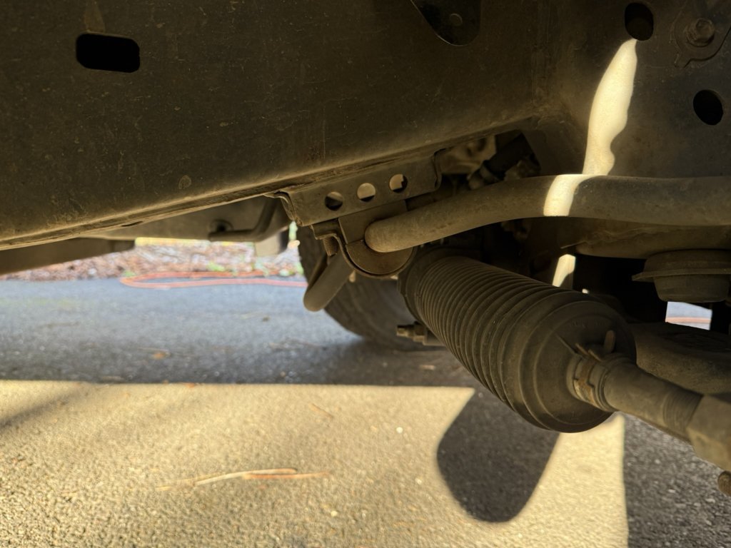

    Nope, I only noticed it today while driving with the window down and the stereo pretty low, otherwise I doubt I would have really noticed it. Haven't noticed it previously, steering feels fine, it still tracks straight, no vibrations. I've driven my buddy's first gen taco where all the bushings are shot, and it doesn't feel or sound anything like that, that thing is a death trap.
    I'll try getting a jack under it tomorrow, not gonna happen today, and see if there's any play with it up in the air.

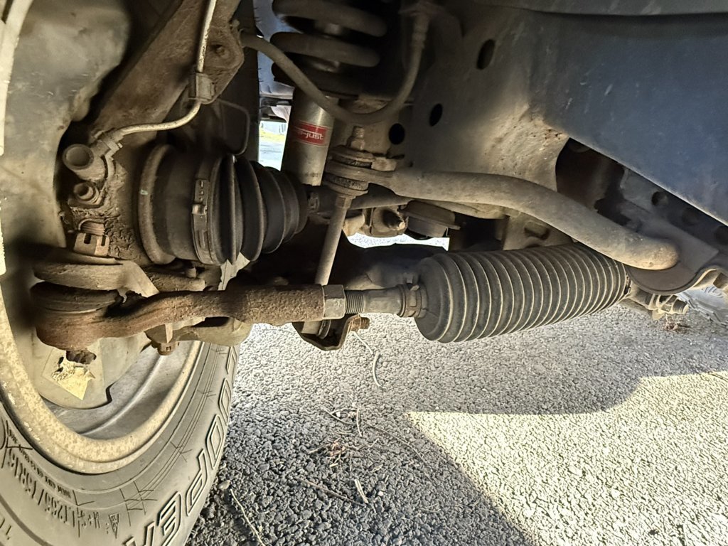

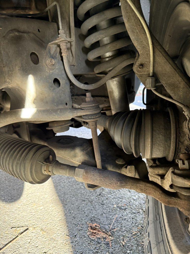

    Yes, those sway bushings are fucked and also way over-tightened.
    If you're 100% positive it's coming from the front, and you're positive it's not the LBJs, the other biggies that would cause this I'd be looking at are:
    • Lower shock mount bushings: Make sure they didn't blow out.
    • Steering rack bushings: Inspect those, see if anything is clearly blown.
    • Upper/lower control arm bushings: Not so easy to check the lowers, but a prybar wedged in the right place and pushed up/down can check for play on LCA, maybe on UCA but UCA bushing quality may be visible as-is
    Consider jacking up the car on one side until the tire is 1" off the ground. Tuck a prybar under it and watch the LBJ and LCA for play as you lift and drop the tire 1"-2". Then throw your stock bottle jack under the LCA until it engages and lifts at least an inch, so the LCA is under tension. Repeat.
    I'd also check to make sure the little plastic round spacers are still intact between the tips of EVERY leaf in your leaf spring pack, they should be obvious ... they'd cause a clunk or hit with every flex of the spring, but that would be coming from out back (it'll also cause squeaking)

    Can't say positively for sure, I was mainly getting the clunk if going kinda fast over the speed bumps and at that point front rebound and rear compression are pretty close to each other.
    What I can say is that I was in a parking garage earlier before driving home. Window open, stereo off, nothing. Gotta have the steering at almost full lock a couple of times to get out of that parking garage and I'd hear any squeaks or groans coming from stuff in there, and it was totally silent. Then drove home with the window down and didn't hear anything. No noise when i pulled up onto the curb either to park(Narrow streets, mostly not white trash).
    I just had a sports bike on a hitch carrier on the tow hitch of my truck a few weeks back, probably 600 lbs on the hitch, and leaf springs were silent. I don't think it's anything back there.

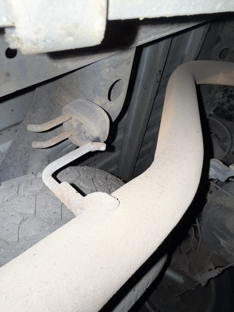

    Went back out to look under the truck tonight and I had totally forgotten about this, I need to throw a jack under the exhaust and get that back on the rubber mount. I did look around a little with a flashlight, but couldn't see any marks from it hitting. CDB00722-685D-438D-BF1E-080274C9EB3D_1_102_o.jpg

    Skip the jack. Get a ratchet strap.
    Ratchet the two post end up to the one post end and slide the rubber over the single when at the right height. Consider some lube if required, spit don’t work with cars like it does with people.
    Jacking on the exhaust could smush or dent something. Jacking on cars is also doesn’t work like jacking on people. Ain’t life grand?

    Mine did this frequently for some reason, and caused weird clunking noises that I couldn't replicate or diagnose. A small hose clamp on the end of the post fixed it.

    #9 wire.

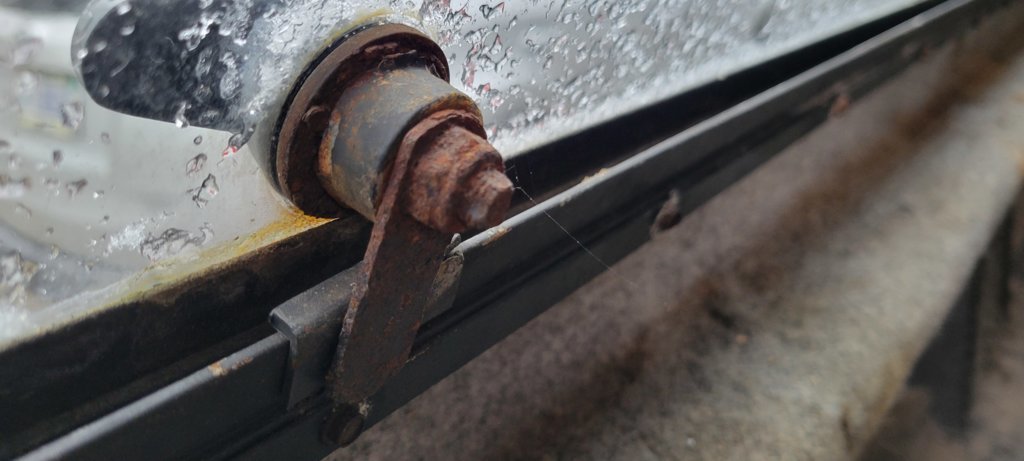

    The poor man’s rust removal is electrolysis. Google search it. I’ve used it many times with great success. Good chance that you already have everything laying around the house to make it happen.

    Haha, yup. Make our own colloidal silver and copper.
    Acid is just so much more fun... and quick and dangerous!
    Have never used Naval Jelly:notsure:
