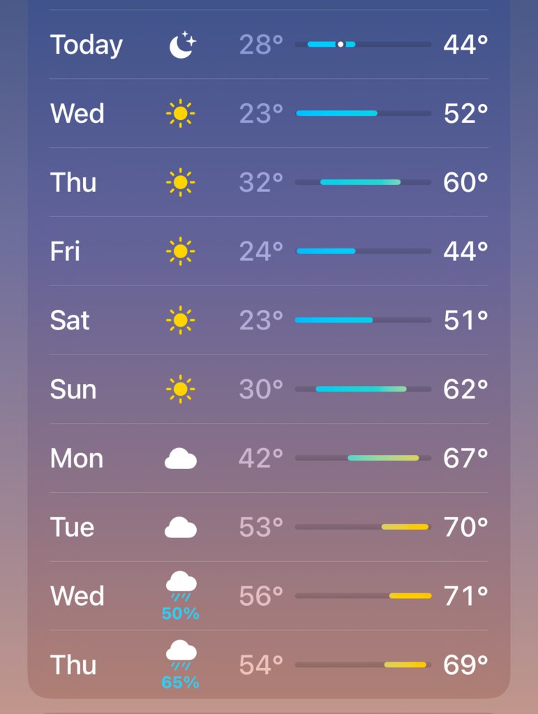

    WTF. We Southerners aren’t built for these arctic temps. Some sort of arctic blast coming over from Canadia. Too cold to work on the truck.
