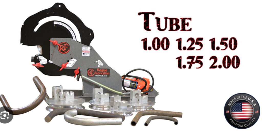

    I just took a peek at their website. They have some pretty trick fab tools. The bender you got is very nice! I bought a new JD2 bender (and 3 or 4 dies) back in 2012. I still have yet to unpack it. The reason being is that i haven’t found a good place to mount it in my shop….doh!

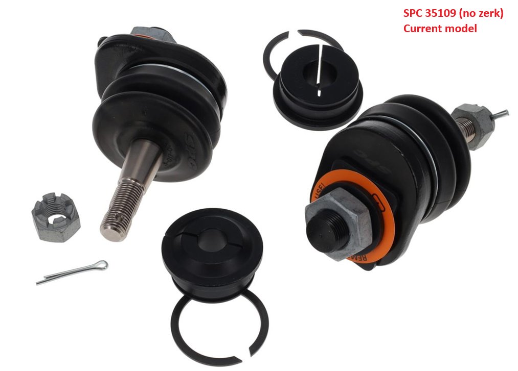

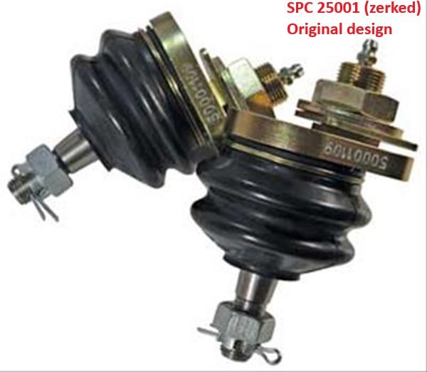

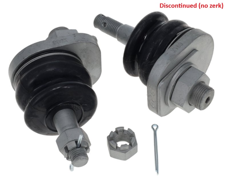

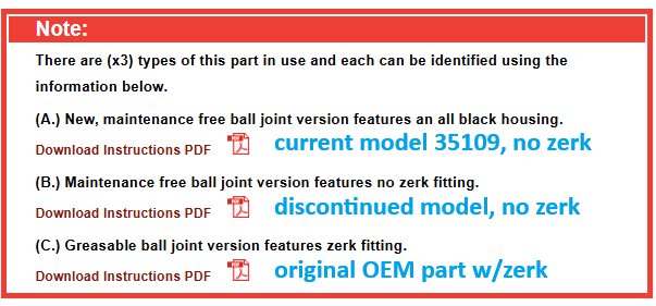

    IIRC, there are/were 3 diff't UBJ for our SPC uppers (SPC UCA p/n 25485). One greasable/zerked, which most of us probably have currently installed b/c our arms came with them preinstalled, two ungreasable/no zerk. One w/o zerk is discontinued because of some issue with an internal spring that was bothersome for inspection stations (??!).
    SPC shows that here in the red box (screencap below). And here is our current replacement option, SPC p/n 35109. The original zerked UBJ was SPC p/n 25001 and may be NLA.
    Some UBJ test info from @des2mtn here: https://www.tundras.com/posts/3658517
