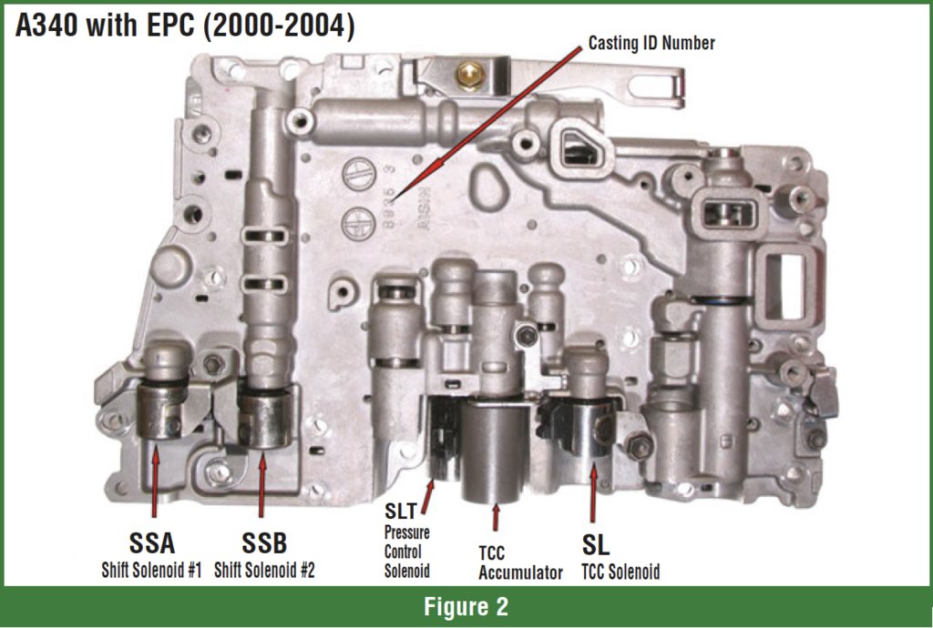

    CHECK ENGINE LIGHT CAME ON NOOOO. The code is P0770 - Shift Solenoid E Malfunction. Did some browsing through the forum, checked my tranny fluid and it was as it should be - pink and not frothy. Fluid levels are as they should be too. Truck has no issues shifting gears when driving and seems to be running exactly as it always has - perfectly. I cleared the code, drove around town for about 10 miles and it didn't come back on. Will see if it appears again - but plz no.

  17. Nov 27, 2024 at 1:38 PM
    shifty`
    Jun 20, 2020
    #48239
    29,485
    ATL
    '06 AC Limited V8/4WD
    I think that's one of the solenoids that's easily replaceable, no? But also may point to a throttle body/actuator problem? I forget.

  19. Nov 27, 2024 at 1:40 PM
    evanhmn
    evanhmn mmm chicken pot pie
    Jul 22, 2021
    #65858
    247
    State of Taxes
    2001 TRD Off-Road AC 4x4 Limited in Black
    5100/2885s, 1.5" Add-Leaf, BFF Front Bumper, 265/70/17 KO2s
    Yea, there is a thread/subforum on here that dives into it I looked over: https://www.tundras.com/threads/p0770-solenoid-e-code.132335/
    Going to see if the engine light comes back on - hoping it won't, but expecting it will. If it does, I'll swap out the solenoid. It seems like a simple process, just take the transmission pan off and you can access the solenoid.
    @Tundra2 It looks like you had this code pop up and never fixed anything. That still the case? And your first gen still running dandy?

  20. Nov 27, 2024 at 1:46 PM
    shifty`
    Jun 20, 2020
    #48239
    29,485
    ATL
    Yup, I remember that. @FiatRunner which solenoids was it you had replaced in your transmission?

    Just to add to this, looks like this ol legend was able to find the parts from a diagram to order/replace. However, I'd rather just replace the Solenoid, E, that's giving me trouble rather than them all. BUTTTT, I can't seem to figure out which part is actually Solenoid E...

    FiatRunner
    FiatRunner 2003 rich
    Nov 25, 2022
    #87321
    1,164
    Jack
    Chicago Suburbs/Milwaukee
    Yup- I had the same code, “Shift Solenoid E Malfunction”. Shift solenoid E controls the line pressure when shifting, to allow for a smooth shift. It was actually an issue with the wiring harness going to the transmission, it shorted somehow and fried the solenoid.
    It’s really interesting to me that your truck drives normally. If solenoid E actually was malfunctioning, the trans would be slamming into the next gear super hard. Like it’s got a shift kit. Mine would actually chirp the tires from 1st to 2nd. Let’s hope that it doesn’t come back.
    Here’s the solenoid locations. I believe “solenoid E” is the one labeled “SL”.

  26. Nov 27, 2024 at 10:53 PM
    evanhmn
    Jul 22, 2021
    #65858
    247
    State of Taxes
    Appreciate the info, and yea like I said the truck runs fine. I drove it again today, and after about 5 miles the light came back on but like I said, truck runs fine. Did you happen to ever get your hands on a part number for the solenoid? I've been searching all over and can't seem to find an exact answer on this...

    FiatRunner
    Nov 25, 2022
    #87321
    1,164
    Jack
    I don’t have a part number, sorry. I sent the truck to a transmission shop as diagnosing/fixing that was out of my league. It’s weird that it’s coming up after a few miles- when it happened to me, the CEL would come on as soon as it shifted from 1st to 2nd.
