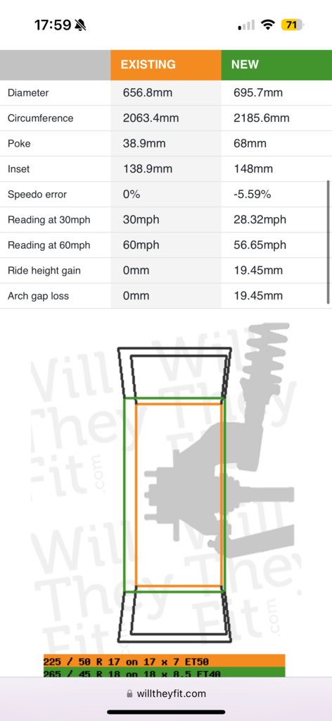

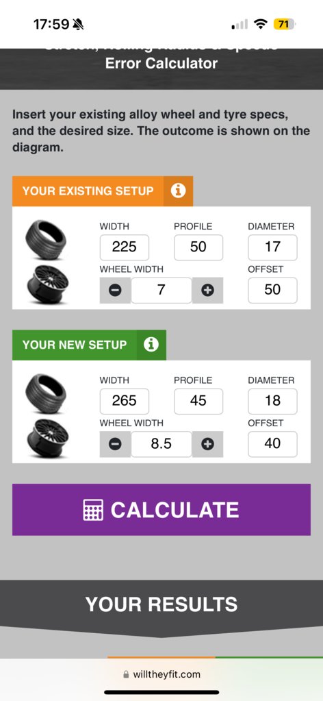

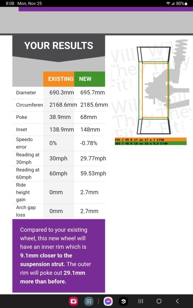

    Quick question about offset. I think I got this right, but it never hurts to ask. My factory wheels are 17x7 with a 50mm offset, 70.5mm hub bore. The wheels I'm looking at are 18x8.5 with a 40mm offset, 73mm hub bore. SO with the wheel being 1.5" wider, but 10mm less offset, they should be fine to run with just a 2.5mm hub bore adapter, right? When does back spacing come into play, or is that another word for offset? I would ask on the Vic FB page, but they don't know shit. I've asked if they would fit before and got 0 answers.
    Also, the consensus seems to be that 265/45/18 should be OK to run on an 8.5" wheel. The next size up is a 9.5" wheel, at the added cost of $260, but that may be too wide.

    So the 18's are 40mm wider and the 10mm offset difference means 10mm of that width is added to the inside of the wheel, and 30mm is added to the outside? Am i right?

    I visually see the outer ring of the wheel move inwards for positive offset. And outwards for negative offset.

    It looks like it'll take up 9mm on the inside, and push out 29mm more. I need less offset.

    Willtheyfit.com is a good website with visuals to show you the wheels and tires side by side for comparison to make it easier to understand if you need.

  18. Nov 25, 2024 at 6:11 PM
    bmf4069
    Sep 1, 2018
    #18880
    9,652
    Beau
    TX
    02 AC sr5 4wd v8
    Yeah, that may stick out too much. I'll have to measure to be sure, but that's a tad more than 2" poke on the outside.
