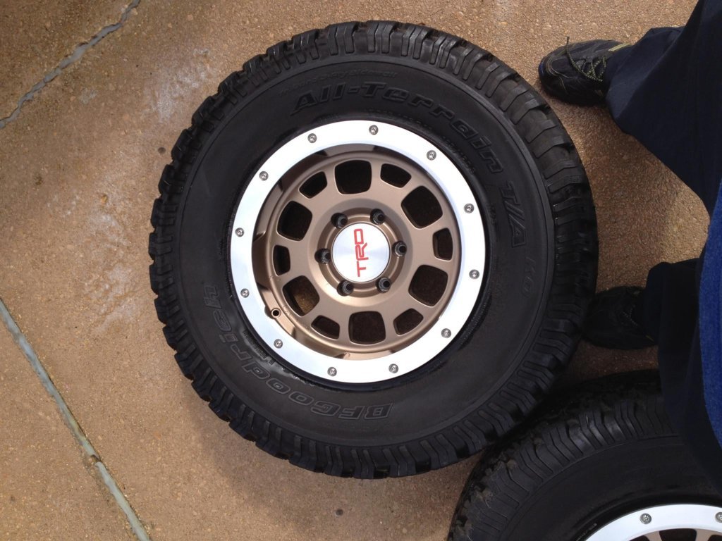

    They are $320 a piece brand new from Toyota and appear to still be available. Those are my faves. They are $2200 a set on fleabay
    Desert Dog likes this.

  5. Nov 21, 2024 at 11:48 AM
    easleycrawler
    Nov 12, 2016
    #5176
    9,717
    Travis
    Easley, South Carolina
    17 Tundra SR5 DC Black 5.7
    FN WHEELS makes them in 17". Black, grey and bronze.

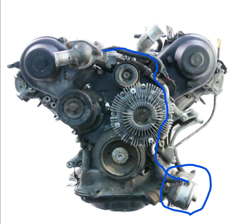

  12. Nov 21, 2024 at 12:01 PM
    FiatRunner
    FiatRunner 2003 rich
    Nov 25, 2022
    #87321
    1,123
    Jack
    Chicago Suburbs/Milwaukee
    It's what the oil filter screws onto. It's got two small coolant lines that come from above. Maybe it's only on TRD or tow package trucks?

    This thing. I traced one of the coolant lines that goes to the throttle body I think. Up there somewhere.
