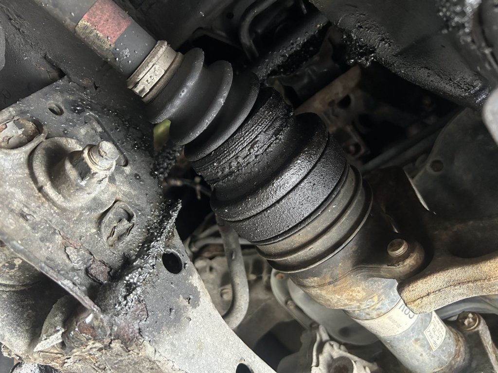

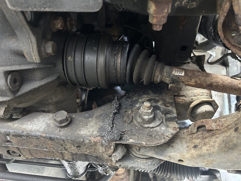

    Reclamp the boots. There's info on which clamps to buy on here. Lemme see if I can find it. DO NOT replace the axle! Seriously dude. OEM CV axles are fantastic.
    Here you go, @ToyotaDude to the rescue! https://www.tundras.com/threads/1st-gen-lunch-table-general-discussion.60450/page-1916#post-3451375

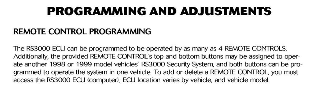

    Someone told me the reason the rs3000 fob has 2 buttons is you can program the 'other' button for a different vehicle.

    I was told that too. Had to confirm with the manual.
