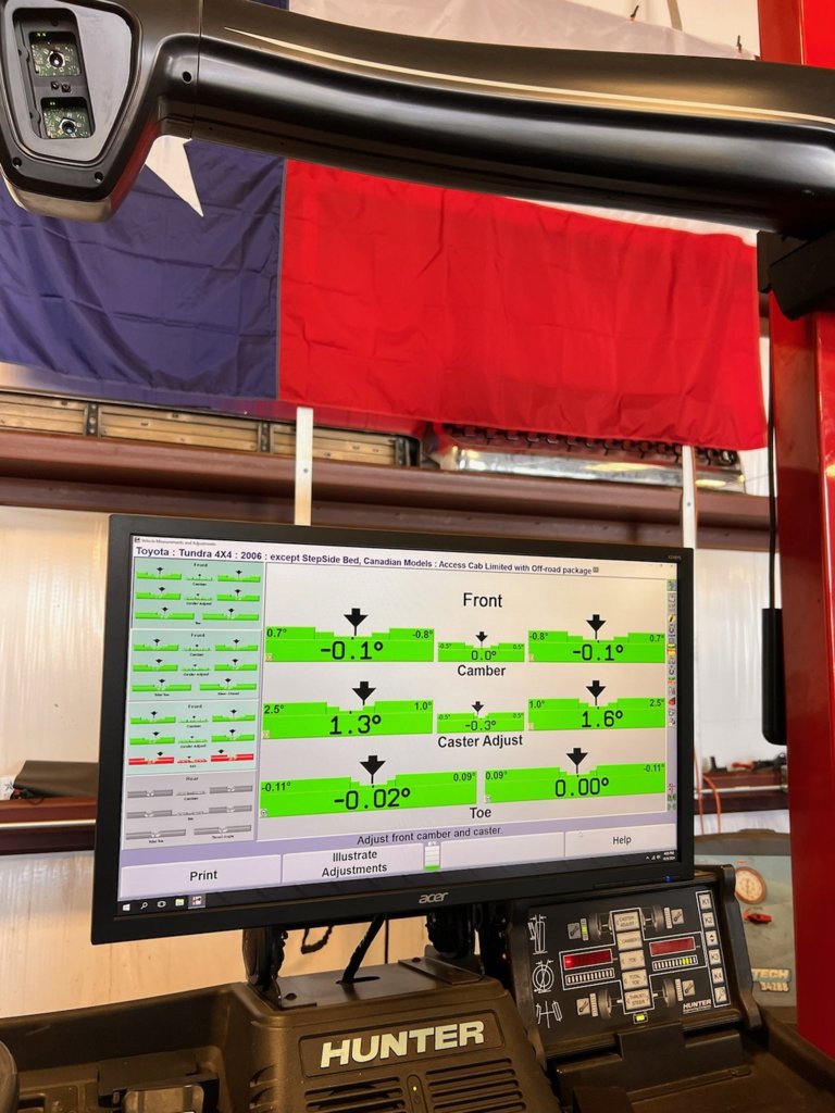

    Got a slight pull to the left. I'm guessing it's the toe or the caster. But I don't know.
  6. Oct 11, 2024 at 9:37 PM
    assassin10000
    assassin10000 New Member
    Oct 27, 2020
    #54157
    2,230
    Andrew
    Northern CA
    '05 SR5 AC
    Those numbers are wack.
    Needs slight toe in and more caster.
    Is this the 4x4? What year?
    FrenchToasty likes this.
  7. Oct 11, 2024 at 10:10 PM
    455h0le_dachshund
    Nov 21, 2023
    #107257
    7,641
    Rev. Hotdog
    TX...big surprise
    2006 4wd with 3" lift, SPC UCAs (adjusted one click from as far forward caster as possible), and 33's.
    Dude said my LCA bolts are seized, but he'll try again.
    I'm going to be buying some Solo LCAs, uniball lbjs and some off road alignment cams for Black Friday once the sales hit. But in the meantime, I'd like it to track straighter. I feel like it was tracking straighter before the alignment honestly. Only reason I got it aligned was because it had been at least 2 years, maybe 3 and I off-roaded it at least 5+ times since then.

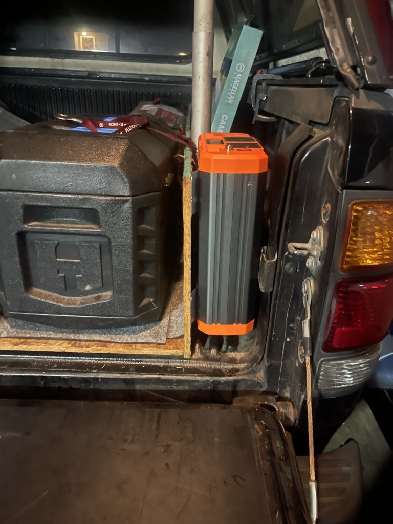

    How much room do i need in the fan side of this inverter?
    Battery mounted to the frame behind the shackle in the bedside?

    Since you're clicked forward on the SPC uppers, that leads to low caster and wandering.
    Given your current numbers, with the lower cams seized I'd try:
    2 or 3 positions back on drivers side
    1 or 2 on passenger side
    (From being pointed straight inwards at the truck.)
    Then slide the SPC's in or out for camber, shooting for -0.3 to -0.5
    .10 - .15 total toe

    My concern with going back on the caster is I'll rub.
    I'll let Juan take another crack at it Tuesday or Wednesday when he does my drain n fills and go from there. Worse case scenario, I'll just live with it til I can buy and install the aforementioned new parts.

    Not likely at the upper. A few mm of movent usually.
    The hub/wheel is at the bottom of the knuckle. Thats why you pull the lowers forward, to clear the footwell. Gets you an inch or two of clearance.
    Since you're going back, undo one of the uppers and measure it (for science!).

    I meant rub the firewall when stuffing my 295/75r16's. That's the whole reason I moved em so far forward a few years ago.

    My guess would be at least two or three inches. But I'm only basing that off my experiences with box fans. Too close to a wall and they don't blow as well.
