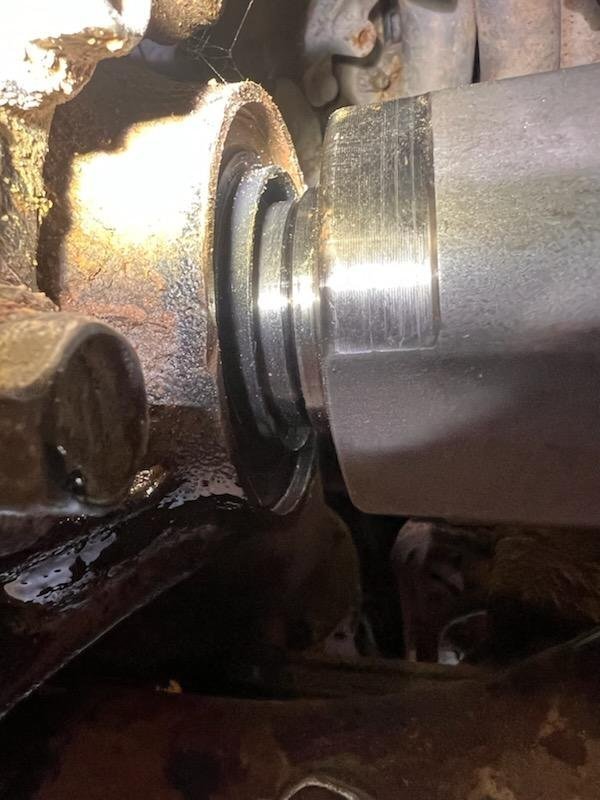

    Looks like the ECGS bushing isn't fullly seated

    IMG_7077.jpgThis pic, is definitely not fully seated, and that would explained the wear marks on the ecgs bushing. You were two wheelin bro. Get pics of the end of the cv shaft, bet it has a lot of rotational wear on the tip

    What @des2mtn pointed out, bushing is definitely not fully seated, in that pic you can see the mating surface for the seal is super far away.

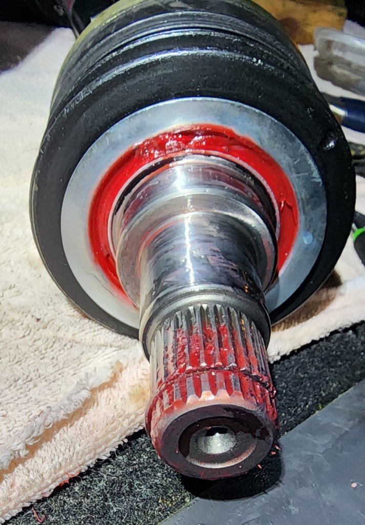

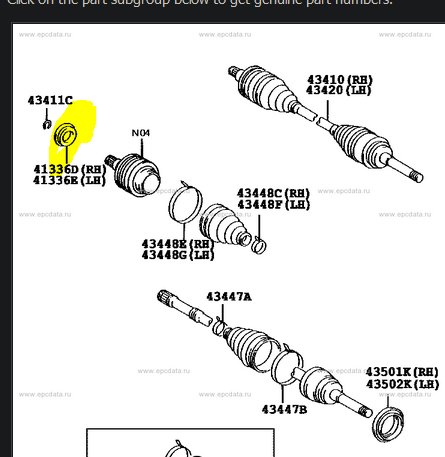

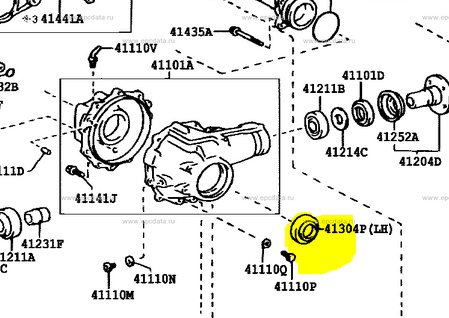

    You're missing the dust seal, might not have come with your aftermarket CV axle or the aftermarket CV axle isn't meant to use one. Since your ECGS and CV axle aren't seated enough, there isn't even a chance for the dust shield to mate against your diff seal.
    Dust shield
    Differential oil seal

    I was wondering where that was too. Me and Casey definitely moved it over from the old CV.
