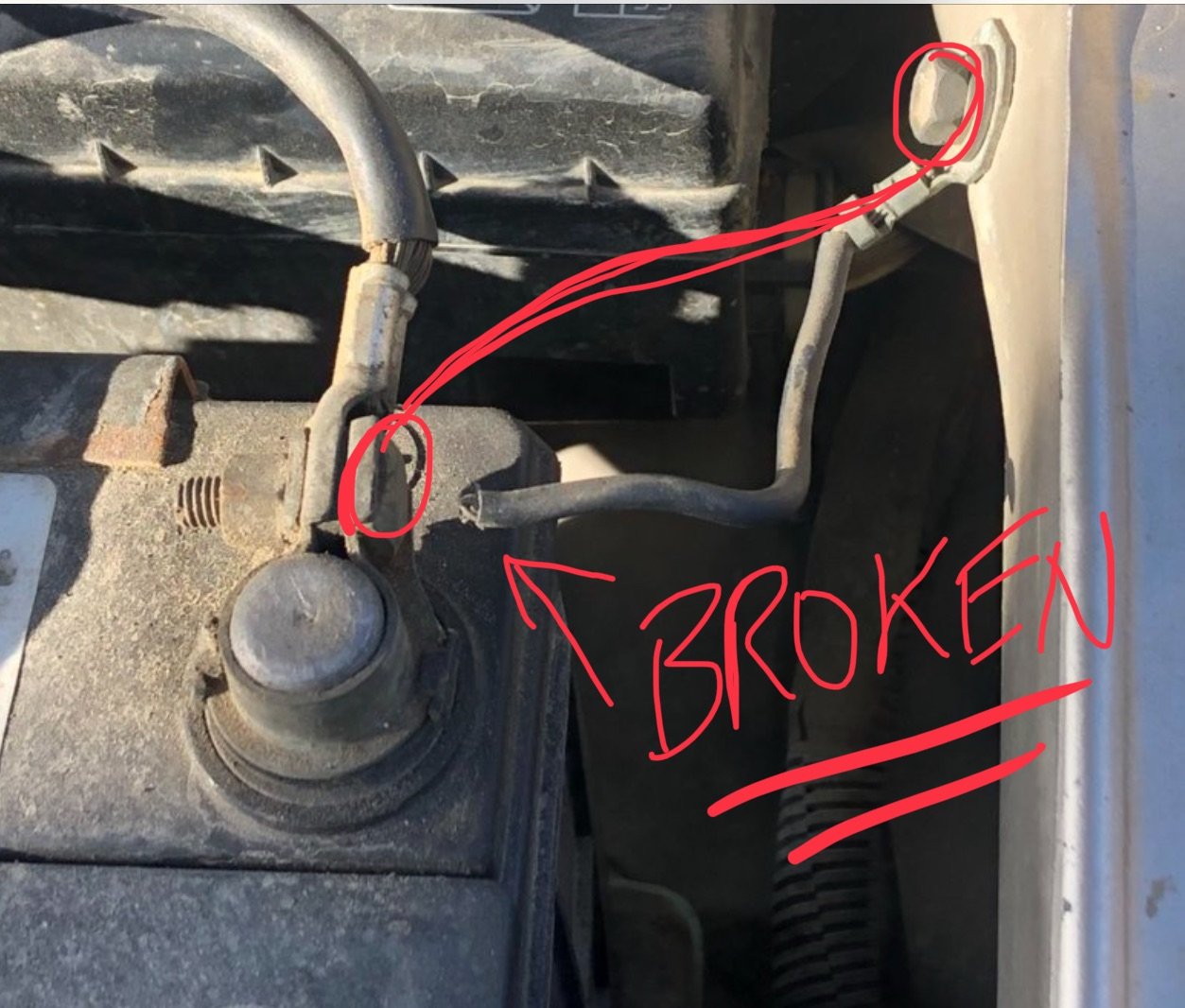

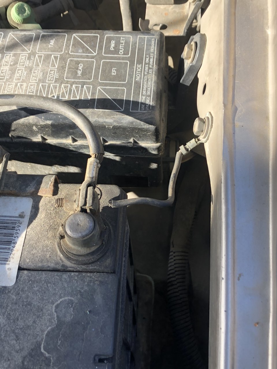

    @empty_lord is this a factory cable on a 03 Tacoma? Me and my friend noticed it today

    Yup. Chassis Ground

    Needs reconnecting. Thats a very important ground. Suggest a new clamp crimped on the broken end and reattach behind the bolt.

    Hes had the car for awhile now, Drove it up to Washington from ca with no problems. Is it normal for nothing to happened if its been/has been disconnected?

    The trucks have multiple ground points so one disconnected usually won't cause a noticeable issue.

    I’d repair it ASAP. Its there for a good reason. Your components will operate more efficiently. I’d look at the other ground on the firewall and make sure its in good shape, as well.
