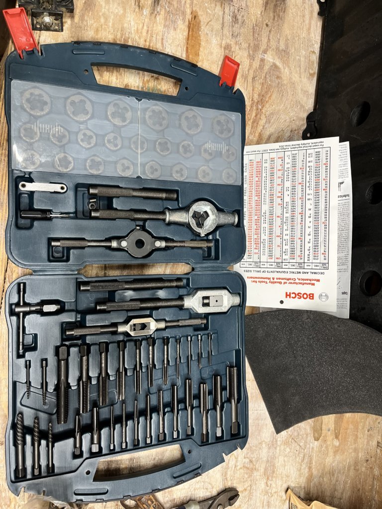

    Scored this on CL today for $80 bucks:

    Just curious. How often do you use one of these things? I almost bought a craftsman set selling for 1/2 price at $40 when K-mart was going out of business but I’ve never really had much of a need for it.

    I didn’t strictly need a set, but this one retails for around $300 and was basically NIB except for one tap; I have twisted off a couple of bolts/nuts in my time and this thing helps chase threads after you drill things out. Already used it to clean up the threads on my skid plate.

    You would probably need it more than I, as you are in the rust belt and more prone to fastener breakage. But anyone can need one to repair a cross-threaded fastener. I've only needed to borrow my dad's tap and die set twice. It's THE tool for the job.

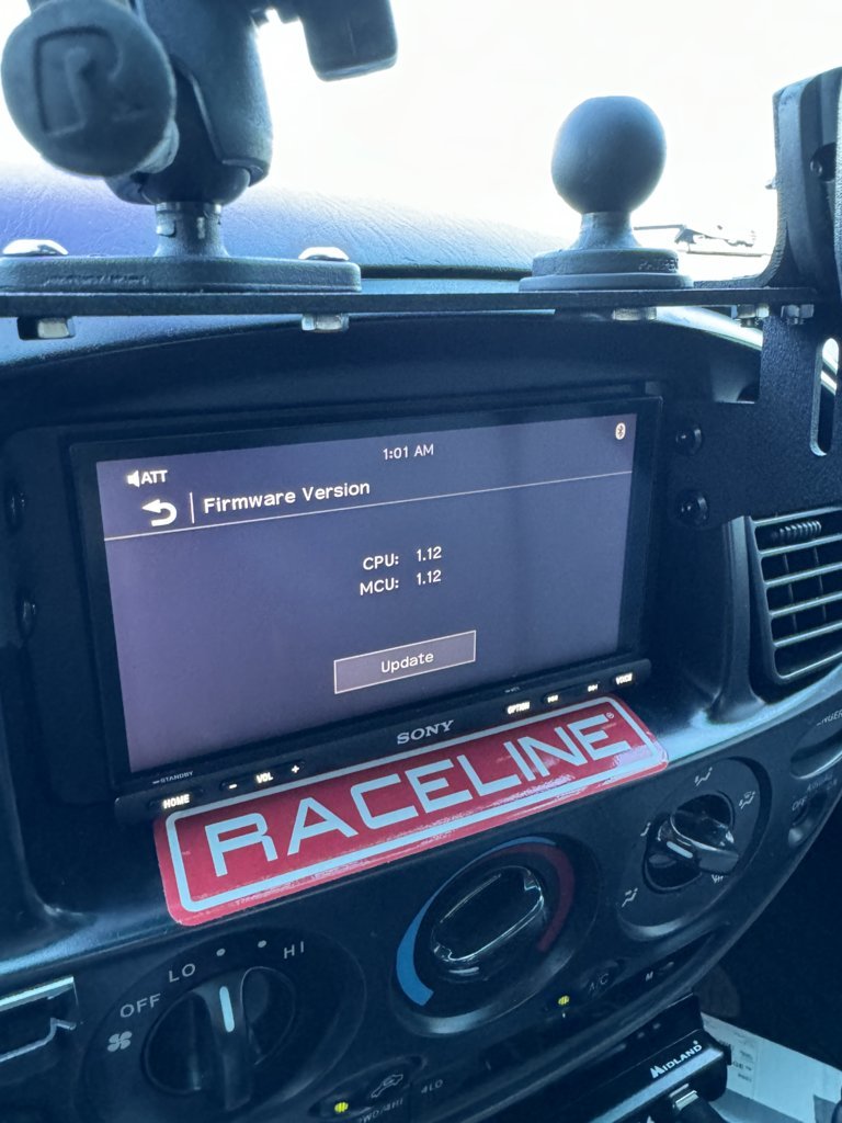

    Alright I don’t really want to start a new thread for a quick discussion. Headunit is on the fritz and has a mind of its own. Actually makes it awful to drive with on.
    Any recommendations for an Apple CarPlay head unit? Looking at this one and I’m willing to get rid of my dash mount to do it.
    https://www.crutchfield.com/S-Xb64wyprIyC/p_130DMT3800/Pioneer-DMH-WT3800NEX.html
    idk anything about car audio.

    Almost all name-brand head units can accept firmware updates. I'd start there.
    That said, that Pioneer is nice and offers wireless CarPlay. I don't personally like floating-screen head units, but as long as you keep it at 9" or less (which that Pioneer is), you should be aight.
    You may also want to check out the Alpine Halo9, although the price point may not be appetizing. https://www.crutchfield.com/p_500ILXF509/Alpine-Halo9-iLX-F509.html
    Also, for wireless CarPlay, but it'll fit in your dash like your Sony, from Alpine: https://www.crutchfield.com/p_500ILX507/Alpine-iLX-507.html
    That latter one allows you to update the splash screen at load, you can have it show a Toyota logo at car-on time if you want.

    Forgot to mention that I did try numerous factory resets and even the firmware update. The head unit will not accept the update on multiple thumb drives well within Sony’s requirements.
    this seemed like a good size and I’ve seen a picture where it’s more flush to the bezel as well.

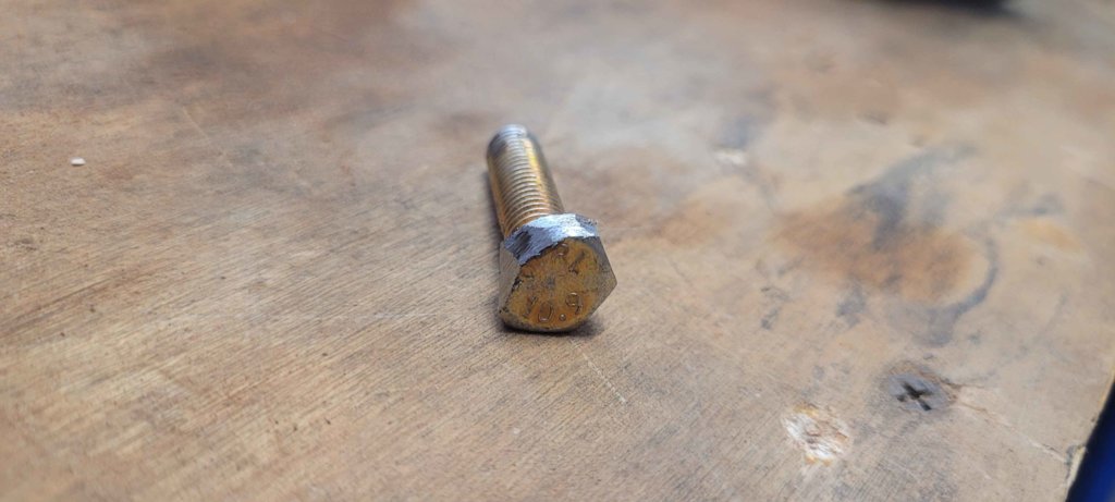

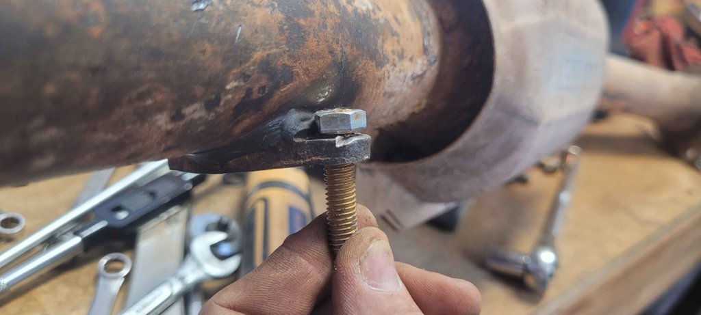

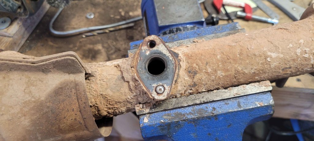

    I broke my downstream drivers the other week. Couldn't extract it and had to drill it, couldn't cut good enough threads. This was my attack plan, worked fine and didn't throw a code.

    The taps are used often, dies practically never. This is why I don't buy tap and die sets, just taps.
