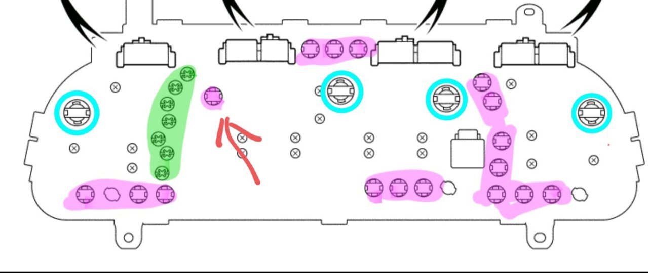

    I was thinking of a wet sanding technique with super fine grit sand paper, or something. There are quite a few superficial scratches that I've been thinking about.
    I was planning on removing the gauge cluster again eventually.
    In the blue circles are the 194 LED backlights I installed who knows how long ago...
    Pink is all the indicator lights such as CEL, Low fuel light, etc... Still incandescent bulbs in those locations. If memory serves @empty_lord mentioned Neo-wedge products for these locations? I can't remember if the bulb is removable from the twist base in these areas. If so, I think it'd be a T5 LED?
    The one pink with a red arrow burned out a long time ago, and I never replaced it when I did the 194s. Having that one dim section of dash has been bugging me more, and more.
    In green are the shift lights. Not sure if there are any led aftermarket twist bulbs for that. I hope so, but want to have all parts on hand when the dash comes apart again. Any help here on these? I know PHM went OEM in this location for fitment purposes, but I never wanna tear the cluster out again after this. The buck stops here.

    I think I'd go with a plastic polish on the lens over sand paper.
    The fuel light has to stay incandescent or it won't work. There's a chart in the FAQ with all the bulb numbers.

    The 4 blue circled and the one pink with arrow I replaced with LED. The green area I just replaced the P and D with OEM. The others I left alone as they probably will never go out. If they do go out then just use incandescent to be on the safe side.

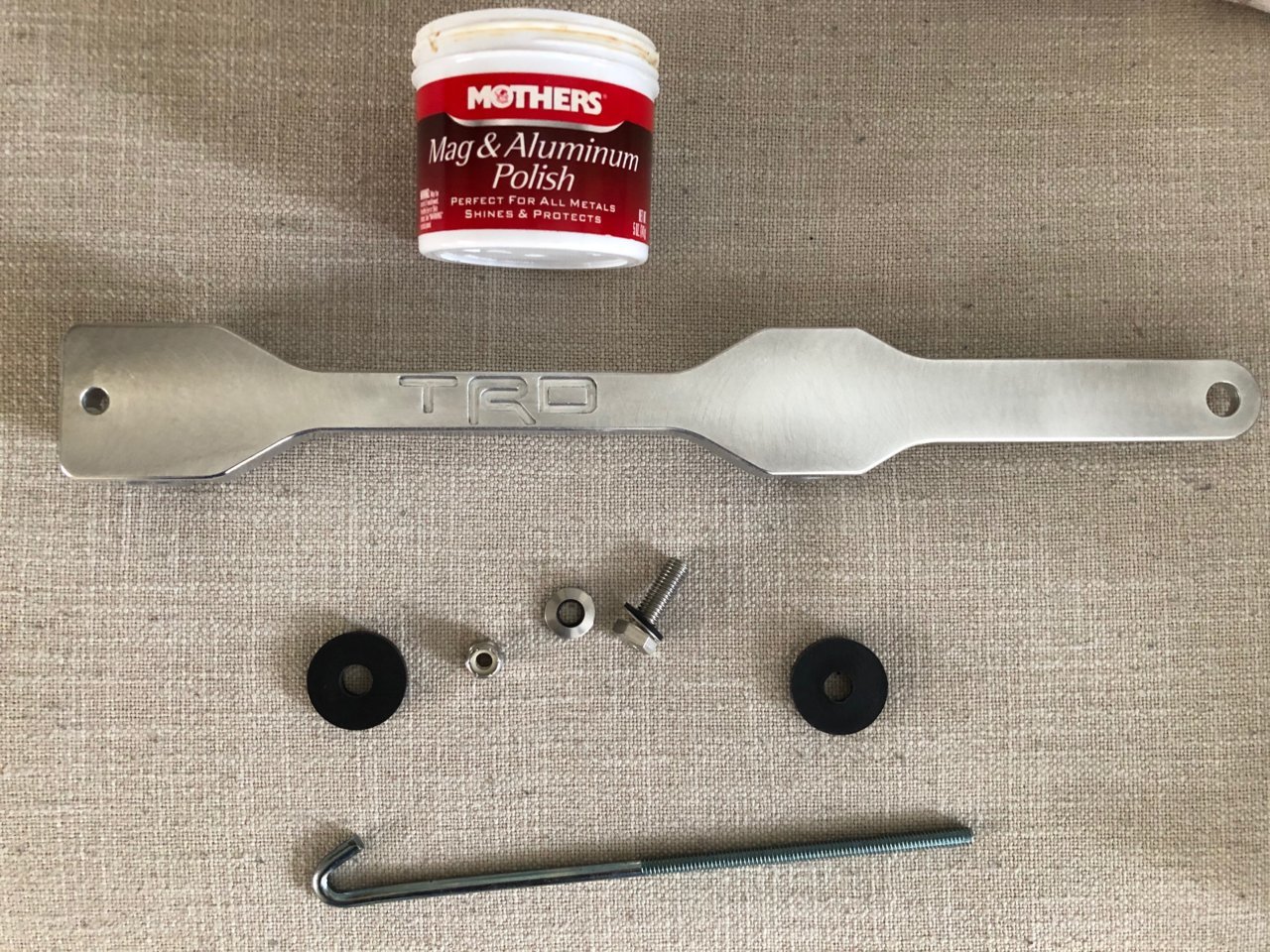

    He used Chrome and Mag Polish on the lens with a conical buffer on an extension with his cordless drill.
    I have some and just used it the other day to polish my Aluminum Battery Hold Down Bracket. Never tried it on plastík.

    they should be toshiba type T bulbs. the switches in our trucks are neowedge.
    DO NOT CHANGE THE LOW FUEL LIGHT TO LED. the bulb acts as a resistor and the light will not function correctly with an LED

    I remember seeing the Toshiba twist base now that you've jogged my memory, but I can't remember if the pink bulb(s) is "removable" from the base. Its been awhile since I've been in that section of the dash.
    10-4. I know my low fuel light worked as of last year when I ran her low to make sure. It was weird seeing it slowly come on, and off. Fading in/out.

    they can be removed but finding an LED that fits and doesnt hit the lense is the issue

    Hmm, I see. Maybe the push in base of an led could be trimmed down.

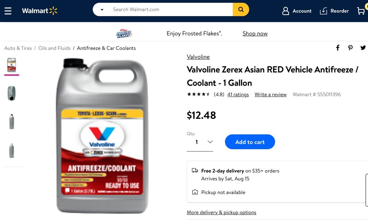

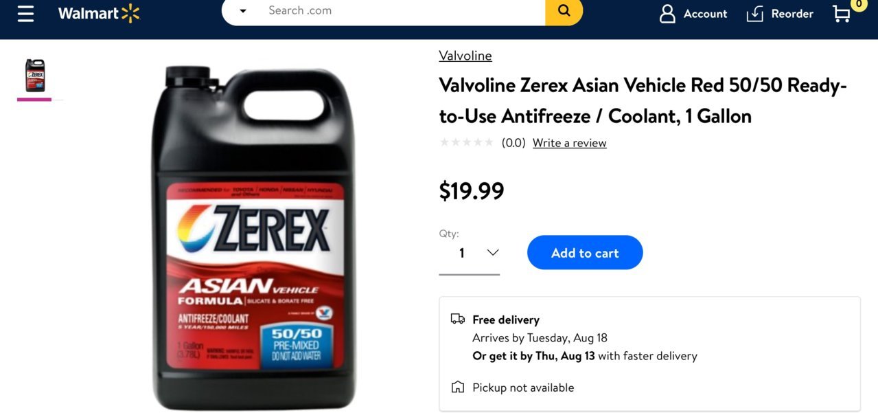

    Wallace Wurrld Price Games. Both are the exact spec and both sold at their store.

    You could try. Best thing is just buy the OEM bulb for P and D. Its a tight fit (she said).
