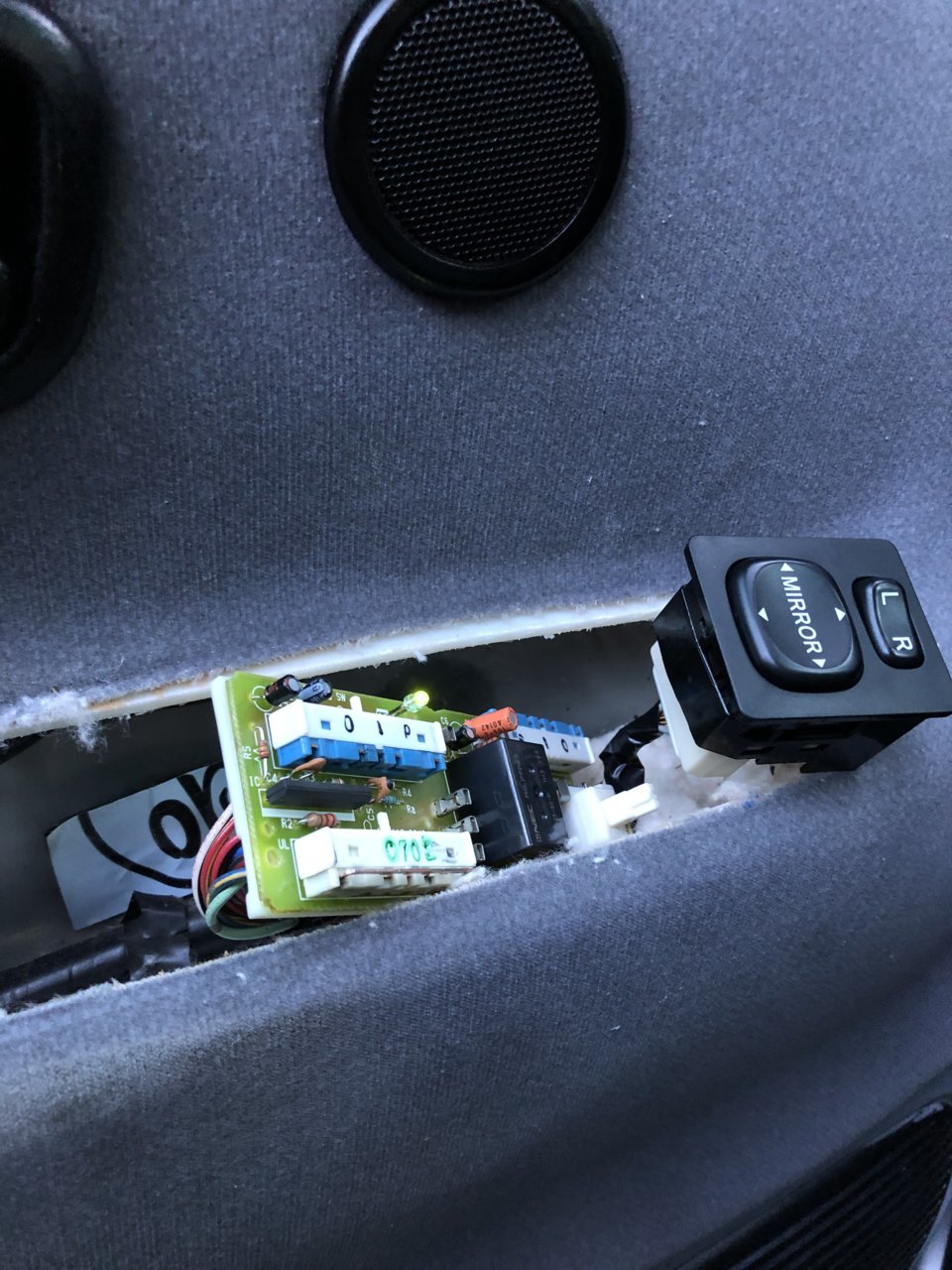

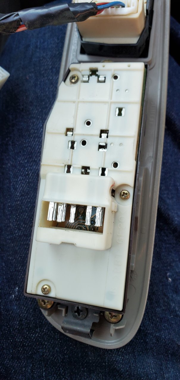

    I’m going to mess with that drivers door switch light tonight. Maybe. Brew up some solder in a copper cup and dip my LED prongs down in there and then glue it over to the circuit board. Danger?

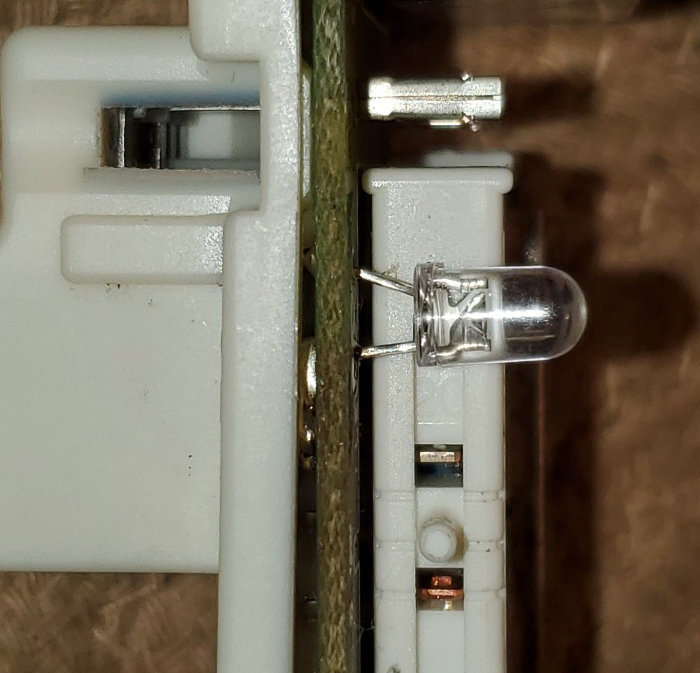

    How I did mine was thus.
    Remove the three small Phillips head screws from white board on the back, and then pry up gently on the WB. There are pins in the white board that go straight up into connectors on the circuit board.
    After the back of the board was exposed I carefully heated up the solder on the old green led, and then pulled each pin up/out of the board individually.
    My new leds had long pins, and I bent them into approximately the same width as holes in the board. Stuck them through as far as I could get them to go, and again carefully soldered the new light in.
    Once it was attached I cut the extra off the back side of the board, and had to file just a little bit of solder from my work down so the WB would fit.
    Mine were polarity sensitive. This is how I put it in, and it worked.
    I had to solder it in twice because I put it in "backwards" the first time. Was nerve wracking for me, but I got it done.
    I have no pictures of the back of the board. As long as you're careful you should be fine. I have an extra switch if you mess yours up.

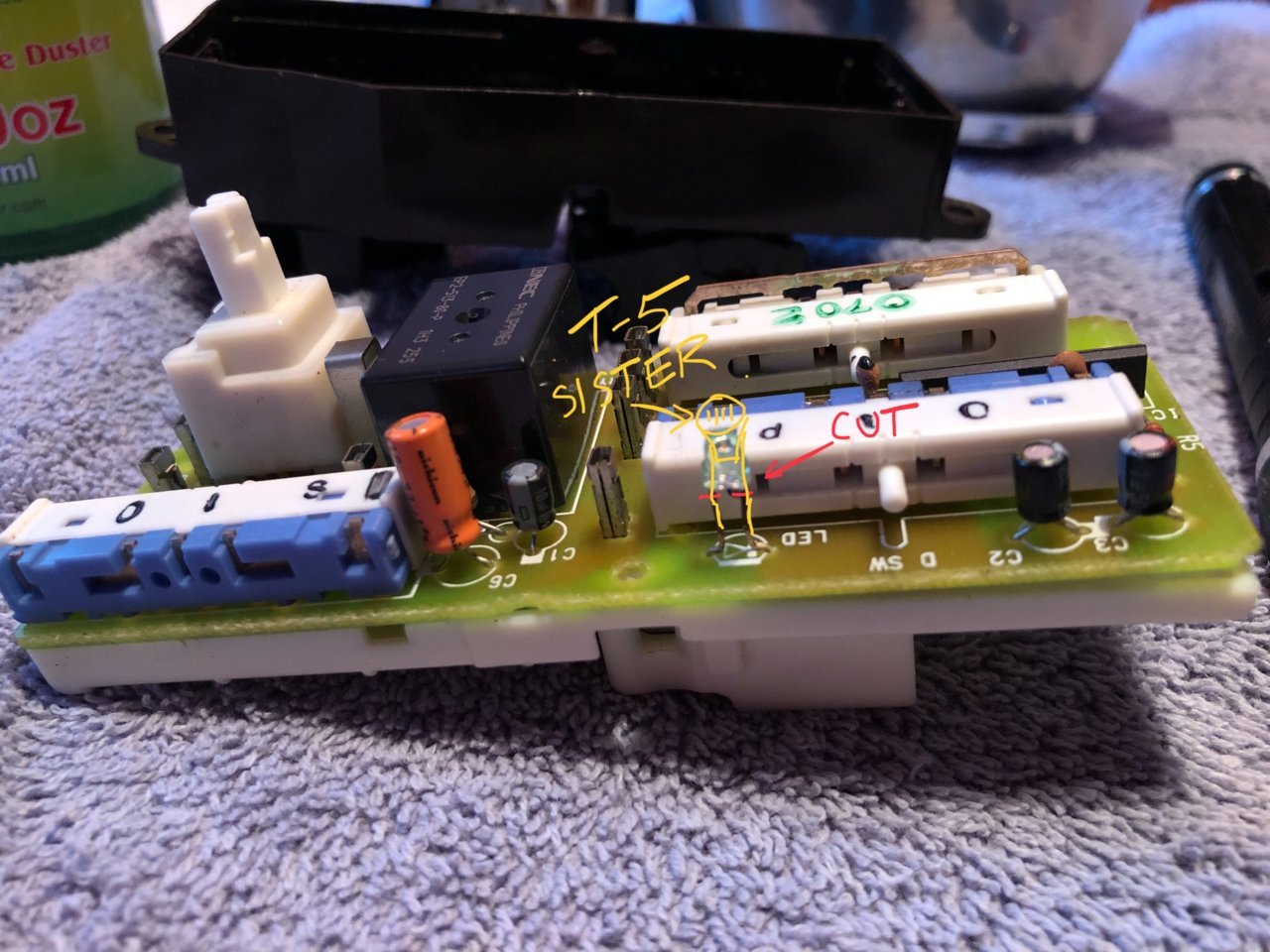

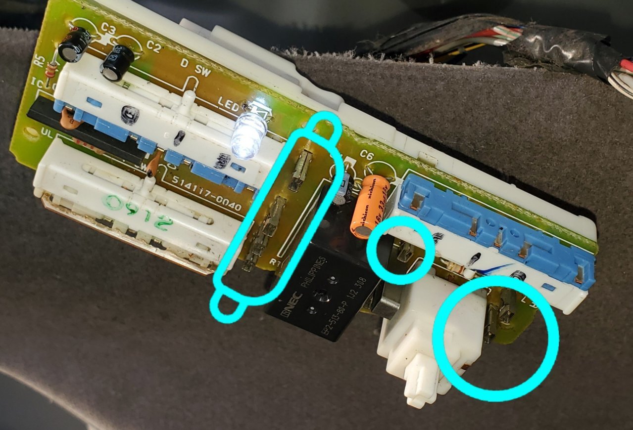

  6. Aug 10, 2020 at 5:06 PM
    #6786
    Professional Hand Model
    #14878
    14,993
    Fred
    Hand Protectors
    Went out and did a quick removal of things based on your prior post way back. I even took the mirror switch assy apart and regreased the slider in there. No pics as I was in tight sphincter mode due to the sensitive components.
    Cleaned up the slider copper for the pass side window control. It had some corrosion (maybe why its been sticky?). Electric greased it. Blew out the dust off the assys with some canned air I found at a garage sale. Went out and plugged things up to make sure I didn’t mangle anything. Everything still works! Bulb still works, but dim.
    Plan is cut the existing LED and leave the prongs as long as possible. Sister the new bulb T-5 Prongs right up to the old ones using the ‘dip and go’ method.
    Tomorrow is solder day. A good plumber always told me to never sweat after sundown.

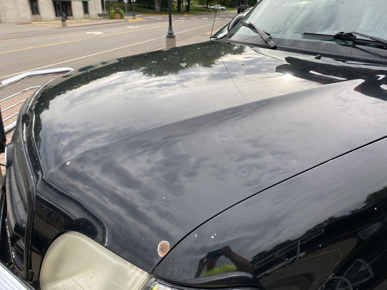

    Bad news.
    it hailed golf balls last night and the old girl took a beating...

    You know, solder wick is a thing, and it works really, really damn well. I cannot recommend enough for you to buy some of it and also buy a desoldering pump. Between these two, you'll not have any more sweaty moments.
    Furthermore, and I hope I'm not telling you something you already know, but look up "pre-tinning" on YouTube, and read this comic. I know, it's a comic. But it covers some of the most critical points (other than pre-tinning, which is absolutely critical to learn for both wires and working w/PCBs) which will help you if nobody ever taught you how to properly solder.
    That sucks. I'm so grateful my truck has a roof over its head. My old one wouldn't fit in the garage and I had no choice but to park it under an old oak tree on the street. Between the acorns falling from 40-50ft up and the garbage the oak scale infection would piss out I was washing it every two weeks and would see one or two new dents every week. :(

    I wasn't aware of the solder wick, but my weller solder desoldering pump came in a few days ago. Seems to be quality.
    I've never heard it called "pre-tinning" and always heard it called "tinned." Sounds like the same thing.

    It's F'ing awesome. Lay it over anything you want to remove solder from, then lay the iron on top of it so the wick is sandwiched in between and POOF 90% or more of the solder is sucked up. Video example.
    Don't get me wrong the plunger is great and everything but not always the most elegant solution.

    yup, it’s a bummer. We’ll see if the insurance totals it out or not. Probably not going to fix it since the cab is so rotted out. I’ve put enough money into this thing. I’d buy it back from insurance if it’s totaled though.

    That sucks. Be prepared to dispute value with your insurance, any recently completed repairs and upgrades as well as local ads for trucks of similar year,make, model and condition. You have to squeeze them for every cent. Do you think you will buy another 1st gen? If you find something here in SE Florida, I live 3 minutes from ft Lauderdale airport and there is a spare room by the pool.

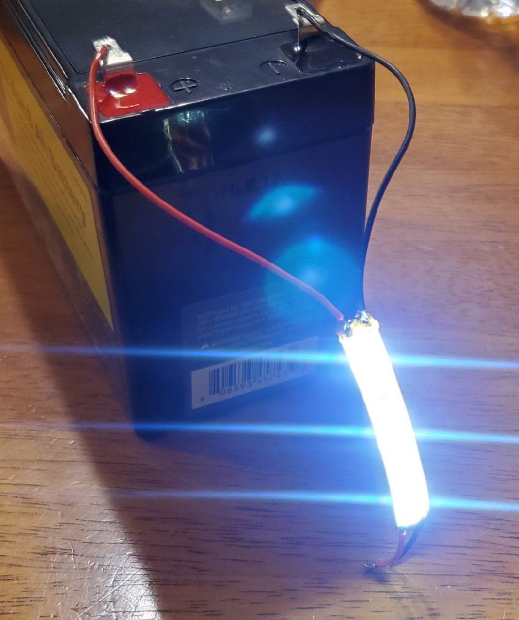

    Did some local investigating while I was out looking for another item: the rare corona-na-na...

    You have "full" coverage? That's good. Be ready to haggle.
    This is a good reminder for this,
    https://www.tundras.com/threads/psa-insurance-with-truck-modifications.50856/

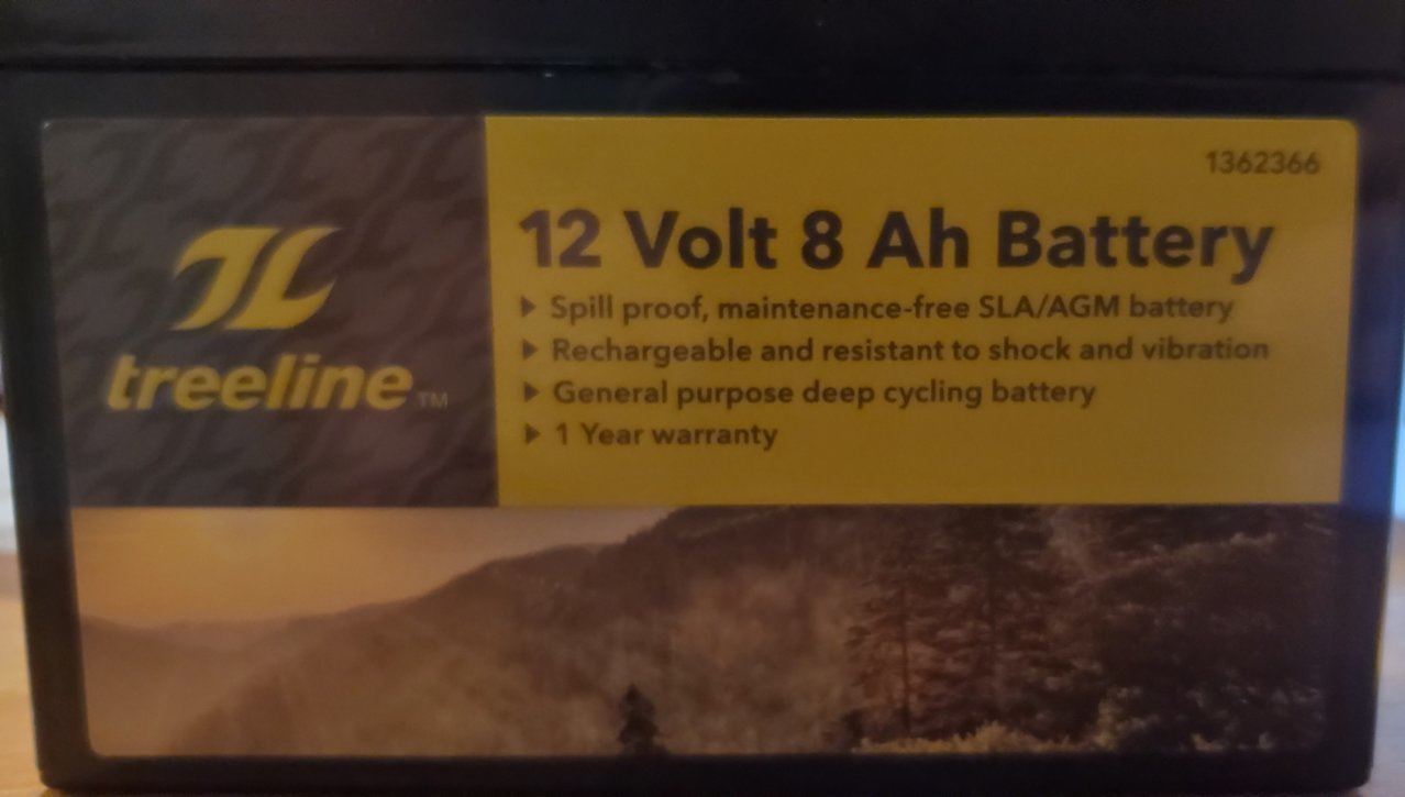

    Per @Festerw's, and @bmf4069's recco.
    I'd been shopping around online for a SLA battery. Was browsing today while out on small shopping extravaganza. Saw a relatively small SLA in the clearance bin. $10 later...
    Coming together! Diodes on order, and other goodies should be here eventually.

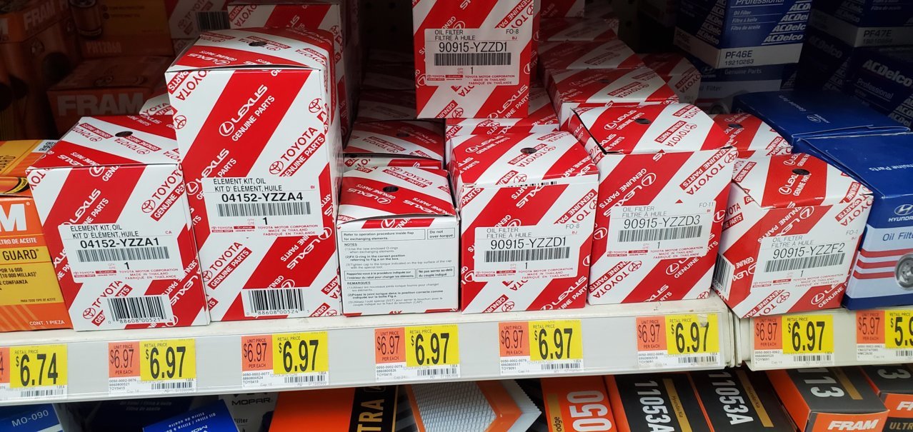

    Other goodies include the supa sweet-ness Toy OEM "filther" from the local wacko-mart.
    Turkey baster for slow draw power steering change. I don't think I have appropriate help here for the full drain/fill that was reccomended awhile back.

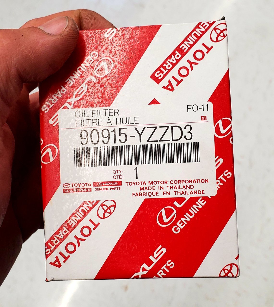

    Looking back at my broad brand filter post...
    Is the filter "element" a paper filter for the turd-gens? Or the rexus?
