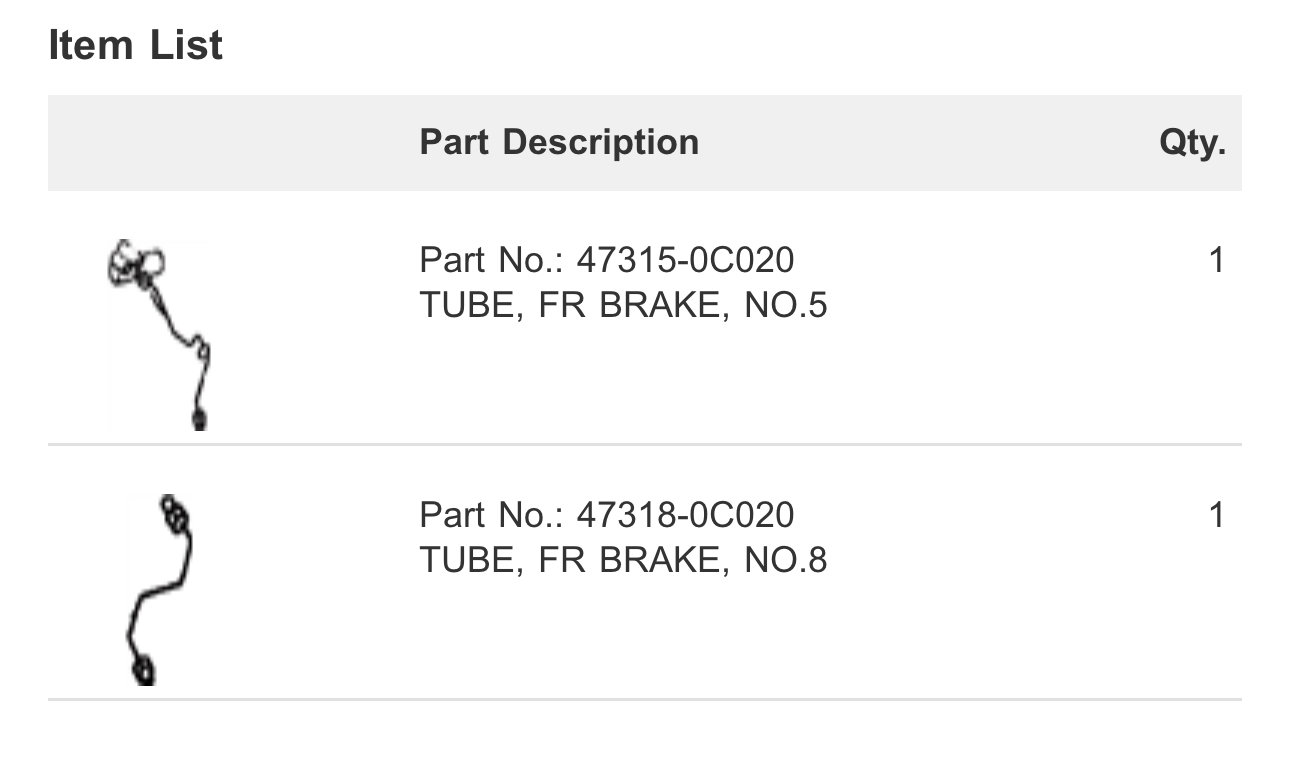

    khooiii
    khooiii 80HD
    Oct 9, 2021
    #69126
    1,198
    DK
    DFW, TX
    03 Tundra AC 4WD
    timeline:
    Purchased truck - unknown drum condition decent pad/rotor life.
    custom rear shock setup - installed trailgear extended rear brake line, lspv relocation on custom bracket. Brakes didn’t feel good. Bled all 4 corners and the shit out of the LSPV. Got decent pedal feel back. installed extended 3/8” stainless eyelet and hardware to bring bias towards rear. Could feel rears grab pretty well. Still not great, but it was drivable.
    hardline off the passenger caliper failed - cracked or something right at the fitting on the caliper and I lost a whole bottle of brake fluid. O’Reilly universal line quick fix. Bled twice and dealt with the mediocre pedal until my OEM lines came in.
    replaced both hard lines off the front calipers with OEM- Bled ONLY at the front calipers. The BEST this truck has ever felt. Engages almost immediately and with great pressure at the brakes and the pedal. I can stand on the brakes without the pedal to the floor and the truck stops. It brakes hard enough to throw anything that’s in the seats straight to the floor.
    buddy’s situation is very similar to @FiatRunner. He said he might give it a shot after driving my truck. He’s bled it with all the fancy dealership bleeders, 2 person method, and states his brakes components are in good condition and he’s adjusted the rear drums. My issue was ongoing since I touched the brakes up until the OEM line replacement. It feels better than when I bought the truck and I haven’t replaced drums, pads, calipers, or rotors.
    part #’s for the lines.

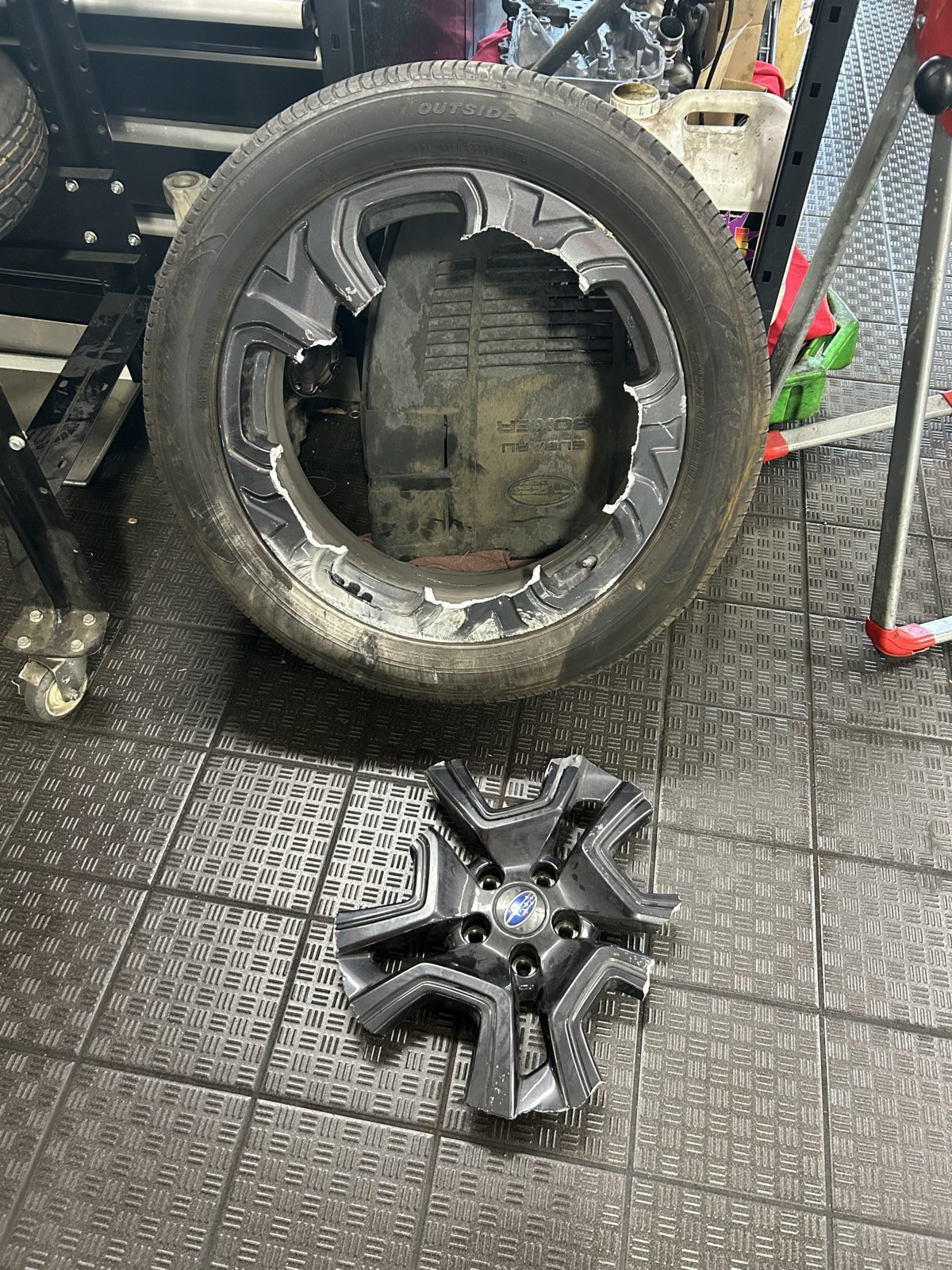

    The Black Mamba
    Sep 6, 2023
    #103472
    4,509
    Ryan
    DFW
    Black 00 SR5 AC 5VZ PreRunner
    Imma keep it stock
    This one took some real skill
    khooiii, shifty`, BroHon and 5 others like this.

    The Black Mamba
    Sep 6, 2023
    #103472
    4,509
    Ryan
    DFW
    Imma keep it stock
    Not a whole lot of info was given. Obviously a curb was involved.
