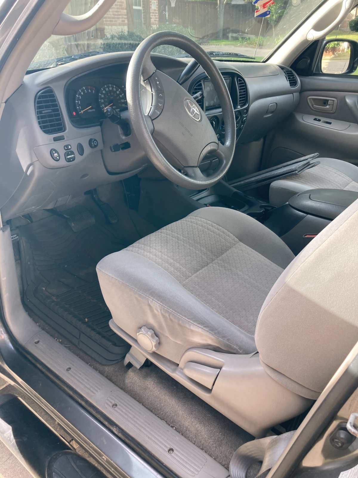

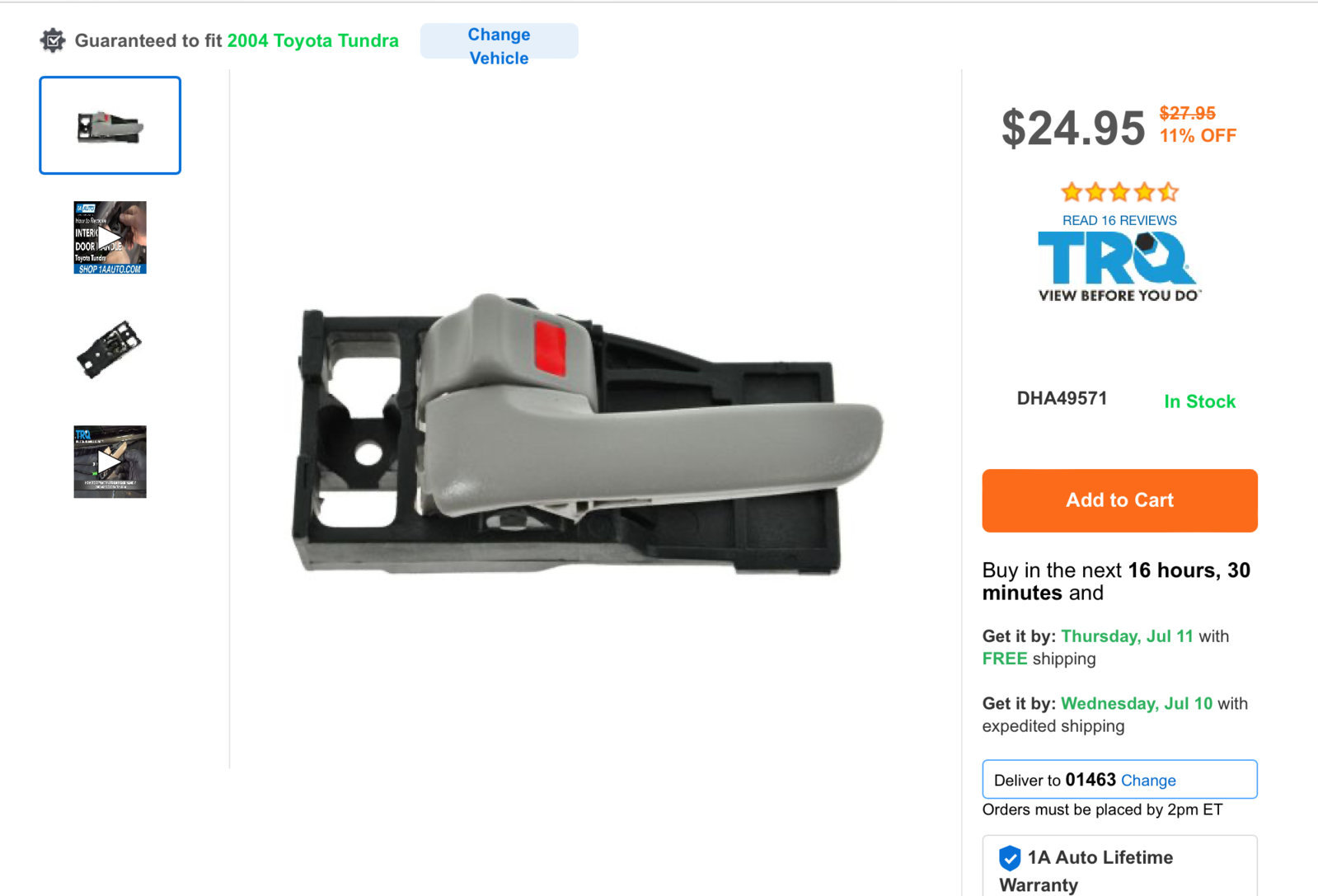

    Driver Inside door handle cracked. I'm looking at OEM replacements. Looks like part no is #69206-0C030 from toyota. There are three color options:
    -BO: Md Charcoal
    -EO: Md Oak
    -B1: Md Gray
    My VIN sticker on the door says 1E3/FN11. I always just thought the options were light gray and tan. My truck is the light gray. But FN11 on yotatech says light charcoal. WTF? Just trying not to buy the wrong thing.

    I don't know if it matter which you order, Toyota isn't making our many 1st gen interior parts like door handles in painted options anymore. Everything anyone I've seen has ordered in recent months has been beige. That includes interior door handles, access cab door leverl/locks, and misc other trim parts. It happened to me most recently when ordering replacement access cab wing window latches. Thankfully, I was able to move my latch covers over, and NickB over in KY needed some beige ones, so I shipped him the complete leftovers.
    I ordered similar for my access cab on the interior pull handles, and my part numbers were...
    69205-0C010-B2 (Passgr front door handle, dk grey)
    69206-0C010-B2 (Driver front door handle, dk grey)
    It was ultimately these parts, is that what you're looking for?:

    Yeah that’s the part. The actual handle plastic cracked. But my interior is lighter gray than that. Like this. I think I may go for this non oem and see how it looks. At least the name of this matches the fn11 as listed on yotatech. In the end I guess it’s just $25 I’m risking.
