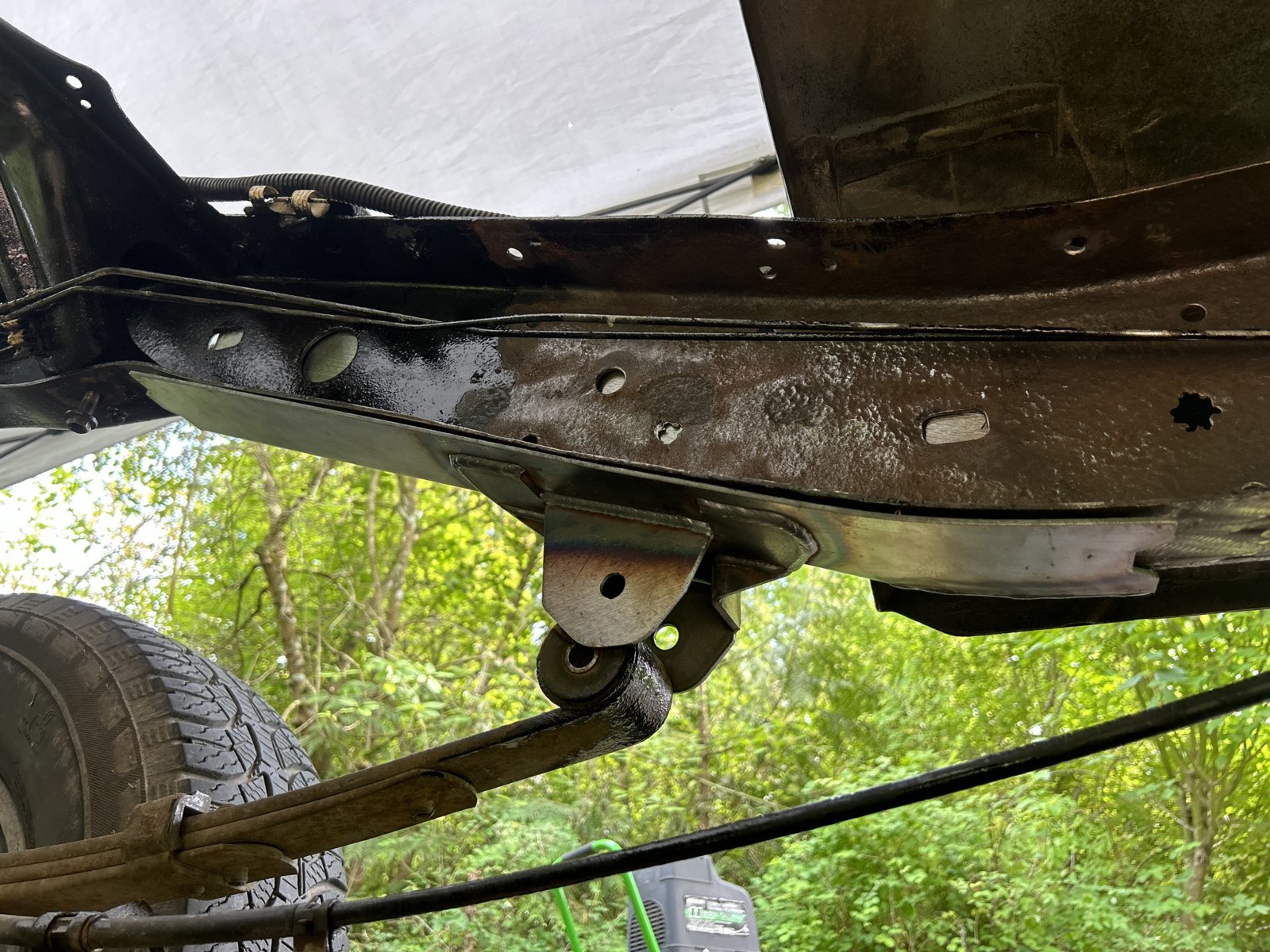

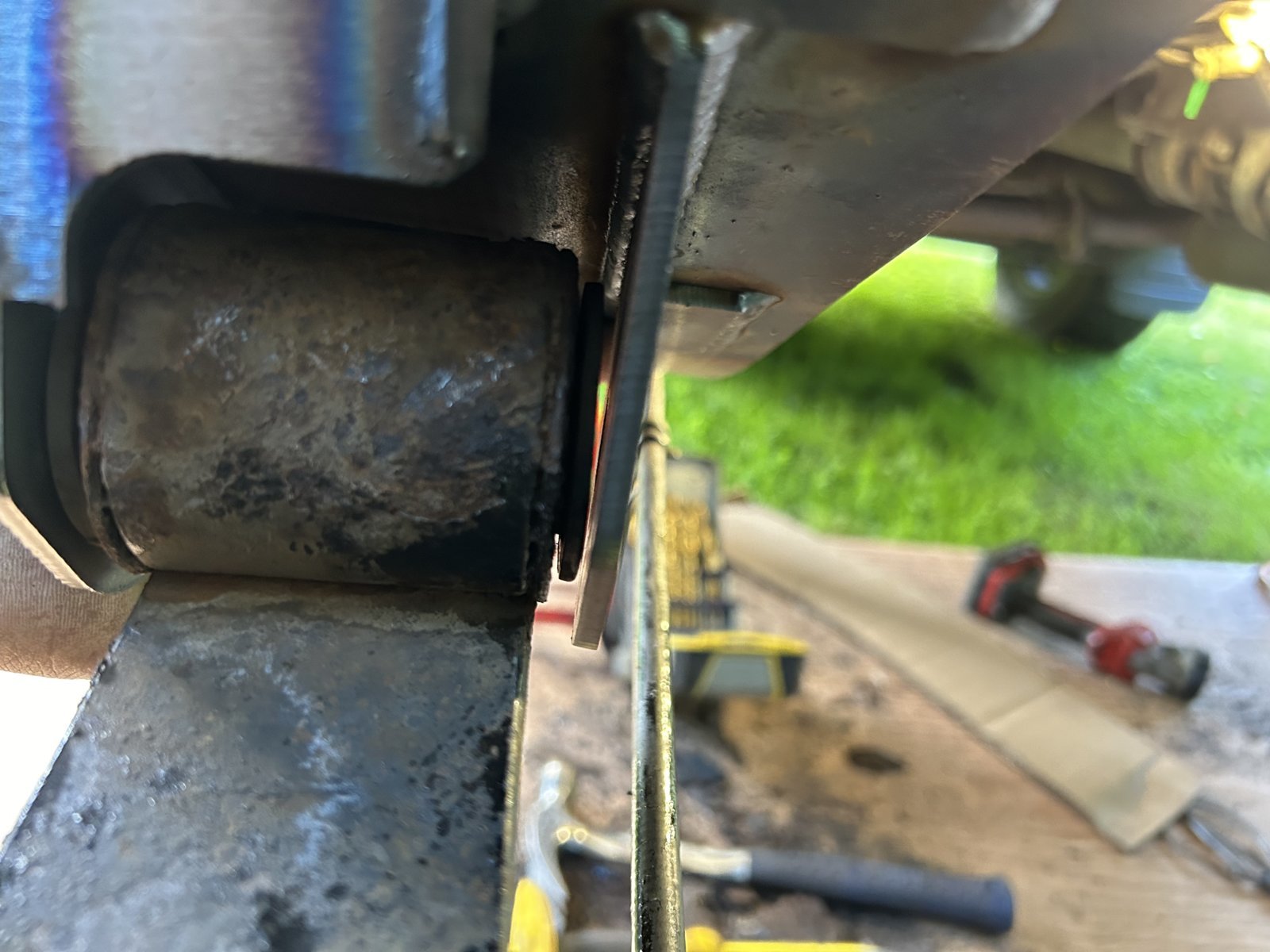

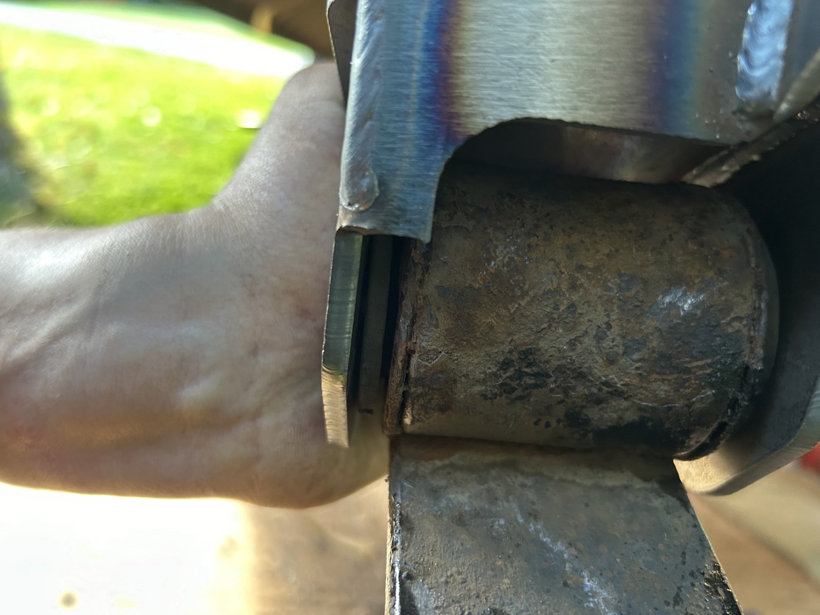

    I’m in the process of a frame resto and have gone with some auto rust spring mounts. The new spring mounts appear to be a bit wider internally, not sure if that’ll pose a problem or if I’ll just need wider bushings when I get my new leafs. The old mounts needed some prybar action whereas these ones fit freely.

    What's your plan or does autorust recommend anything to further prevent rust between the new/old frame section you're welding in there?
    I imagine it's not perfect and there will be a tiny gap where dirt/water/salt can get sandwiched in between over time. Unless of course you plan to weld every hole/crevice; that might make sense I suppose unless the gap is too large from what I see of the overlay.

    All they recommend is a 100% weld coverage on the outside. I’ll be prepping the metal underneath and may slap a coat of paint on the bare metal just in case.
    It’s the spacing in between the mount itself, having the gaps on each side of the leaf spring bushing. I’m sure one could just fit a larger bushing and be done with it.

    That should be fine, my OEM frame mounts flexed in/out like that between the leaf springs on both trucks. The bolt should be able to squish that plate in some
    Check it after proper torque

    tack in a washer lol
