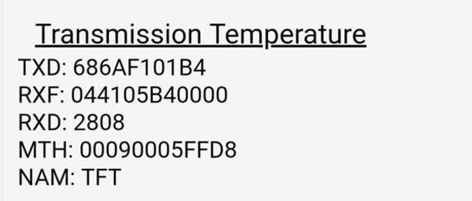

    I'm looking for the codes for the scan gauge 2? I have an 04. Yes I searched, I cant seem to find it. What other parameters are you viewing with the scan gauge?

    Can anyone conform if this is the correct scangauge code for an 04 model. I found it on another forum. sgii-trans-code-jpg_3c50750018c301bc4e0e1d58290e5b4a17720940.jpg

    You're looking for the x-gauges, I assume to program things like transmission fluid temp?

    Yes that is correct. What other parameters would you recommend to watch?

    00-04 Transmission Temperature (Degrees F)
    TXD: 686AF101B4
    RXF: 044105B40000
    RXD: 2808
    MTH: 00090005FFD8
    NAM: ATF
    Yep, it's correct. But I prefer to name it ATF myself.
    Also...
    05-06 Transmission Temperature (Degrees F)
    TXD: 07E021D9
    RXF: 032100000000
    RXD: 1808
    MTH: 00090005FFD8
    NAM: ATF
