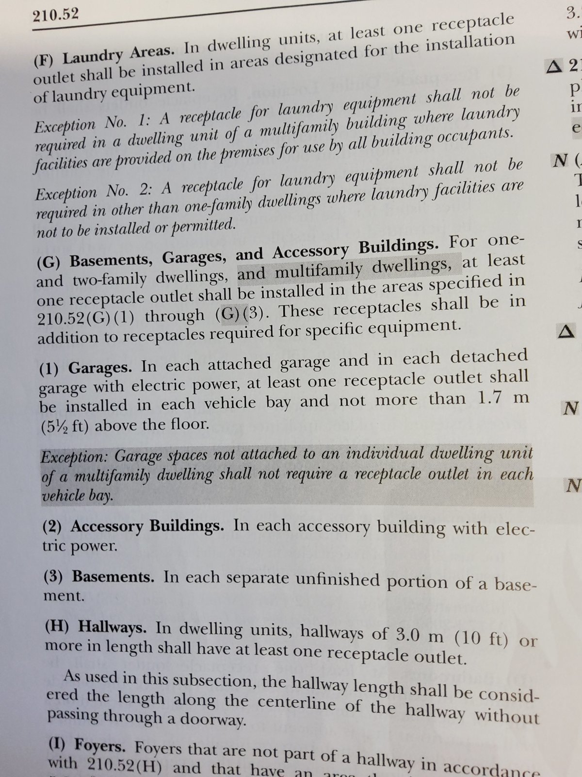

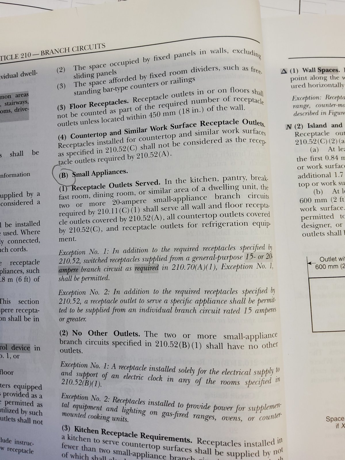

    I was bored so I snapped some pics of the code references just incase anybody else was bored or needed bathroom reading material.
    210.52(B)(1) and 250.52(B)(2) for the kitchen.
    210.52(G)(3) for the basement
    I couldn't get the one for GFI protection without getting the whole page, but it's 210.8(A)(5).

    What about for a modern fridge. Those are usually on a dedicated circuit also. Mine shares a 20amp with an additional outlet and a small beverage fridge.

    They don't technically have to be, but it is common practice nowadays to put them on one.

    It’s never against code to run dedicated circuits. If you have spots in the panel, I say fill them.
    I ran dedicated for everything in our kitchen. Marginal extra cost in terms of wire and breakers. Well worth it.
    definitely more hassle and cost as you get farther from the panel.
    well, one thing that code says you can’t do as far as dedicated circuits go is a 20 amp breaker with a single 15 amp receptacle. Hopefully that one is obvious.

    Correct. But we do anyways. Inspectors don't bother with that one.
