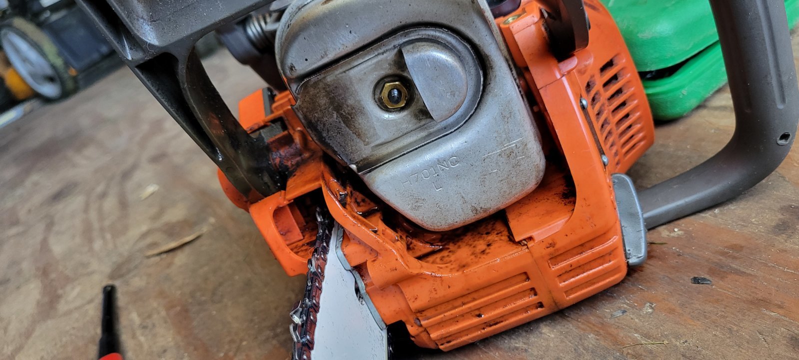

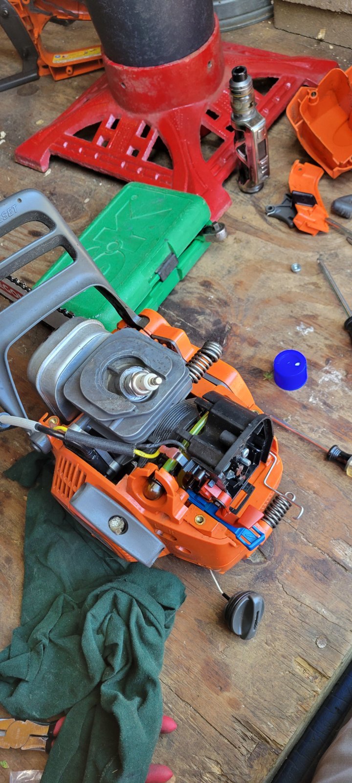

    I admit I "eagle eyed" the gap, but in my defense my Milwaukee safties have bifocals :anonymous:
    Yes I saw spark, but it didn't seem strong.
    I put a new Walbro on my ancient snapper string trimmer a while back and it solved the issues (i swear it was only $15-18?) so I know that's prob where I'm headed. Thx for the advice:thumbsup:

    Expert, Ha!...maybe at pulling the throttle lever. In all seriousness, i can work on just any other carb, but the small chainsaw carbs tend to frustrate me the most. Probably because the orifices are so dang small, that they can’t always be cleaned out properly.
    If you still don’t have spark, it can only be a few things. Check that the gap between the coil and the flywheel. It should be about a matchbook thickness (or business card) of gap. Also make sure to clean (sand) off any corrosion on them. You could also have a bad spark plug. Another spot is the plug cap. So make sure that is in good shape as well.
    Check the L and H carb screws aren’t way out of whack. I think the baseline setting for them both are 1.5 turns out?
    Also check that the fuel tank vent isn’t clogged.
    The needle on the end of the float can be worn out, yet it will not be able to be seen by the naked eye. It’s always best to replace them (using OEM parts). If you have an ultrasonic cleaner, i’d give it a dunking. Have you priced out how much a replacement OEM carb would cost? Because sometimes it’s easiest to simply replace the whole thing at once.
    Pretty much everything i said you probably already know, but sometimes it’s nice to have someone else to say it (at least i appreciate when someone does that for me).

    Thx, I know I have the gap too tight now, but I still have the super-flooding problem. I will check rebuild kits vs new carb.
    Clogged Fuel tank vent will cause flooding? I mean serious flooding like spraying out the plug hole after 4-6 pulls.
    No corrosion on the magnet side, coil is brand new, spark plug as well.
    H and L adjustments were really good last fall... unless screwing them in and out will clean them, I'm letting those be.
    Thx for the tips :thumbsup: yes, always nice to hear you didn't miss something obvious o_O

    It’s a long shot, but my thought was that if the tank vent was blocked, AND if the weather was hot out, then possibly the tank could build up pressure and force extra fuel past the needle valve? But probably not. I’d probably start out by replacing the needle valve. When they get worn, it causes all sorts of grief. And even with the naked eye it might not even look worn, but it still can be. You can burnish the needle seat as well. I usually use a bamboo chopstick that i chuck up into my cordless drill. Triple check that the needle didn’t slip off the float. And triple check that the L adjuster screw isn’t too loose.
