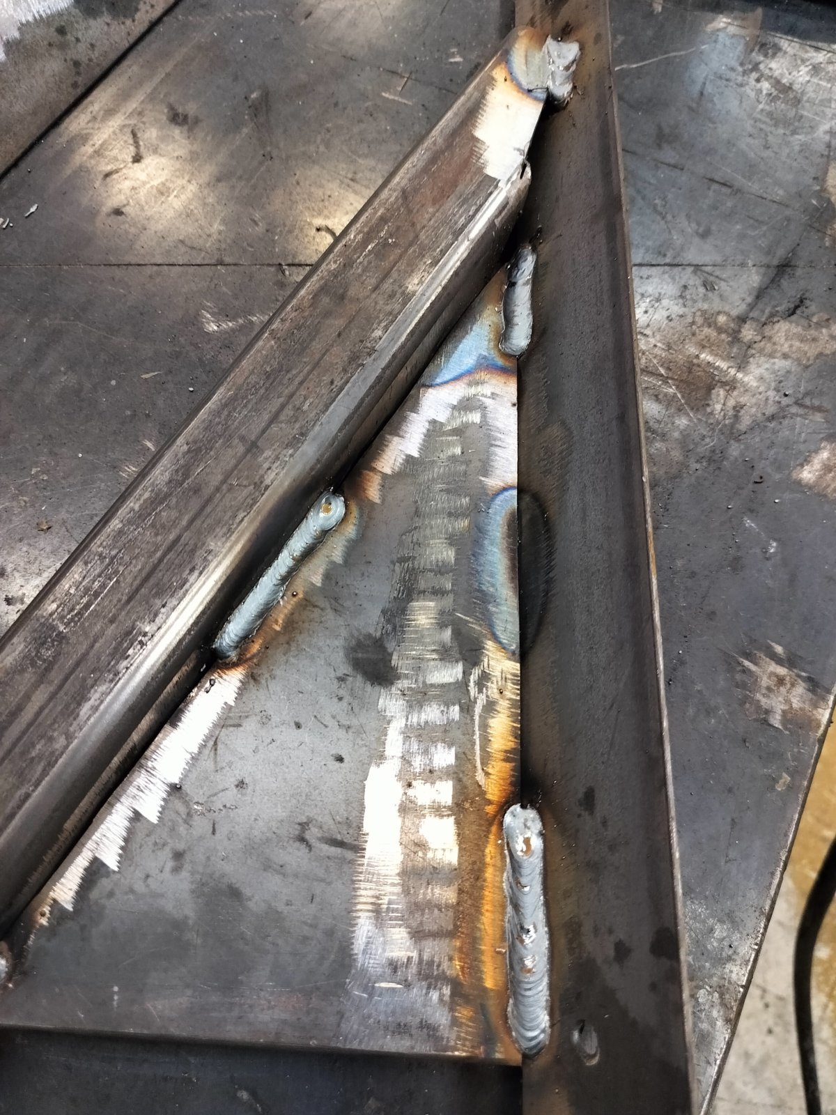

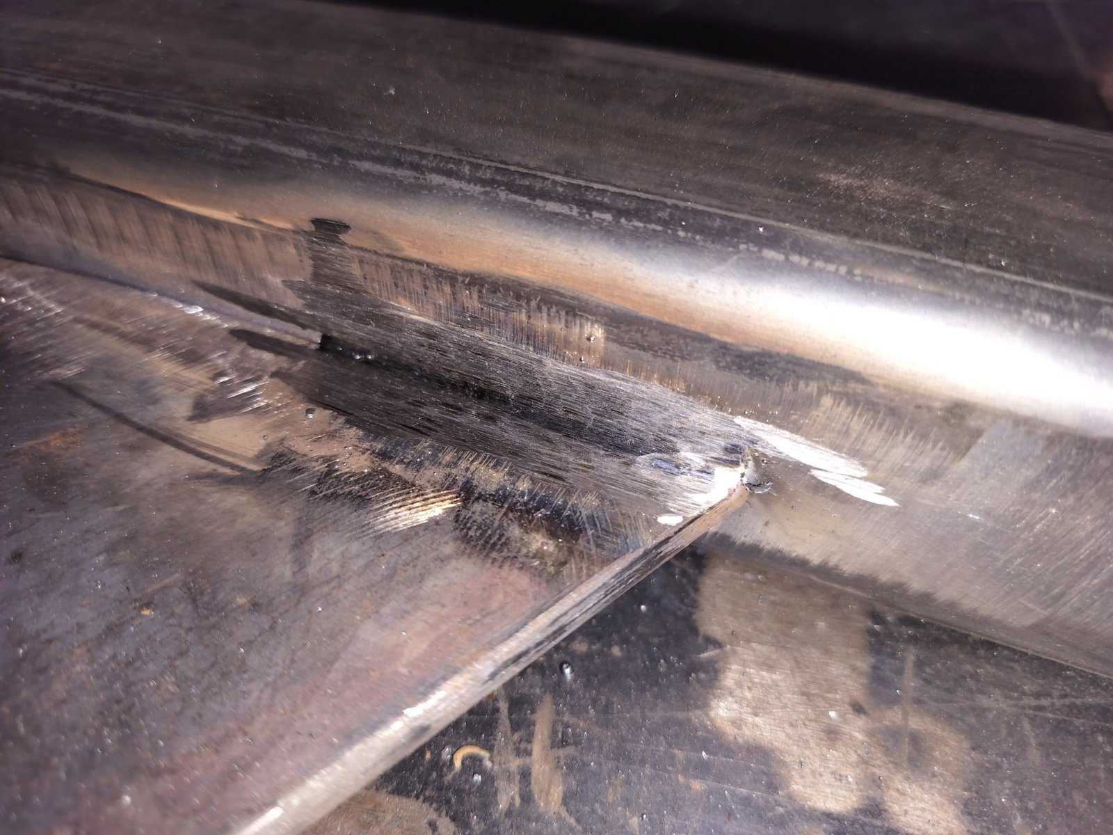

    Not my best work, but they're at least average good to low serious fabricator quality welds.
    That and this Miller Matic MiG unit hasn't been service since they bought it 4 years ago. The filler metal sheath is just fucking filthy. Not excuses, just statements of fact IMG20240503174939.jpg IMG20240503174948.jpg
    Voss, bmf4069, BroHon and 1 other person like this.

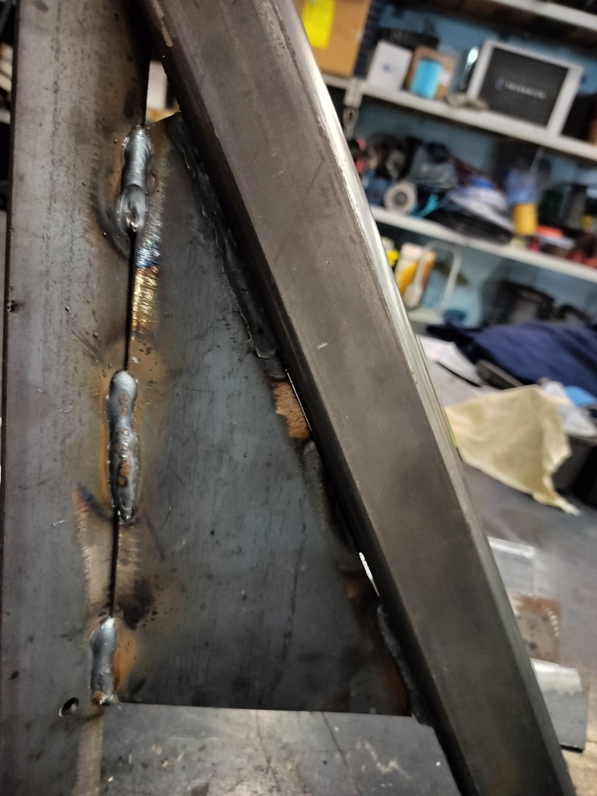

    I cleaned some of the shit out of the machine, and this is what I'm getting now.

    Don’t you dress your welds?

    flux125 from the freight. Dirt cheap and gets it done. Unless you wanna go with gas. But truthfully flux core sticks metal together and is a cheap starting option while till being able to make structurally sound toys
    khooiii[QUOTED] and BroHon like this.

    still some porosity. Kinda odd for MIG
    edit: it actually just looks like porosity where you start/stop. You bringing that back a bit before letting off the tiger?

    If it was critical structural I would immediately. But seeing as this for a pig feeder I'll do it after it's all welded. Just a wire wheel, no chemical dressing.

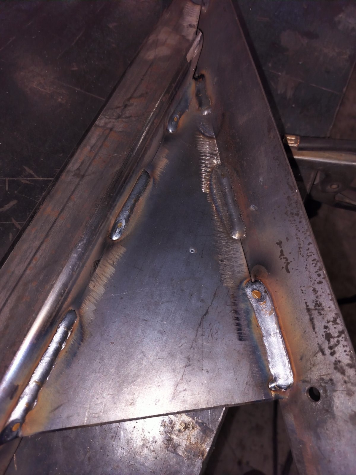

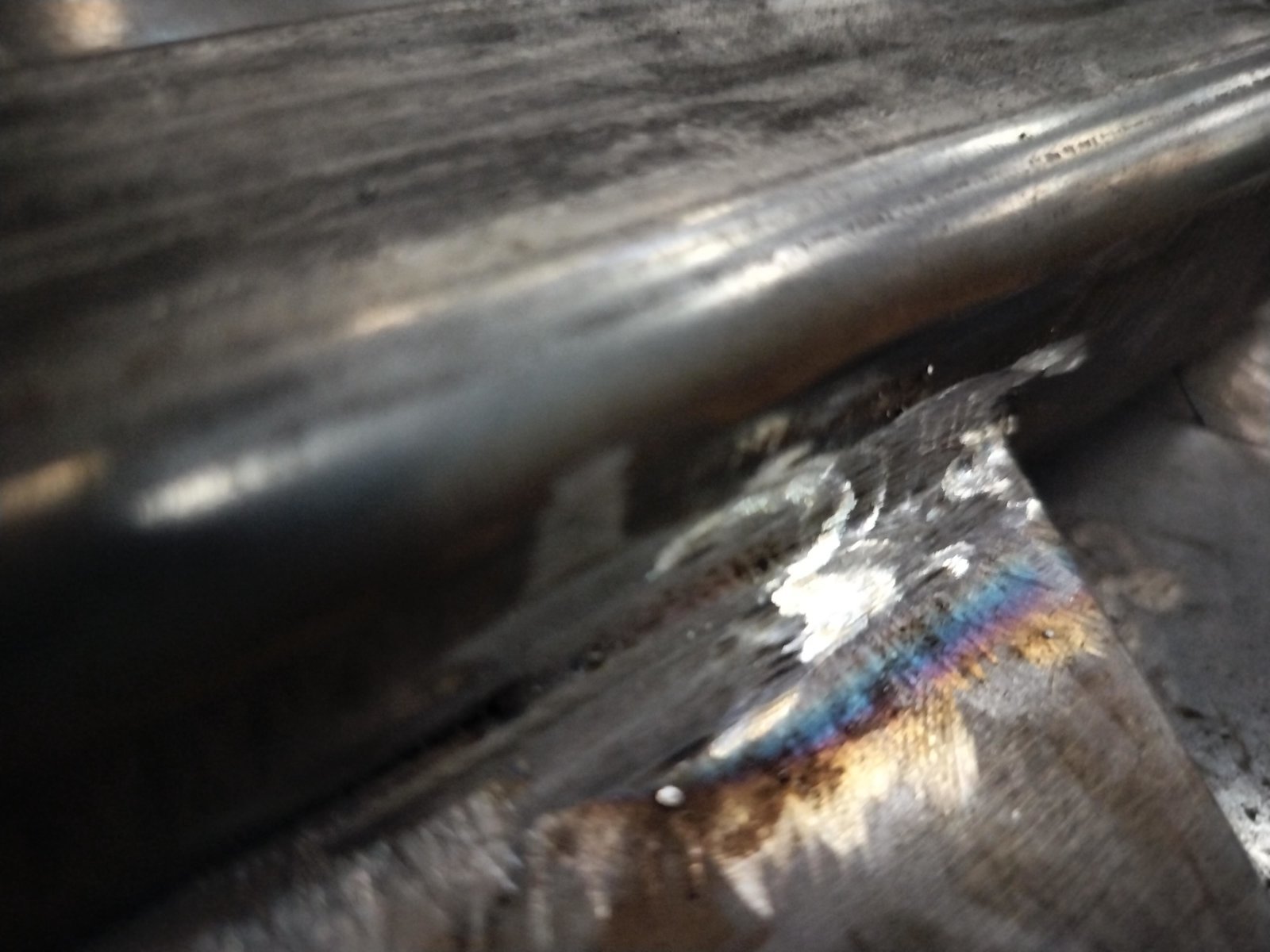

    Whelp after an hour of diagnosing cleaning fixing and replace parts I got the MiG back up and running at work. Had to grind a weld out for the first time since 2015 when I was in advanced weld school for the Navy, 4955 for fucking life. Don't know what the issue was, but it was shorting the wire feed and pulse arcing. It's not supposed to do either of those things.
    Oh and I forgot my cover gas on a test weld. But for no gas that root was fucking mint.IMG20240503184220_BURST006.jpg IMG20240503184236.jpg IMG20240503203134.jpg

    Much better :thumbsup:

    Yeah they're even better now that I fucked with the wire speed. What ever was causing that binding had been there for a minute cause they had it cranked all the way up, and it never seemed as fast I remember. That "good" weld was me trying to keep up with the wire speed after the cleaning. They look as they should now.

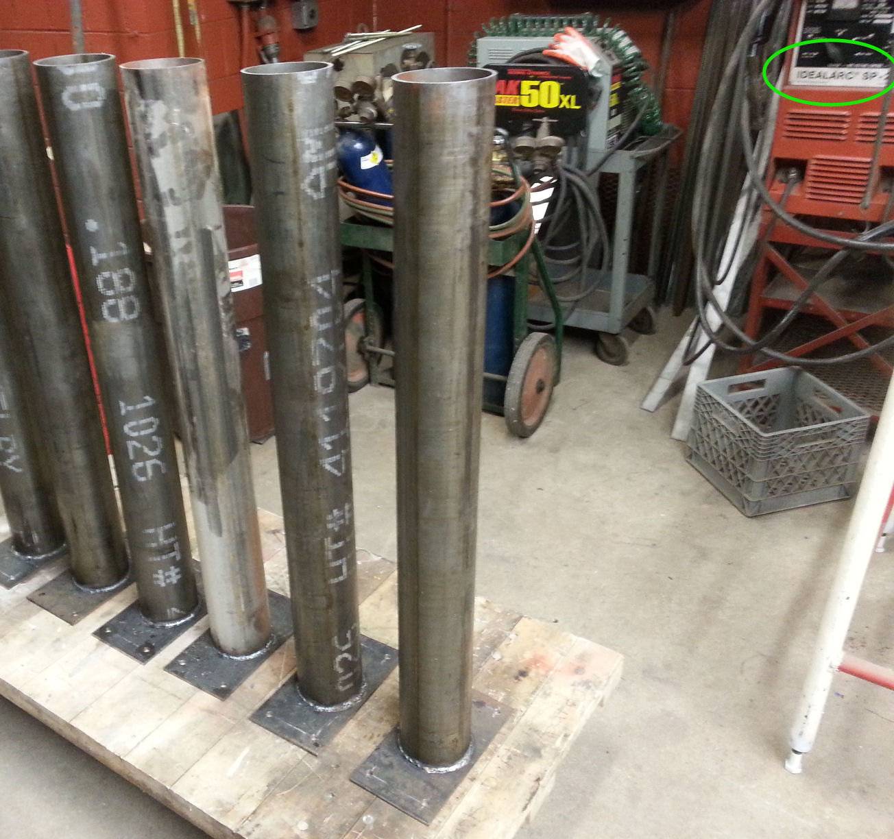

    Iron oxide weight reduction
    Back in 15 I did these for a project, but our welder was old AF and the lead was clapped out so bad it had to be laid out in a gentile loop or the feed was horrible. Armature hour for sure, but I love using the welder.

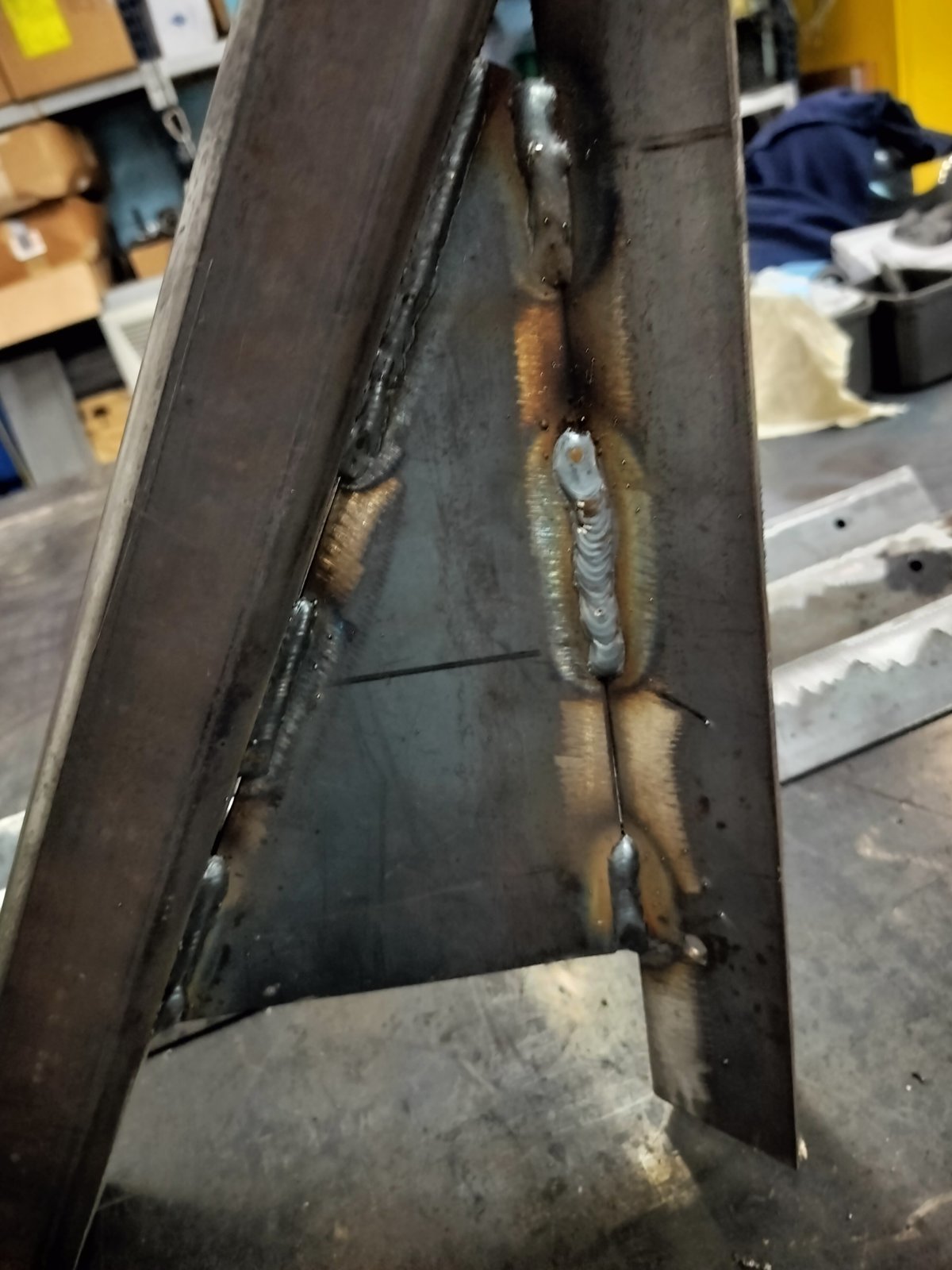

    Fucking dialed

    Looks like the gas feed wasn't good maybe, I have forgotten to turn it on and it's way worse than that spittersputter though.
