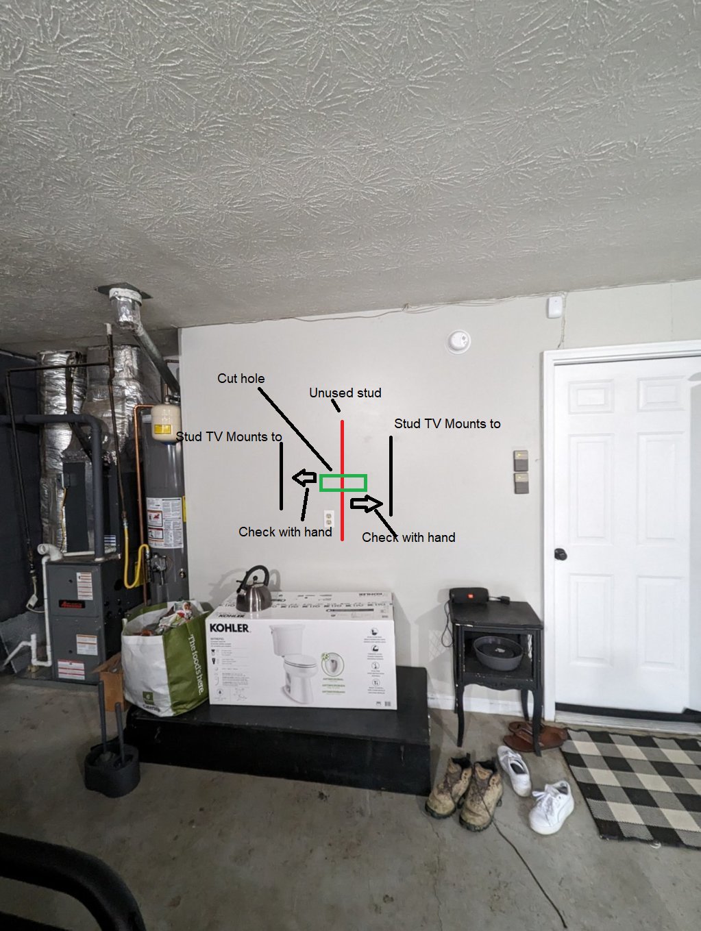

    Come on guys. A $20 stud finder would be a good thing to have in your toolbox anyways. Right tools for the job make life easy.
    also, I vote 2nd wall since it appears to be the front of the garage and would be easily seen when wrenching on any side of a vehicle but the back.

    It's funny to me that your mind went there. That was not even a consideration for me. Are home burglaries common there? Pretty low risk here.

    I have a stud finder. That was not my concern. What about the electrical on that stud. Low risk of hitting it with a screw?

    I like option 2 next to the door (to the house I presume?). That’s where I’d put it.

    For mounting a TV in a garage I’d find the optimum location height and width. Mark the outside of the mounting bracket with pencil. Cut along pencil line with multi tool or drywall knife or box cutter. Remove drywall. Take photo. Add extra blocks as needed or just replace with 5/8 plywood. Yes it’s more combustible but f it. Peace of mind and no risk.

    I'd cut a small hole that's big enough to fit your arm behind where you want to mount the TV, and just locate any hazards, then patch the hole.

    General idea, not sure how your specific TV mount would work. The wiring for that outlet probably runs along the side of that stud to the ceiling.

    Wait, is that black platform a tank for the toilet? Is the idea to have a toilet facing the TV? Killer plan!

    I'd say on the block wall. I think you'll get less sun glare than you might on the drywall wall.

    Also, easy bulletproof install. Masonry bit, couple holes, and tapcons ... that shit is going NOWHERE.

    I was thinking the same thing. I like both locations but the tv would blend into the dark walls better when not in use.

    If there's any power feeding a light in the ceiling, you may be able to easily drop a conduit from the ceiling (or flex/bx) down the wall, you'll only need to drill for a conduit hanger/standoff every 36", which means maybe two for stability? Drop a quad-box on the wall for good measure, behind where the TV will mount.
