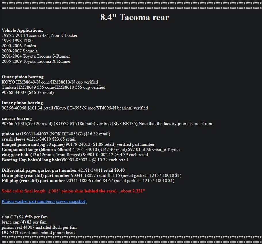

    I'm trying to figure out which rear diff rebuild kit to order for when I get my 4.10 gears and TrueTrac installed. I guess I should ask the guy who's going to install em. But i never think about it til the worst times haha

    Ask your guy first on what they want. Don't go around spending a bunch of money beforehand.
    If you want for sure OEM parts, buy a mini install kit from ECGS for just the shims/ pinion nut, and crush collar; then source your own seals and bearings. Optionally buy a solid spacer from ECGS to replace the crush collar. https://eastcoastgearsupply.com/i-126923-toyota-tacoma-t100rear-install-kit-mini.html
    Then reference Zuk's website for all the seal and bearing information to get OEM. http://gearinstalls.com/bearing.htm

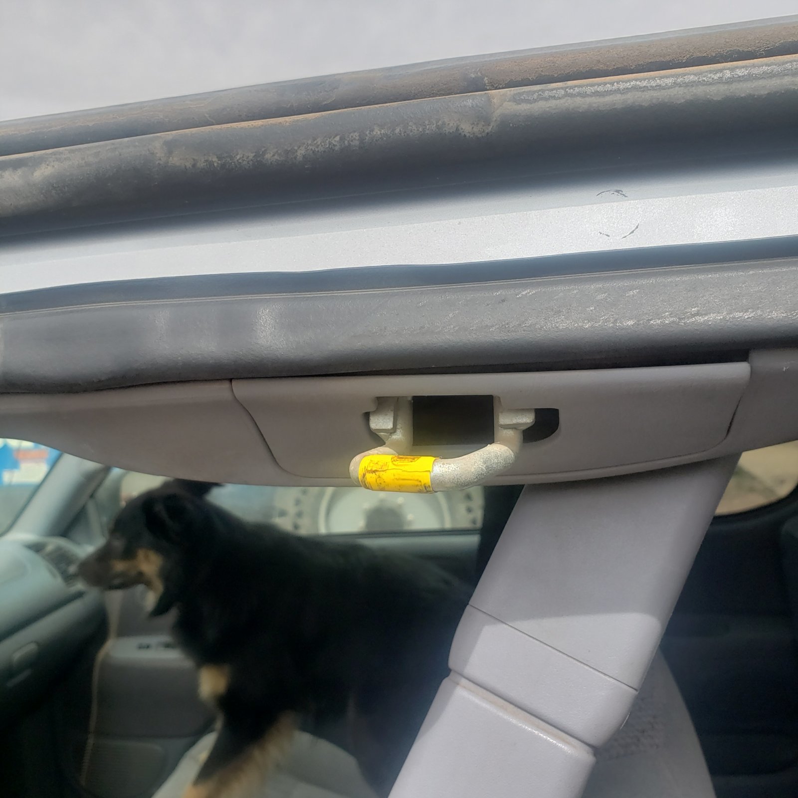

    So I been dealing with this on my driver side for a while myself. I recently found a solution on the FB group. Wrap some electric tape around the outter most portion of the striker, two or three times. Simple as that. I did it a few days ago and have been enjoying normal door functions since.

    Oh so it’s friction on the striker? Could I just replace the striker then?

    Maybe. I don't know why it works haha

    Man, @455h0le_dachshund for the win!
    All four doors on my truck have a heinous rattle. I planned on finding solution when I got into doing bodywork and welding in some door check doubler plates. 60 seconds per side and I can actually hear myself think now!
    Yellow because it's my favorite flavor, and the only thing I have in stock at the moment.
    I did all thee on each side. 2 per Access door and one for each front door.
    @Mr.bee may be onto a more permanent solution with tweaking the hoop for better engagement.
    The door checks on both of my front doors are blown out and probably have contributed to some less than stellar hinge alignment.

    If it's a friction issue, simply applying dry lube - which I assume you have a ton of (cyclist and all) - or any graphite based treatment would accomplish the same goal.
    I'd speculae it's more of a padding thing. I can't remember if our trucks came from the factory with plastic covering that spot. I'm cure someone could 3d-print a plastic c-shaped tube clip to go over the bar, though.
